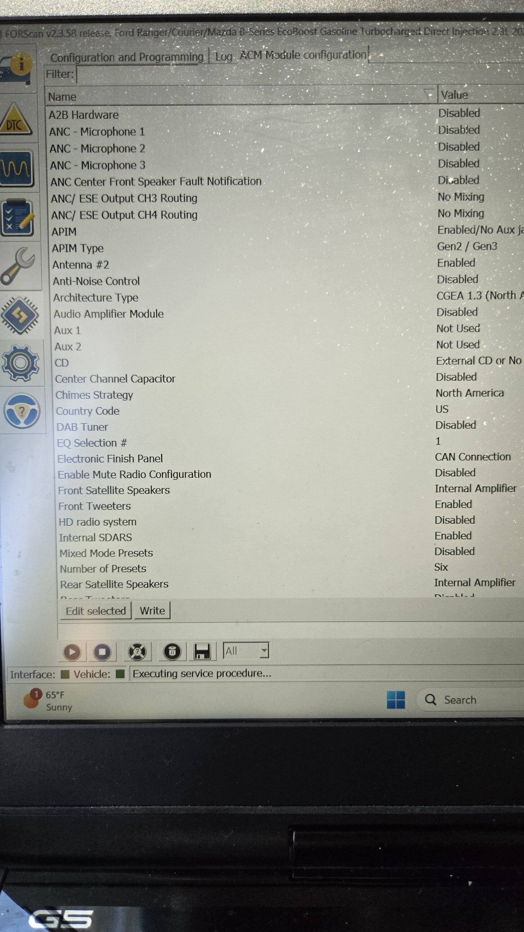

I put new infinity Kappa components in. Non B and O system. XLT Sound is lacking bass even compared to the oem speakers. It's a very noticeable decrease.
I have forscan and read I should be disabling DSP. We'll I do not see it? It appears to be not an option under ACM.
Can someone help me out.

I don't have my spreadsheet with me. But ford programs in massive bass rolloff above 15 on the volume level. You have to go to the acm hex side and change 1 line. Go to 727-01-02 01xxxx change it to 727-01-02 00xxxx ignore the values where i put x's change only that 1 digit it will remove the bass rolloff. I went to my spreadsheet.

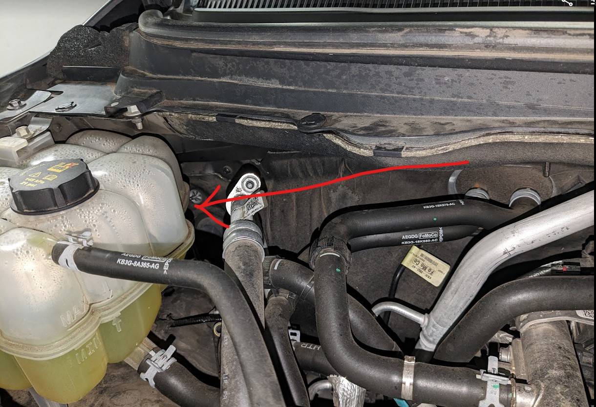

I have ran lighting wires through the firewall and can help you locate a good path if needed.
Where did you go through firewall? Behind and below steering column? Did you go cab to the engine or engine to cab? I have a feeding tube/needle I have used on other vehicles.

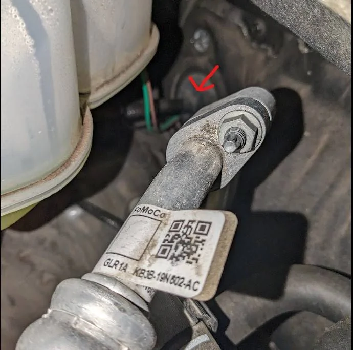

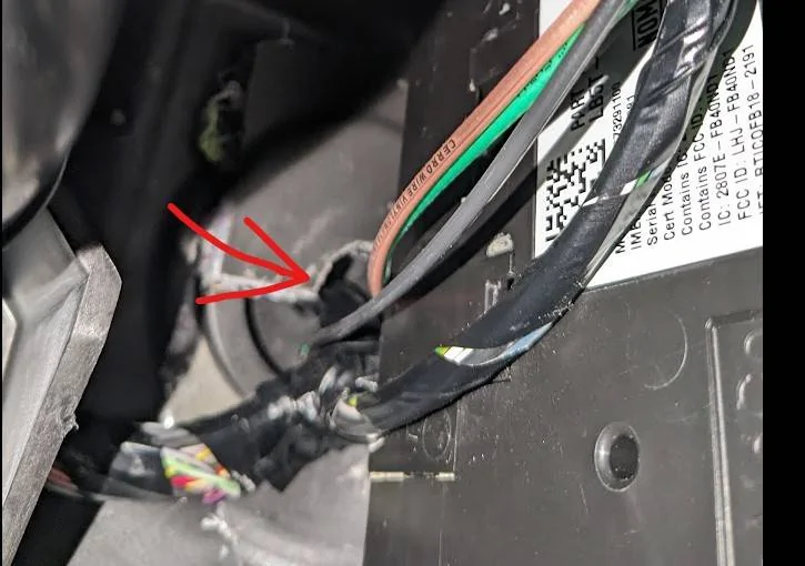

I found the passenger side rubber grommet to be easier to run wires though. It is just behind the coolant reservoir, and comes out behind the glove box, towards the door. See my pictures below.
I ran three wires for my light bar. They are black, green and brown. You can see them in my pictures.
Also, there is a little nipple on the grommet you can pull off to expose an existing extra hole in the grommet. It was one of Ford's engineering items that did impress me.
