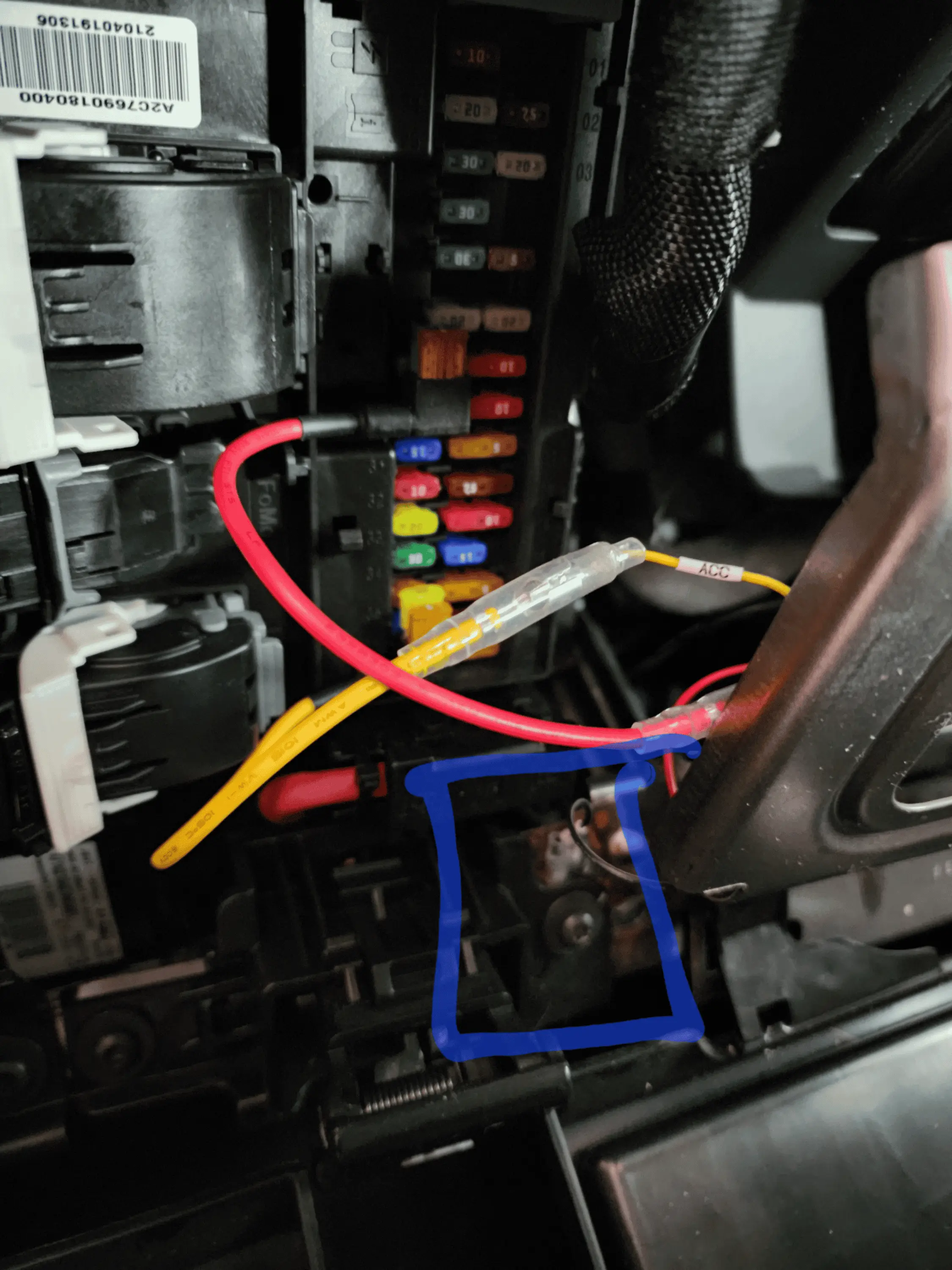

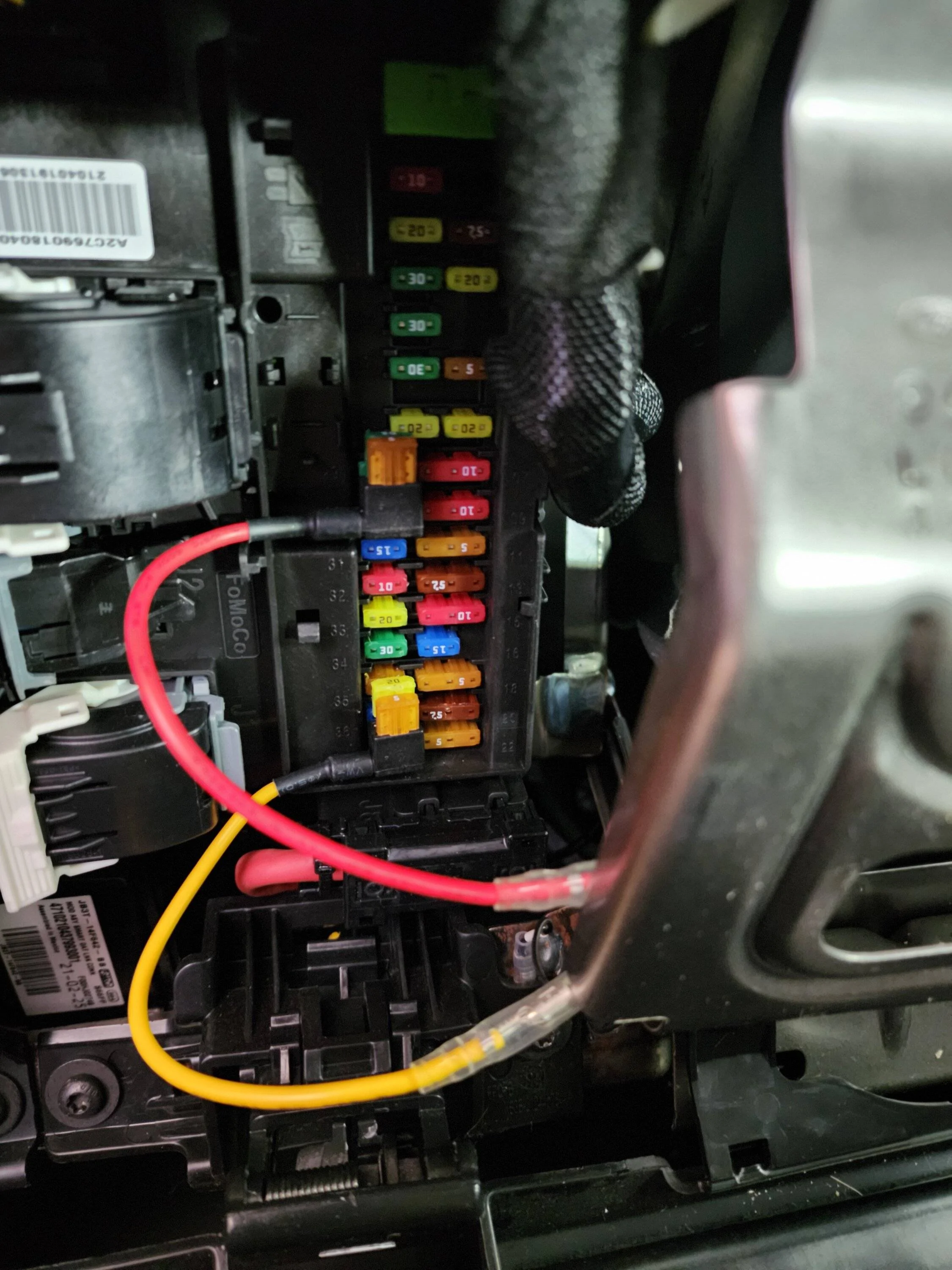

I am installing my Rove R3 today. I was having trouble with Remington the A pillar moulding so I discovered an easier route. I pulled up the left defroster vend and found I can drop the power and rear camera cables straight down thru the dash without a hiccup. Still pushing wires out of the way but thought I would post this .
P.S. can anyone tell me which fusesto use for ignition and accessory? I am getting too tired to figure this out.

It actually drips down under the dash and makes it faster and easier to connect to the fuse box. It also makes it one less trim panel to remove in order to run the rear camera cable. And since I have a cap installed I also found and easy way to exit the cab and run the cable along the frame and then into the side of the bed without having to drill any holes by using the existing ones. I found a floor plug in the jack storage bin. I have a super cab so I do not know if the super crew has the same set up for jack storage.
