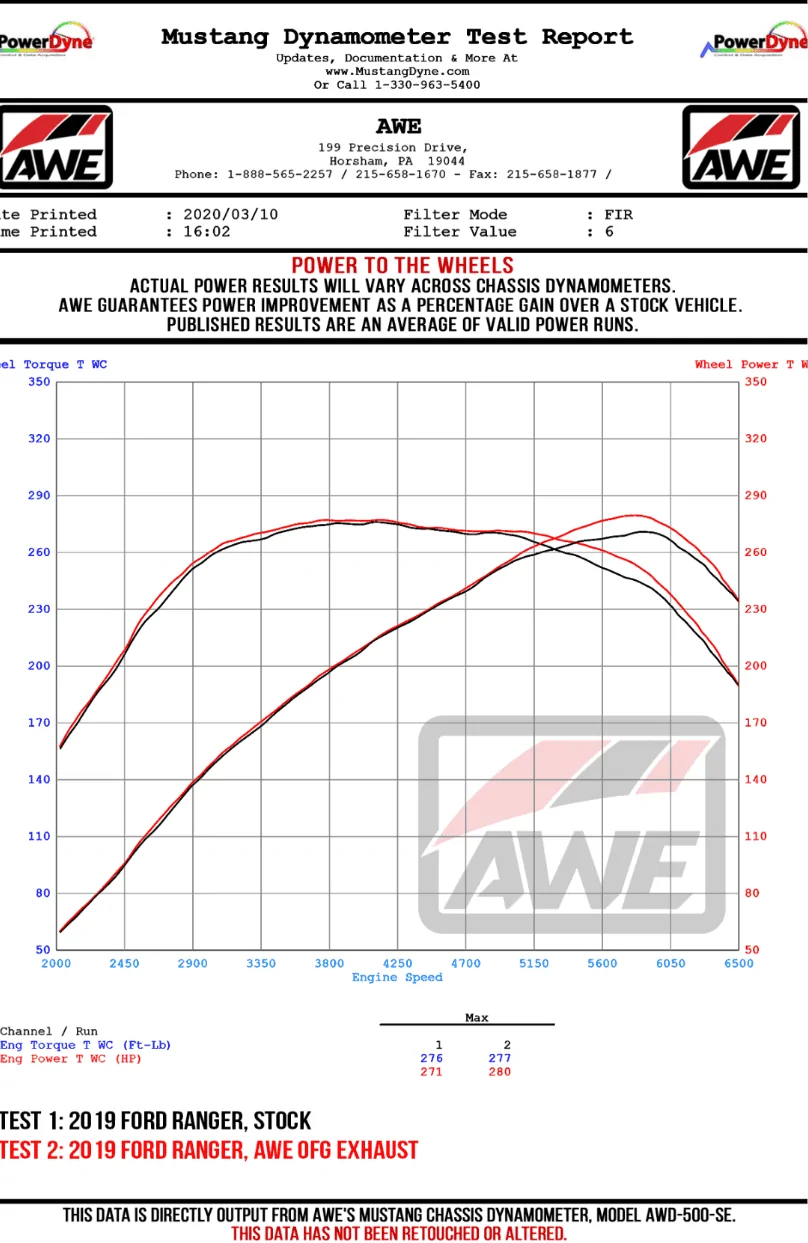

And as far as your AWE dyno chart, was there tuning involved? Were ambient conditions and fuel the same? Any "supporting mods" like an intake? There are so many questions that it's hardly trustworthy. Let alone the fact that it's not really an independent source.
As far as your EPA comment, that's neither here nor there. Your factory downpipe is much more restrictive than your factory catback.
It's been well proven for decades now that a cat back alone on a modern forced induction motor offers no real performance gains. Independent testing has proven this time and time again.

That's not much of a gain on that dyno chart, how often are you going to rev it that hard.
My 3.2 diesel is red-lined by Ford on the tacho at just over 5,000 RPM, pretty high for a diesel, no way am I going to rev it that hard, it already sounds ready to self destruct by 4,000 and there's no real point, as you've already passed peak power and torque. All you get is a bit more go and a lot more noise and smoke.

Again, its mainly noise that changes. Power gains are usually small from a catback
