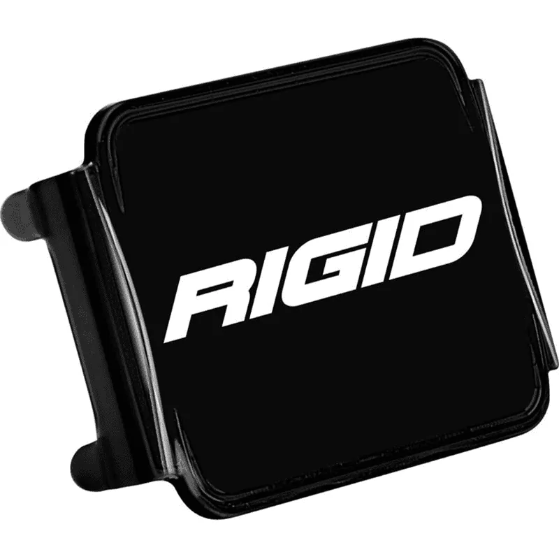

ive heard of folks just covering the extra lights to pass inspections. then when you need the lights for off road bad weather etc. just take the covers off. ive seen the covers for KC Rigid and Baja i would guess you could get a cover for what ever lights you use. Maybe that would satisfy the PA laws and save you having to re wire stuff.

yes they also have to be covered on the road also... beside the relay ....
