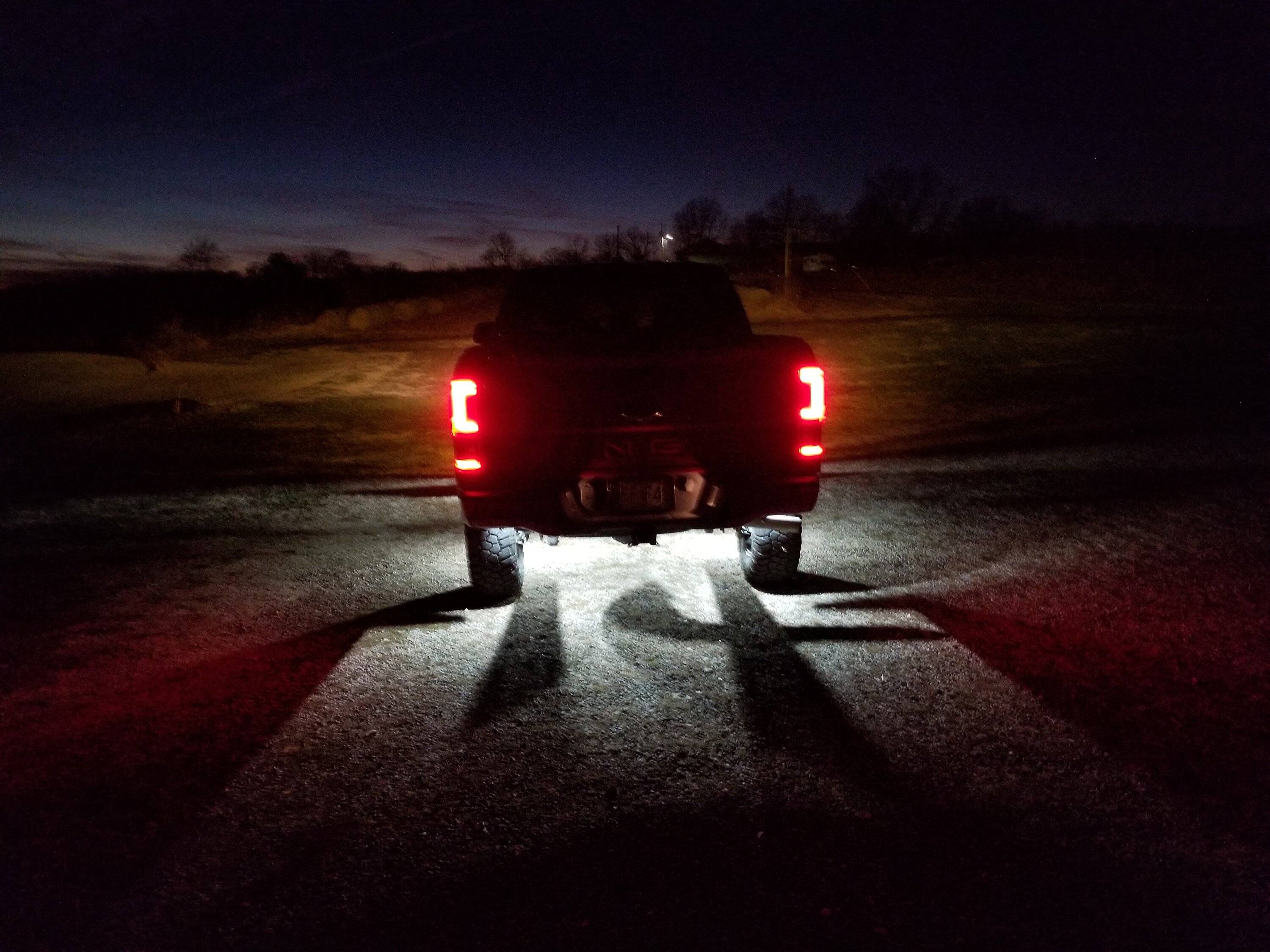

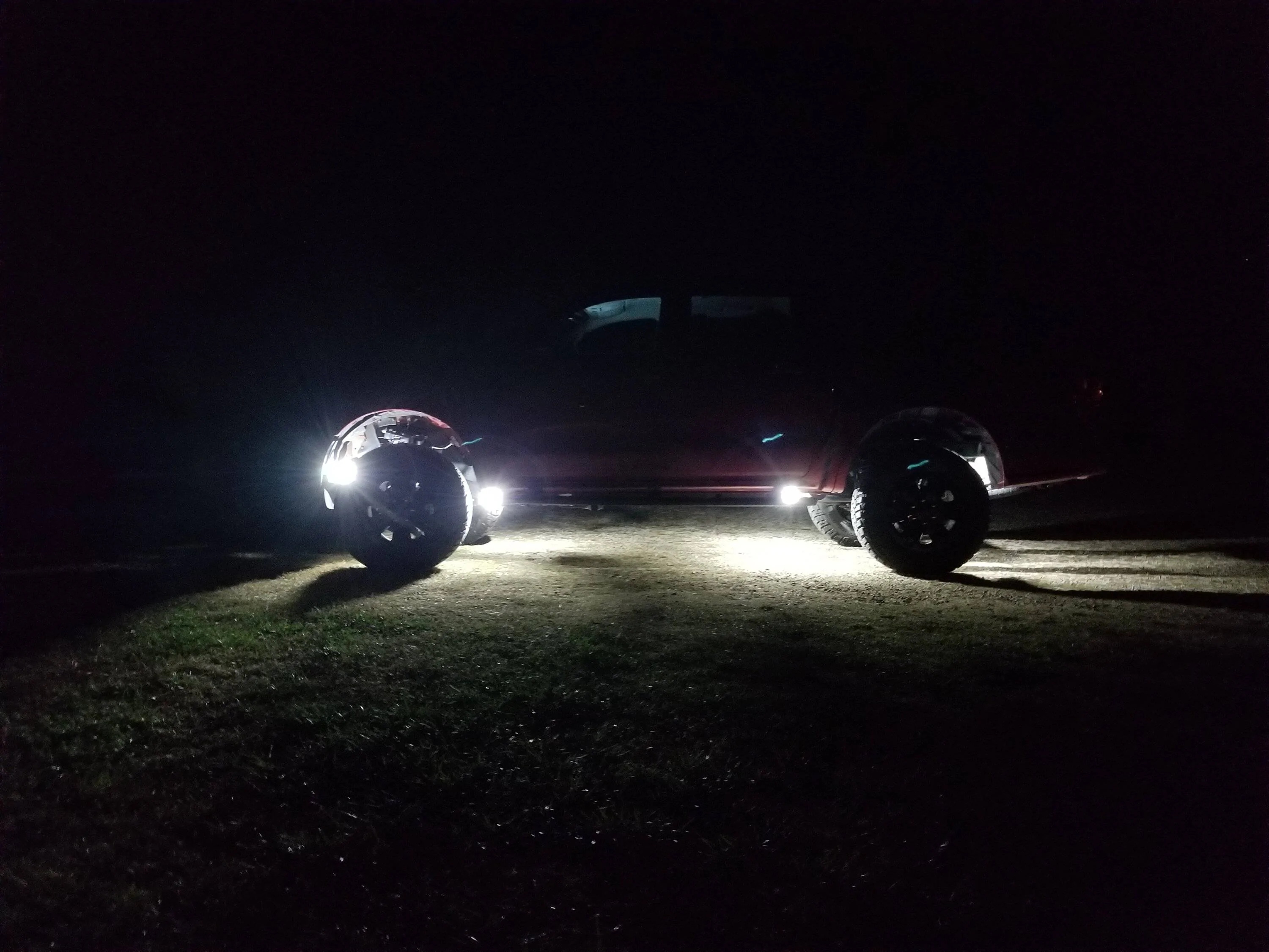

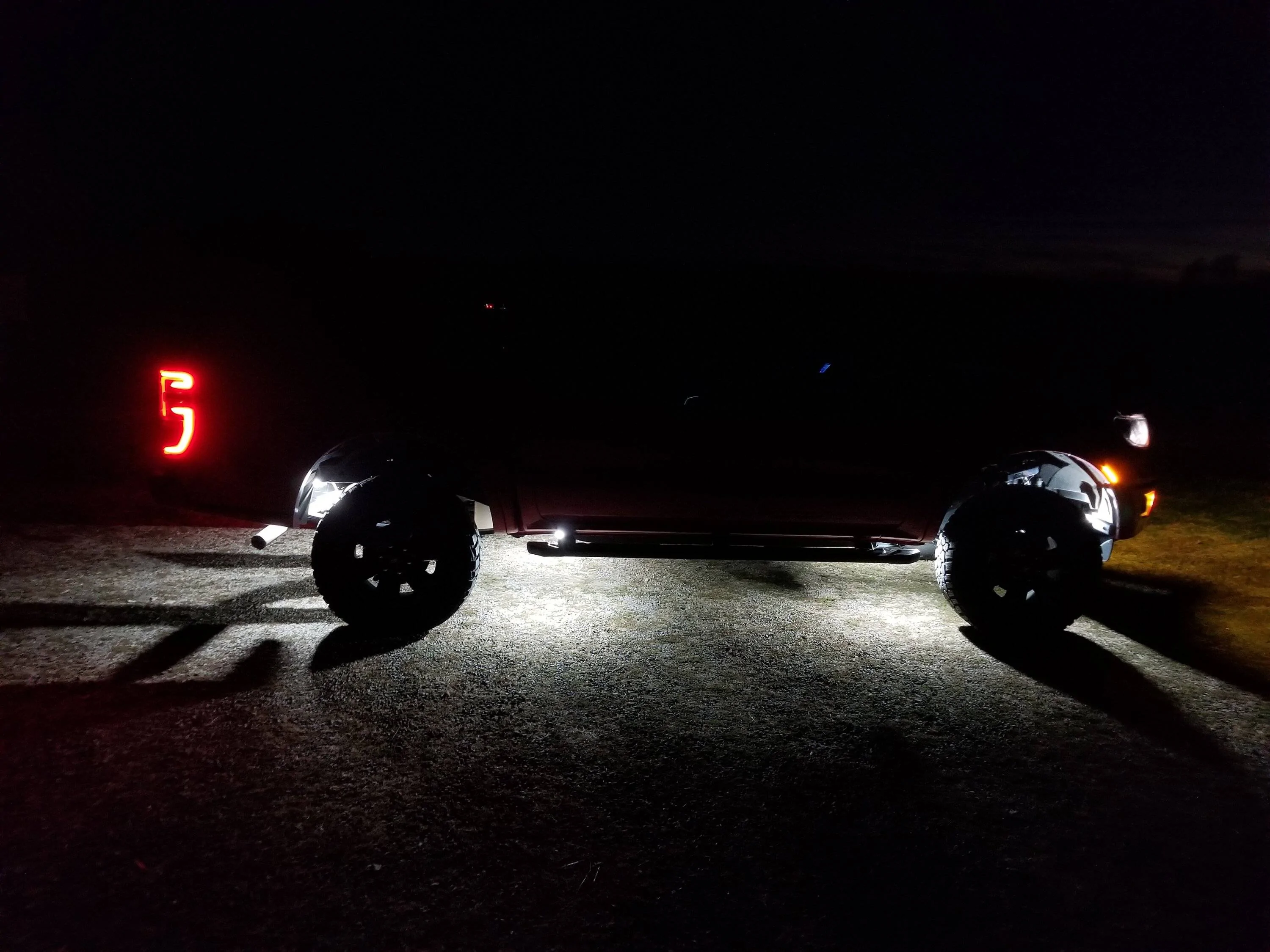

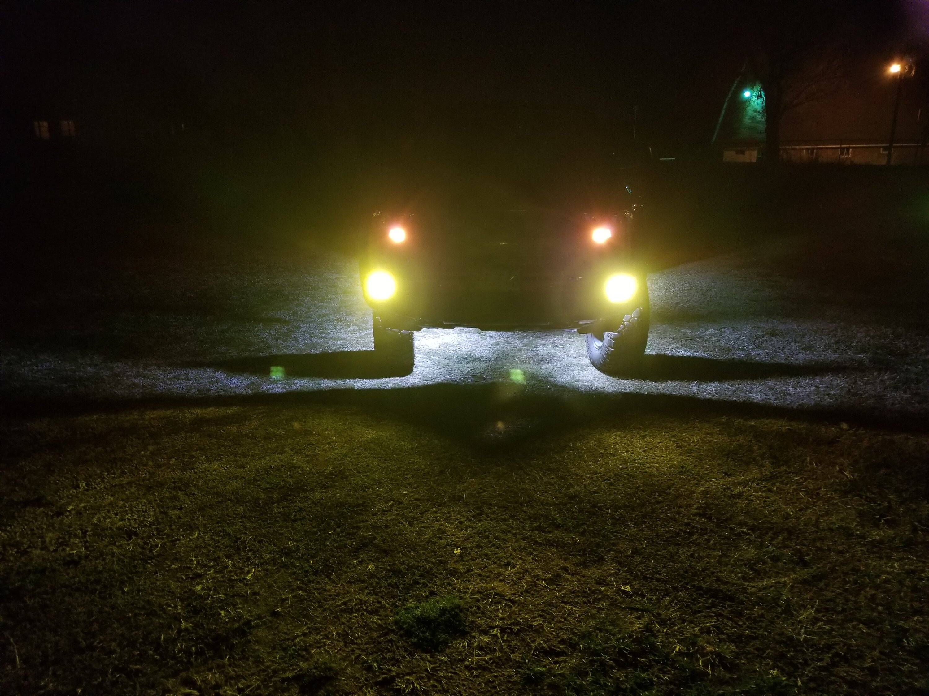

I am also running the Lux kit. Worth noting - I had to replace every light 2 years later. All the magnets failed and 5 of the 8 lights stopped working. It was covered under their 3 year warranty. See in the pics, the placement of these lights is of no use when replacing a tire.
I also started with planning for lighting/accessory wants and made a harness for that. That’s what is laying on the ground in the one pic. Separate leads (power and ground) for each circuit, pigtails for individual components. I pulled this through the frame rail on the passenger side. This protects it from the heat of the exhaust. That was easy to do until you get to the rear, a little tricky but doable. On the drivers side, I zip-tied it to the factory harness run along the top of the frame rail.
