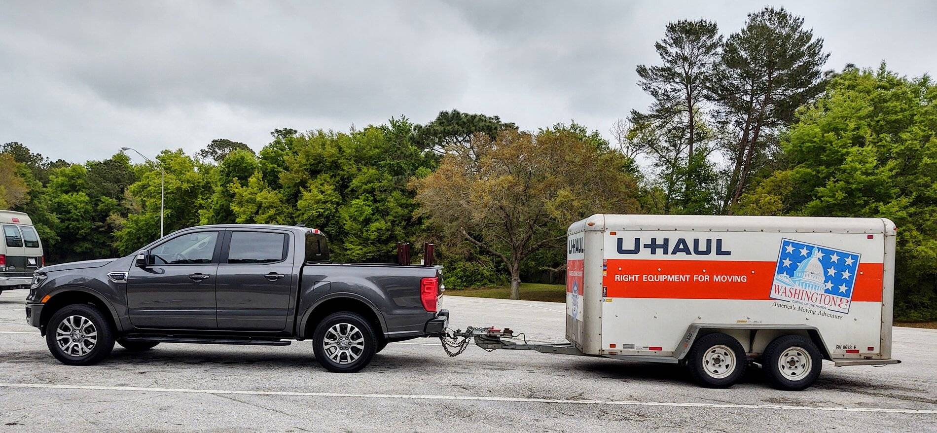

Is there not a knock out cap in center of the rear bumper for a hitch ball ? There should also be slotted tabs for the safety chains underneath. It is there on my Lariat even though I have the trailer package
As far as I know, the tow rating on the bumper is only 3,500 lbs. You can install a Class III hitch for up to 7,500 lbs. towing. I don't think I'd be comfortable putting a 6 x 12 loaded with all your stuff on the bumper. But would have no problem on a 2" receiver.
I'm actually in the process of adding a hitch to mine and found a Class III Draw-Tite hitch on Amazon for $125. https://www.amazon.com/gp/product/B07WSYKMPJ/ref=ppx_yo_dt_b_asin_title_o04_s01?ie=UTF8&psc=1
I haven't decided whether or not to do the brake controller on mine. It already has the 4-pin connector and a 7-way seems unnecessary for the things I plan to tow. (motorcycle trailer, small enclosed trailer) I figure I can worry about that when I need to.

I towed using that same exactly u-haul (6x12) about a month ago with 0 issues. Couldn't tell it was there. I will say, it was not loaded to the max (we just lazily stuffed it and made 3 trips) and only went about 50 miles total. But I was surprised at how effortless it was to pull and slow down. Keep in mind that what most people don't understand is that when it comes to towing vehicles are rated at their ability to stop a trailer not pull it. I'm sure a Honda civic could move a 10,000 boat from point A to B but that boat is going to push the Honda right through the first red light lol. In the trailer keep most of your weight to the front and over the axles.
