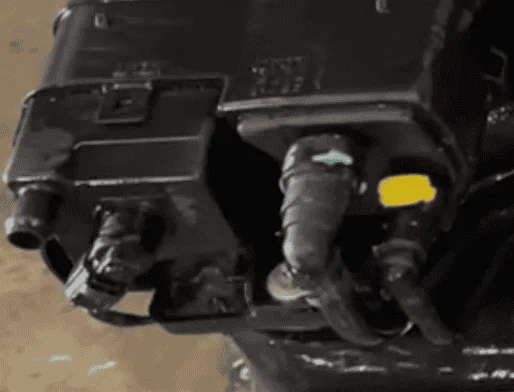

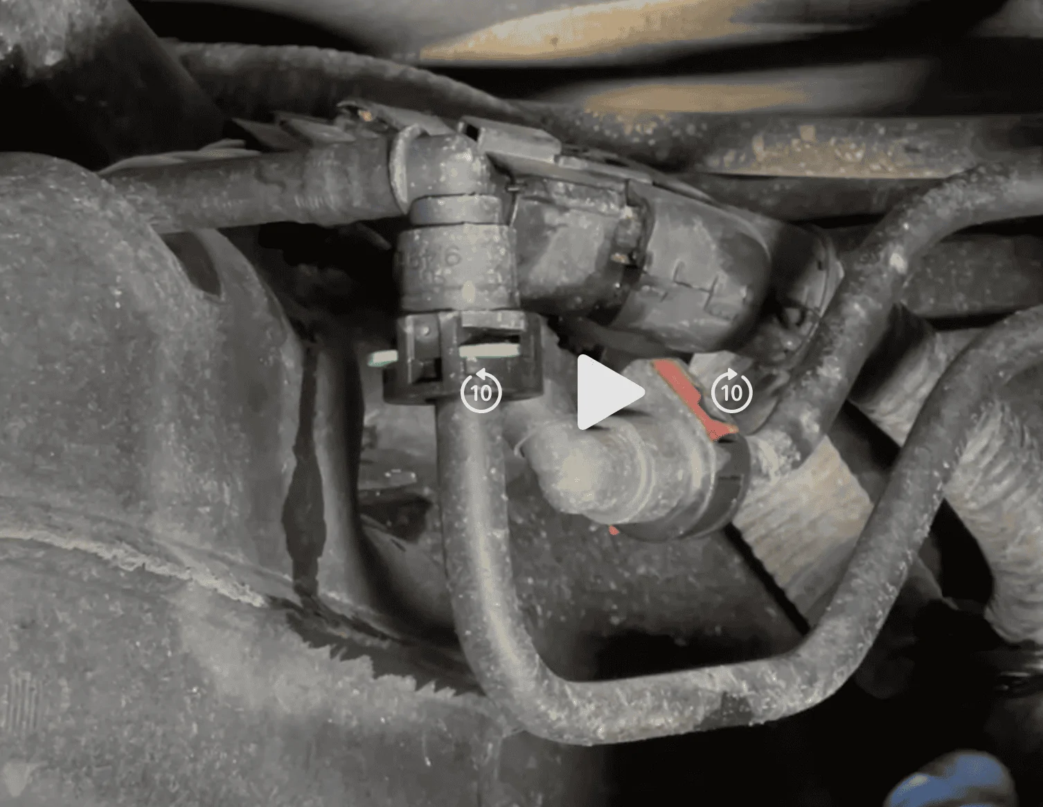

Long story short. I installed a long range tank on my 22 ranger tremor and now I'm getting a P04VFO Evap system error. Through trial by fire I am wanting to replace the quick disconnect fittings (pics attached) and cannot find a part number anywhere.
1) Pic 2 are the fuel lines from the tank to the engine
2) Pic 21is the yellow clipped to the charcoal canister.
Anyone have an Idea on the the part # for these? I tried looking in the ford tech manual but the relevant fuel lines folder is corrupted.
Thanks for your help!

As far as the connections, Ford does not have the connectors separately, they come with the tube itself, I believe.
You may be able to find one in the (HELP) section at auto parts store, but you risk cracking the hard plastic tube, generally they are not replicable as they are heat crimped to the tube to seal it.

Thanks for all the advice folks! I’m gonna get her smoke tested to make sure there aren’t any leaks then replace the purge valve if that doesn’t fix it. I find it a bit odd that the purge valve would fail very soon after putting the long range tank in but I have no idea how this crap works! Instructions on install were terrible indeed and me being a Neanderthal cracked a couple clips on the quick connects on removing. I had to modify some Napa generic ones which seared them but should probably replace them with the correct part indeed.
I figured does only sells assemblies now so will likely have to buy the hoses with fittings and then remove as I did per the long range America tank instructions (cut along the ridges of the hard tubing and reuse the connectors with the high pressure lines provided with the tank).
