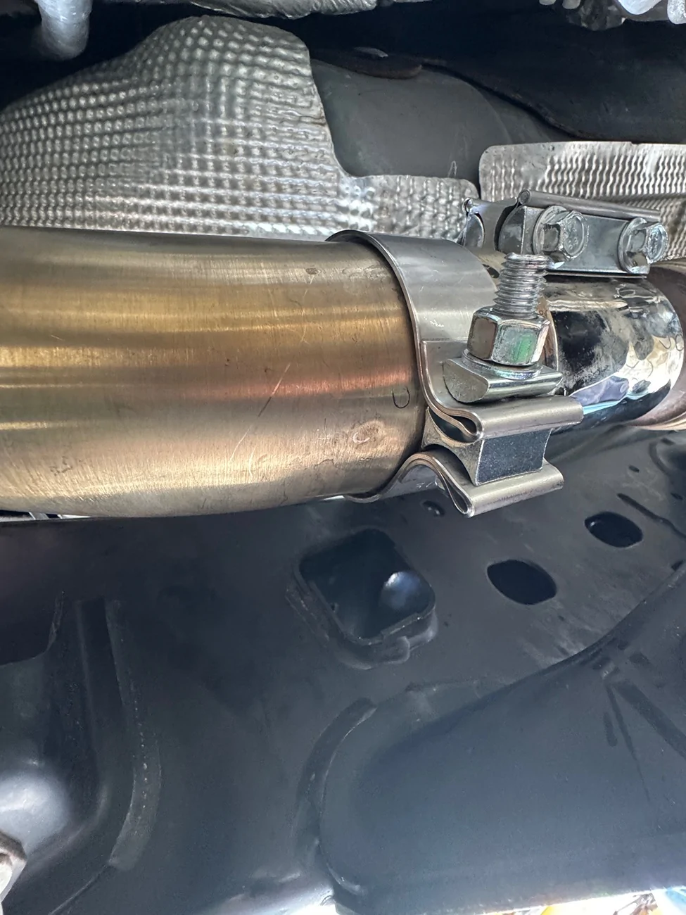

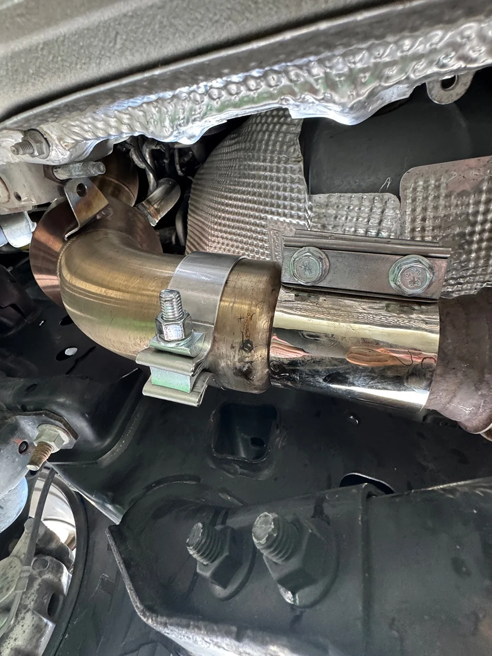

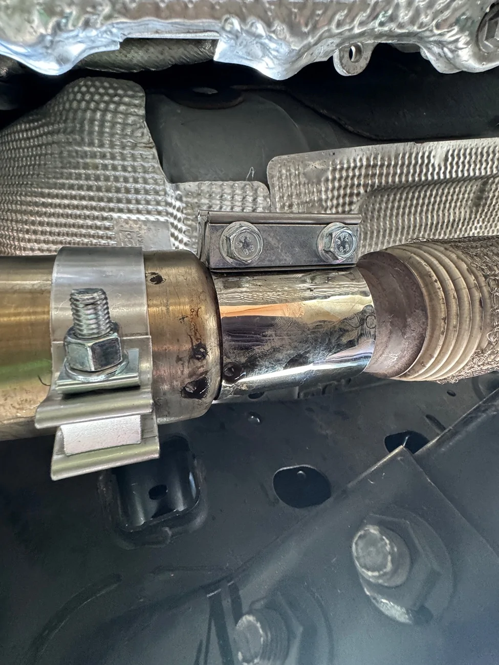

I recently installed CVF’s catted DP on my 21’ Ranger. The clamps they gave me to secure the both sides of the adapter pipe which is slotted on 3 sides. I do not have a 1/2” impact so I had to use ratchet to tighten the clamps. I also broke out the breaker bar to get them tighter but I’m still getting a leak from the outlet side of DP to the adapter pipe. Is there a trick to getting these slotted pipes to seal? What am I doing wrong? Any help would be much appreciated!
On the mid pipe side, CVF sent me two of the same size clamps so I assumed they messed up. I bought this other type of clamp at AutoZone. Not 100% sure if it’s sealed completely either 🤦‍♂️

Put 1 layer of exhaust wrap and put the clamp back on..
