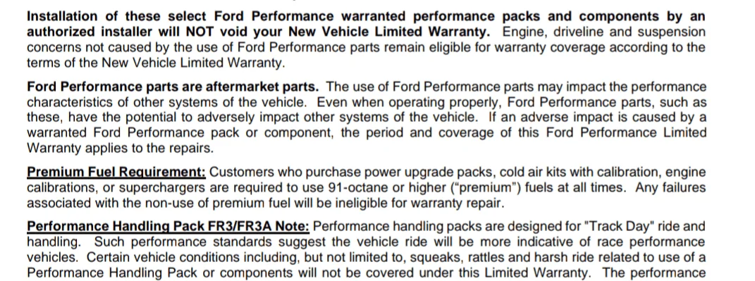

#1 Wrong - After the FP warranty is up your power train warranty stays in effect. If the cause of a power train failure can be attributed to the tune Ford could deny the claim. But in the last 8 years of owning 2.3 Ecoboost powered vehicles and participating on the platform forums I have never heard of someone with the FP tune have a claim denied. You need to read the warranty document FP published.
#2 Partially Correct - Yes the FP supplemental warranty is based of the original sale date of the car BUT, your power train warranty still stays in effect, see #1
#3 Wrong - the factory tune is backed up on the ProCal 4 handheld device, you can reinstall the stock tune at anytime. When 93 Octane was approaching $5.00/gal I reinstalled the stock tune. When you select TUNE with the ProCal after it was tuned the first time you are presented with a choice of installing the Performance tune or the Stock tune.
#4 True - The need to run premium was the reason I reinstalled the stock tune. Later went to an Unleashed 87 octane performance tune to get the improved shifting Unleashed offers.

It's ok to think you are right when you are wrong about the warranty. Read the paperwork from Ford Performance and understood it well. That is why it is stated as such above.
As for the tune switching this is the first I have heard of it. Before others have stated they could not find the stock tune
You really should read the warranty document. The first paragraph clearly states that your new car warranty is not voided. It states that anything not caused by the tune are still covered. AND, as I stated earlier in the past 8 years of 2.3 Ecoboost ownership I have not heard of anyone having had a warranty claim denied because of the FP tune.
Well, it does say it won't VOID your new vehicle warranty, but it doesn't say it will or won't shorten it. Then again, the last sentence in the first paragraph DOES say engine and driveline warranty will remain eligible according to terms of the new vehicle warranty. And no, I'm not trying to argue with anyone, I'm just trying to get a full understanding of this because I'm in the market for a tune and so far have been leaning heavily toward a reputable tuner. But, if I can KEEP my powertrain warranty to my 5yr 60K, that would be a major plus. I'm not doing any performance mods besides a tune anyway.
