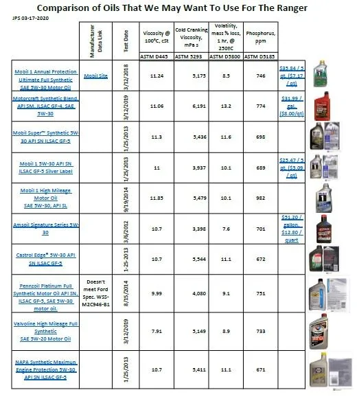

Watch this video, its long but worth it. It helped me decide on my oil.
