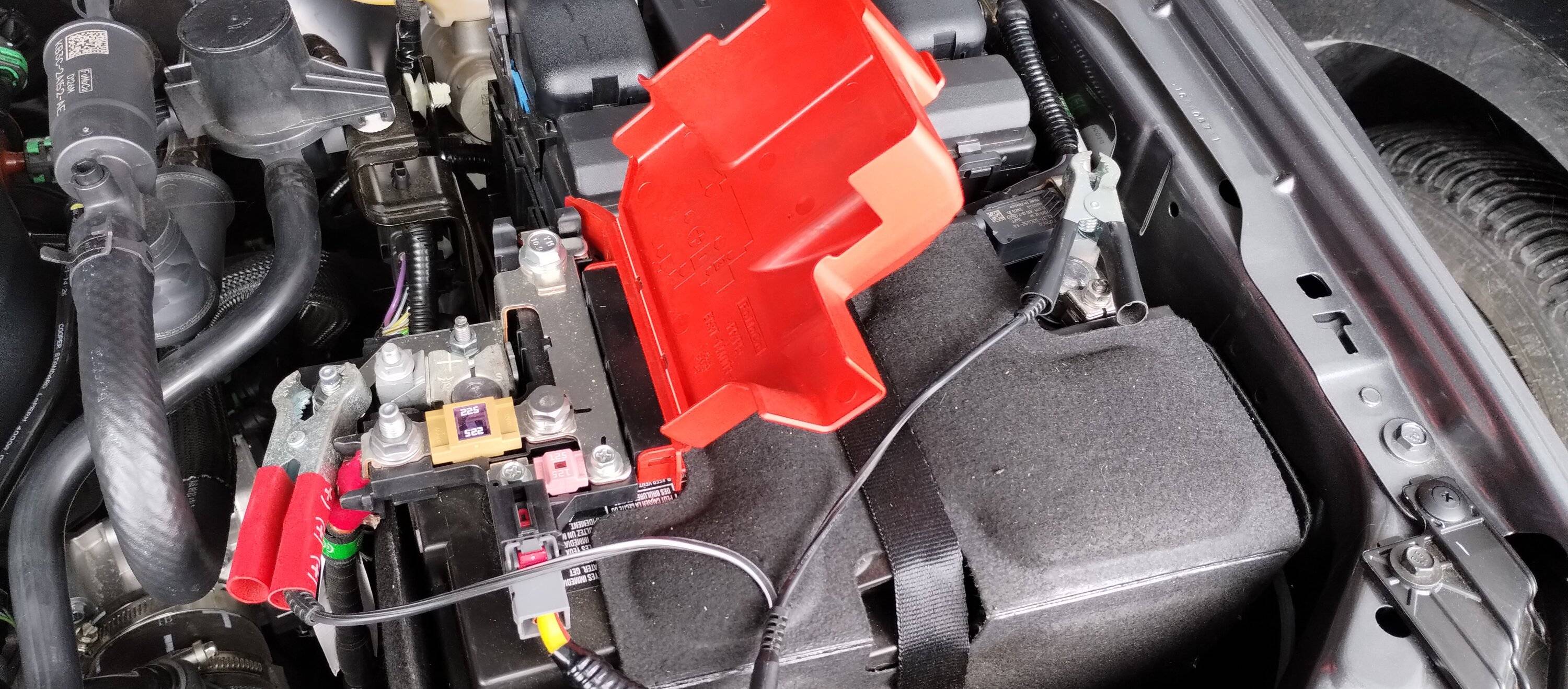

I wonder why mine doesn't hibernate while on my tender. It's been well over 60 days now and it's still awake. I only started plugging it in after seeing notices after just a few days. I figured my battery may have been getting low.
Where is your tender's Neg wire connected, top of BMS, bypass BMS, or frame ground, just curious.
Not the frame. I don't remember off the top of my head, but not directly to the battery terminal. I followed a link posted in a battery thread here, that showed how the system worked and where to connect a battery charger. I connected the tender the same way.
Mike try connecting it here and see if that works.
You think I have it connected wrong, because it doesn't hibernate? I read that the way I was connecting it, the system didn't know I was actually charging it.
I'll go look at how I have it connected later today.
It's possible Mike. This is the way the instructions on my maintainer specified on how to ground it and mine will hibernate. Give it a try and see if it helps. Fyi there's very little room to get the nut off so be careful you don't drop it.

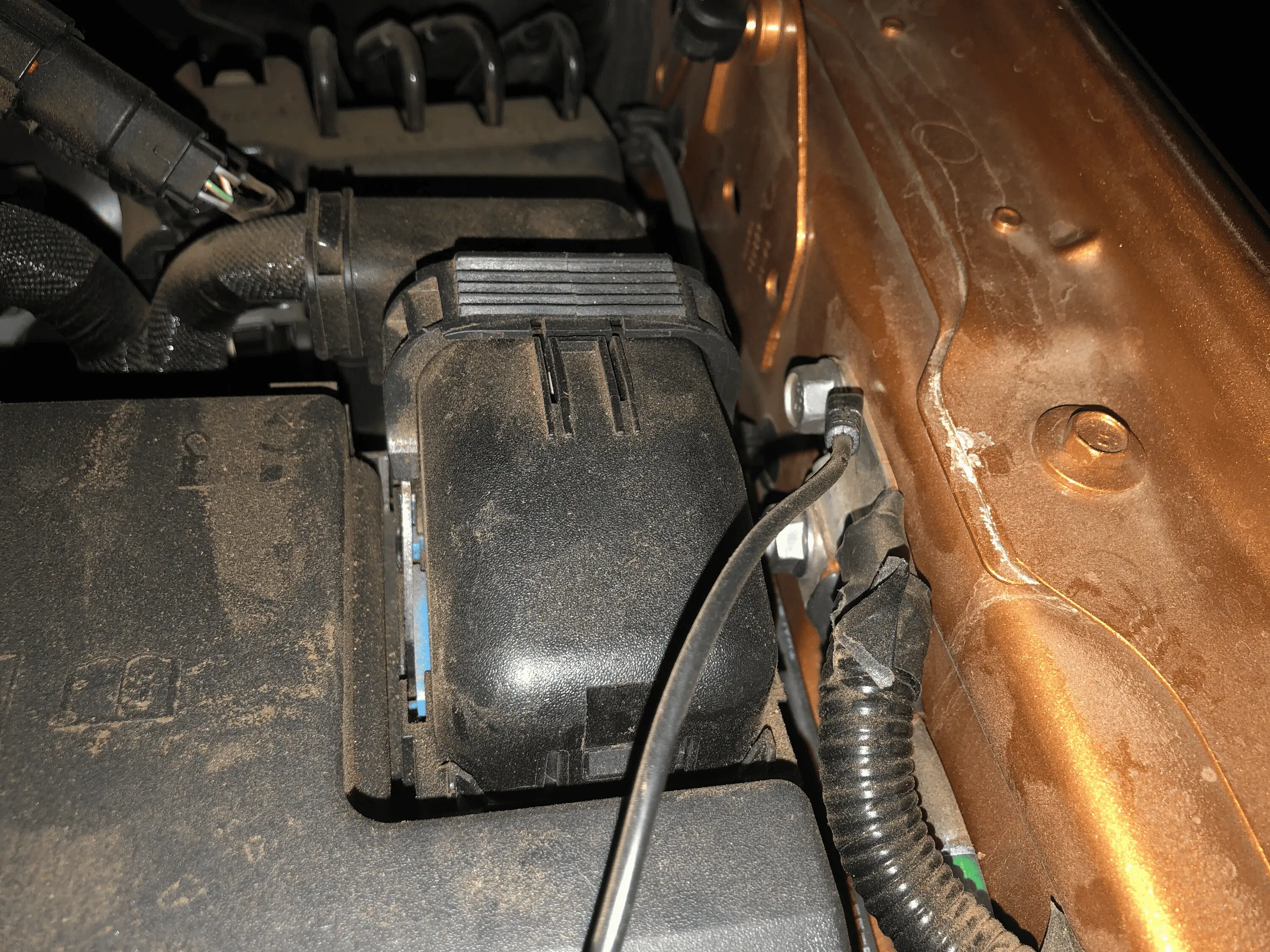

I went down and took a picture of how I have it connected:
According to videos I've seen on the proper way to charge a vehicle with a BMS (Battery Monitoring System), like our Rangers, this is fine. Really no different than using chassis ground. It's just easier for me to connect it there. It remains odd to me that you are getting hibernation notices at a set time period, and I do not. Even after 60+ days.
Here a LINK to one of the videos I referred to.
I'd put money that this is the reason. If you actually include the BMS module in your charging circuit, it actually knows the SOC on the battery, if you don't, BMS thinks the battery is only continuing to discharge when you may in-fact be charging it. It's all about the loop in the circuit and going to a ground on the chassis cuts out BMS, thus deep sleep is normal.
