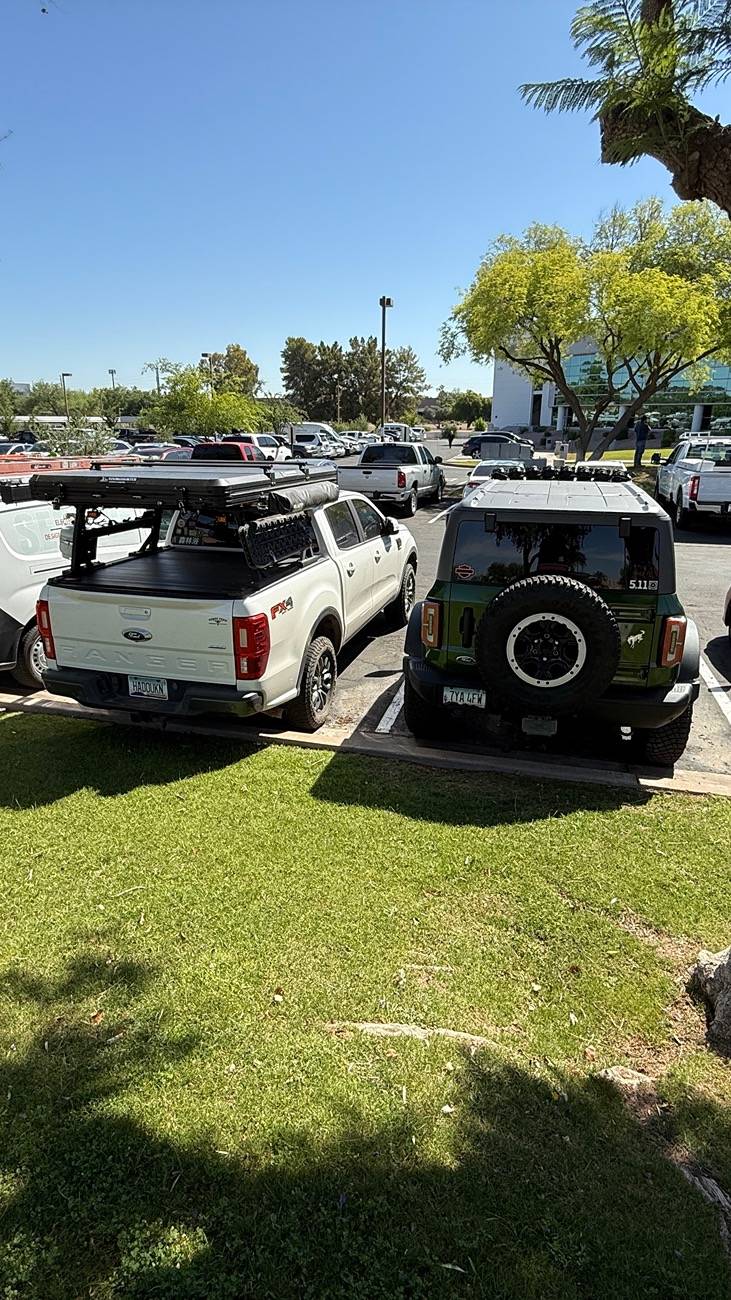

So, I had performance tuner that I could monitor intake air temperatures, fuel data, boost psi and transmission oil temps. When towing I found that the boost psi stayed considerably higher while cruising with a trailer, which isn’t a surprise. The stock intercooler would start to underperform rather quickly (within 10 minutes), especially on long uphills and the intake temperatures started rising rather quickly. My observation was that the fuel usage started spiking to obscene levels anytime the boost psi went above 9psi with the stock intercooler heat-soaked. Which is a thing turbocharged engines do, they call for more fuel to cool the cylinders when the air intake temps get too high.
Also at the same time, while towing above 65mph, my transmission fluid temps were eclipsing 220F which meant my fluid’s lifespan would start to degrade quickly and that would expose my transmission to premature wear. So I upgraded the larger capacity aluminum oil pan with internal/external cooling fins. And although I couldn’t monitor the rear differential temps, intuition says the same heat issue may exist for the rear differential so I upgraded to a large capacity cover. The upgraded oil pan completely resolved the heat issue and it towed at 85mph (just for testing) with normal temps.
The intercooler install came next between 800 mile towing trips. The upgraded intercooler idea came from my father who tows with a 2.7L F-150 and saw great results. So I went with Mountune USA, it was a very high quality kit. It took an afternoon to install. I tested it (with no trailer) on a hot day before and after the installation. The intake temperatures were already remarkably better. As soon as throttle was off idle, the new intercooler would open up and the intake temps would PLUMMET. I took it on its first 800mi tow trip and WOW WOW WOW, it was night and day better (over 35% improvement in trip MPG). It shaved hours off my trip because I didn’t have to stop for fuel so often and I could cruise at a higher speed.
They were fun upgrades with very satisfying results.

I’ve been running this setup, minus the new RTR wheels for a couple years now and I can’t say enough great things about it. I absolutely zero rub even when articulating through terrain. I load up this thing for camping trips and pull a 19’ motorcycle trailer with it. The ride around town is night and day better over stock. The suspension floats over bumps and all the rear end harshness is GONE. It tows and stays level even with 800lbs on the tongue. Between my suspension mods and my towing performance mods, I’m going to have a hard time ever separating from this truck; it does everything so well now. I can’t understate the improvement by replacing the junk OEM 2-leaf springs with the OME 10-leaf springs.
Wheels/Tires:
•285-65R18 Falken Wildpeak AT3
•RTR Evo6 18”x9” with 0mm offset.
•RTR fender flares to perfectly match the poke.
•Front Air dams removed
Front:
•ICON tubular Upper Controls Arms
•Ford Perf Fox 2.0 coilovers (2in lift)
•ReadyLift high clearance intrusion beams (crash bars)
Rear:
•Old Man Emu 1.7” Medium Leaf Springs (adds about 1.5” actual lift) (Part# S3M-OME45MMLEAFKIT)
•Bilstein 5160 Remote Reservoir shocks
Towing Upgrades:
•Mountune USA performance intercooler (completely saved my gas mileage while towing, remarkably over 35%)
•Custom Tune from Unleashed Tuning (guy named Tori), I had a 5-star tune that was garbage.
• B&M aluminum high capacity transmission pan (keeps my fluid temps from overheating even when towing at 75+ mph)
•AFE Power High Capacity Rear Diff cover
•Tom Woods 1-piece custom drive shaft
Other unrelated mods:
•Gibson Catback Perf Exhaust
•K&N panel filter
•GFB Blowoff Valve
•Mishimoto Catch Can
•Shrockworks Rock Slider bars
•Diamondback HD bedcover
•RTR led grill
•BajaDesigns fog lamp replacement
