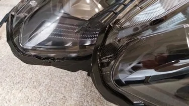

I took some pics with the light in place <please excuse the pollen> . Yes I see where one mounting point does not line up but it does not stop the light from going in place or effect the body work from going back in. The light seems pretty solid without it. I don't see any issues with it following the body lines of the truck. Now....if I could get the rest of the functions of the light < drl, turn signal,etc.> to work I would be a happy camper. Does anyone think that making the changes to forscan? for the lariat lights will work ?

I'm glad you got yours to fit. The fitment on the sides does not match the fender correctly....you can see it in your last pic, the bug deflector hides some of it. Personally I don't like the gaps but I may just be too picky. Look at the xlt to lariat headlight thread......in the 1st post there is a diagram for the headlight connector.
Found this pic.....mustang lights vs oem, you can see the difference in the radius on the outside corners
