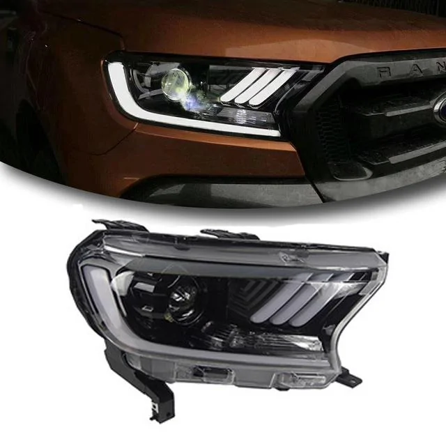

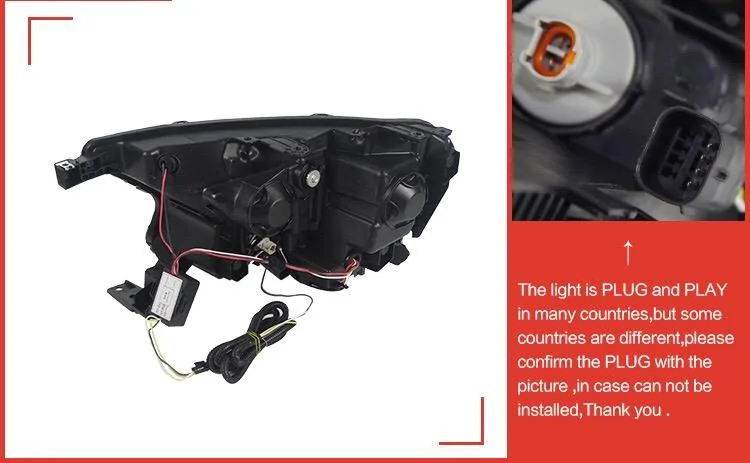

Here's a couple pics from the listing.
The outside lower mount is fastened behind the fender at the fender/valance seam.....notice how that seam is further forward on the rotw rangers. The rotw ranger also uses 2 connectors, that's an easy fix since the main connector is the same (8-pin mx150) but the outside lower mount does not line up. The shape of the fender around the headlight is also slightly different than ours so even if you cut off the outside mount & make a bracket it will not match up to the fender correctly.

Please tell me how it's an easy fix ?

I took some pics with the light in place <please excuse the pollen> . Yes I see where one mounting point does not line up but it does not stop the light from going in place or effect the body work from going back in. The light seems pretty solid without it. I don't see any issues with it following the body lines of the truck. Now....if I could get the rest of the functions of the light < drl, turn signal,etc.> to work I would be a happy camper. Does anyone think that making the changes to forscan? for the lariat lights will work ?

The fit looks good!
It sounds like function could be a mix of wiring mods and FORSCAN.
Anybody have a headlight diagram for ROW and US Ranger headlights?
