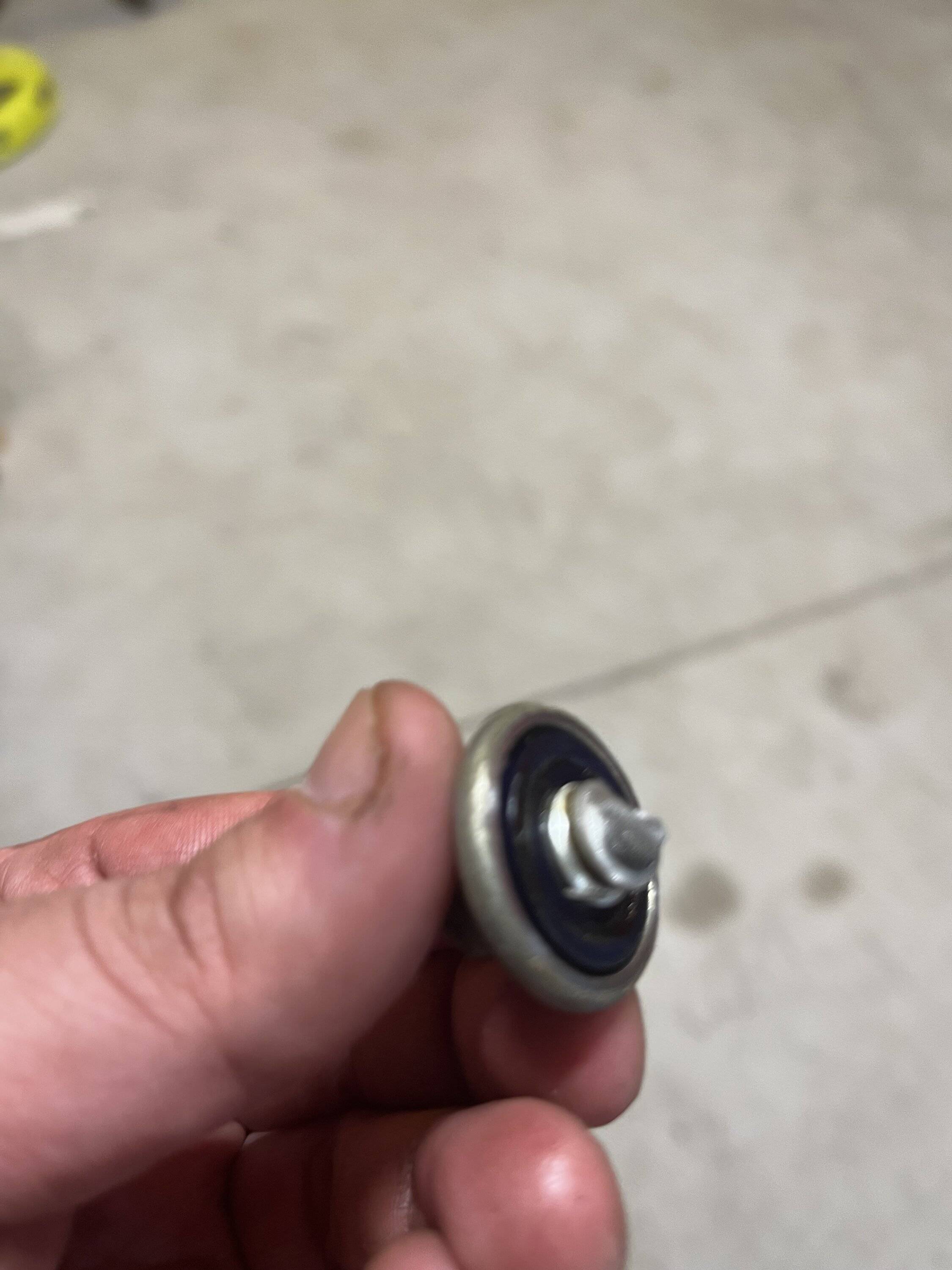

Hello,
Was changing my oil today went to torque drain plug and it snapped before it hit the recommended spec 20ftlbs from ford. I have no interest in fighting ford on this as they won’t care and how will I prove it. The head is snapped off and probably could be gotten with a screw extractor. I am way to nervous to do that in case I make it worse so am having it towed to dealership with aaa. Dealership apt is next Friday but they said they may be able to get to it sooner. They were the earliest as well, next earliest was end of November. Being my only vehicle with no family near this is a shitty situation. But enough of the pity party, anyone know how to shift to neutral w/o engine power? Won’t shift with accessory and i am not sure if aaa knows how? Not sure as I’ve never needed a tow. I have plastered the inside of car with signs so the techs don’t start it by mistake as well.
If I remember correctly that drain plug is 15 metric, I use a box end 15 and when drain plug seats I just tug on wrench to tighten on down. That's all it needs. I am very OCD about those things and using a torque wrench for that is something I don't do.

That is a straight thread, not tapered. The head of the bolt tightens against the gasket. If the head snapped off you've got bigger problems than just the plug. Pan threads are buggered.
Good luck.
I think it was a bit more than just the head, here’s a pic. Am hoping it’s not a bigger issue besides an extraction.
