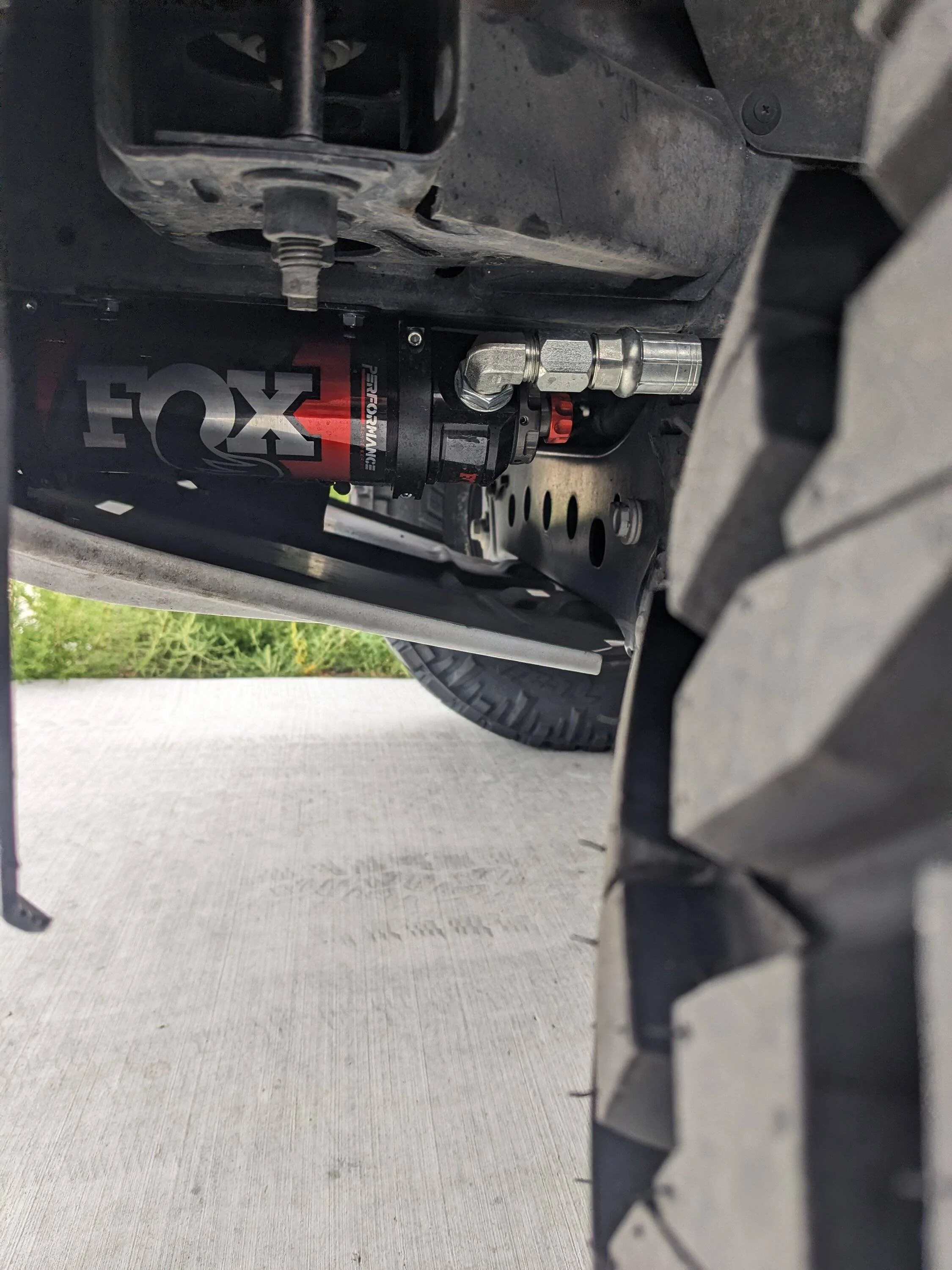

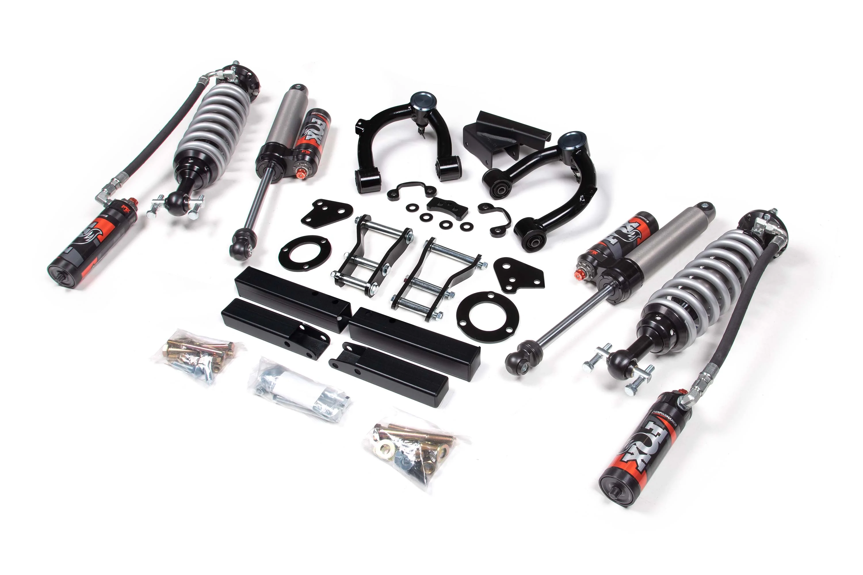

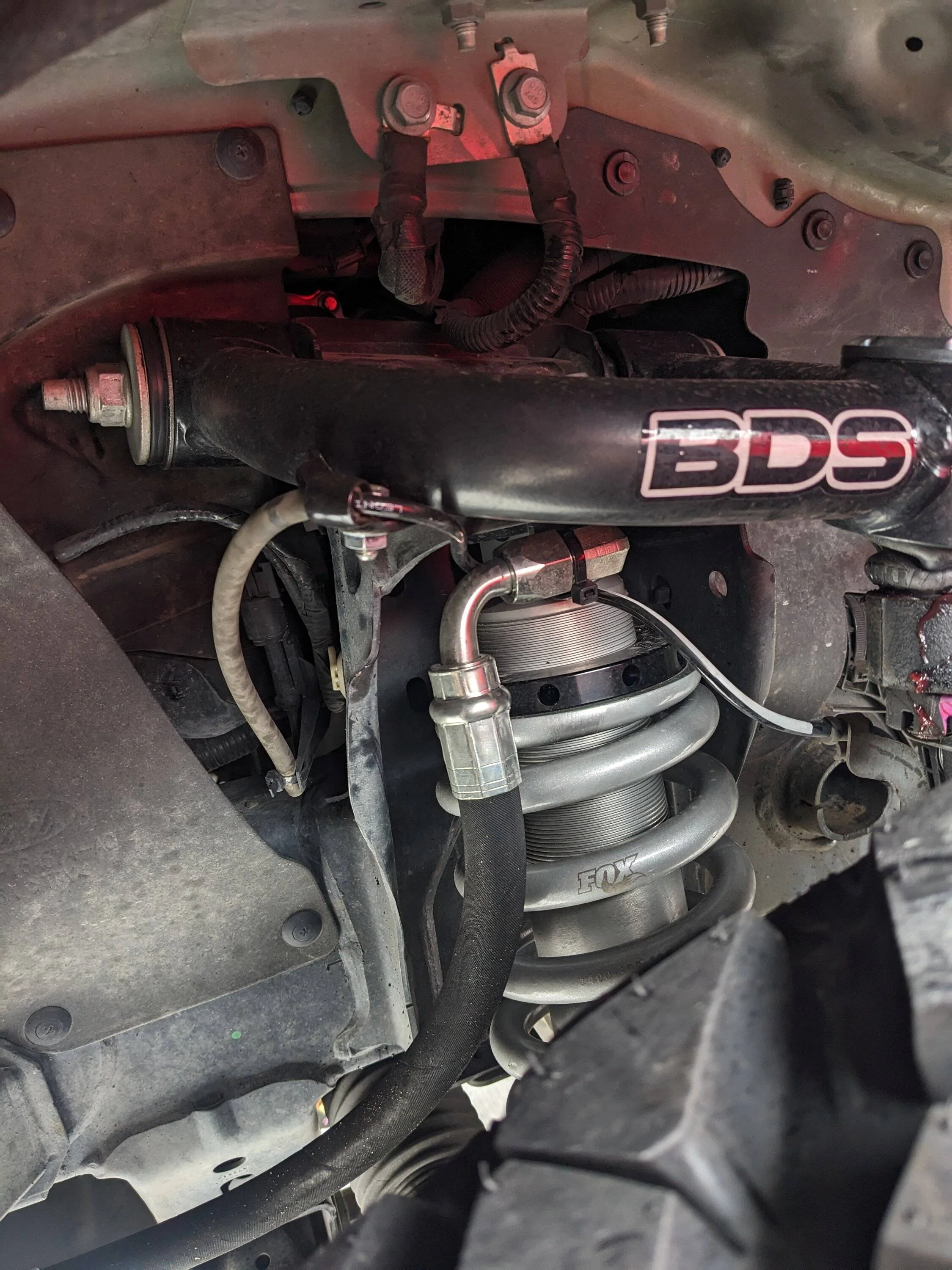

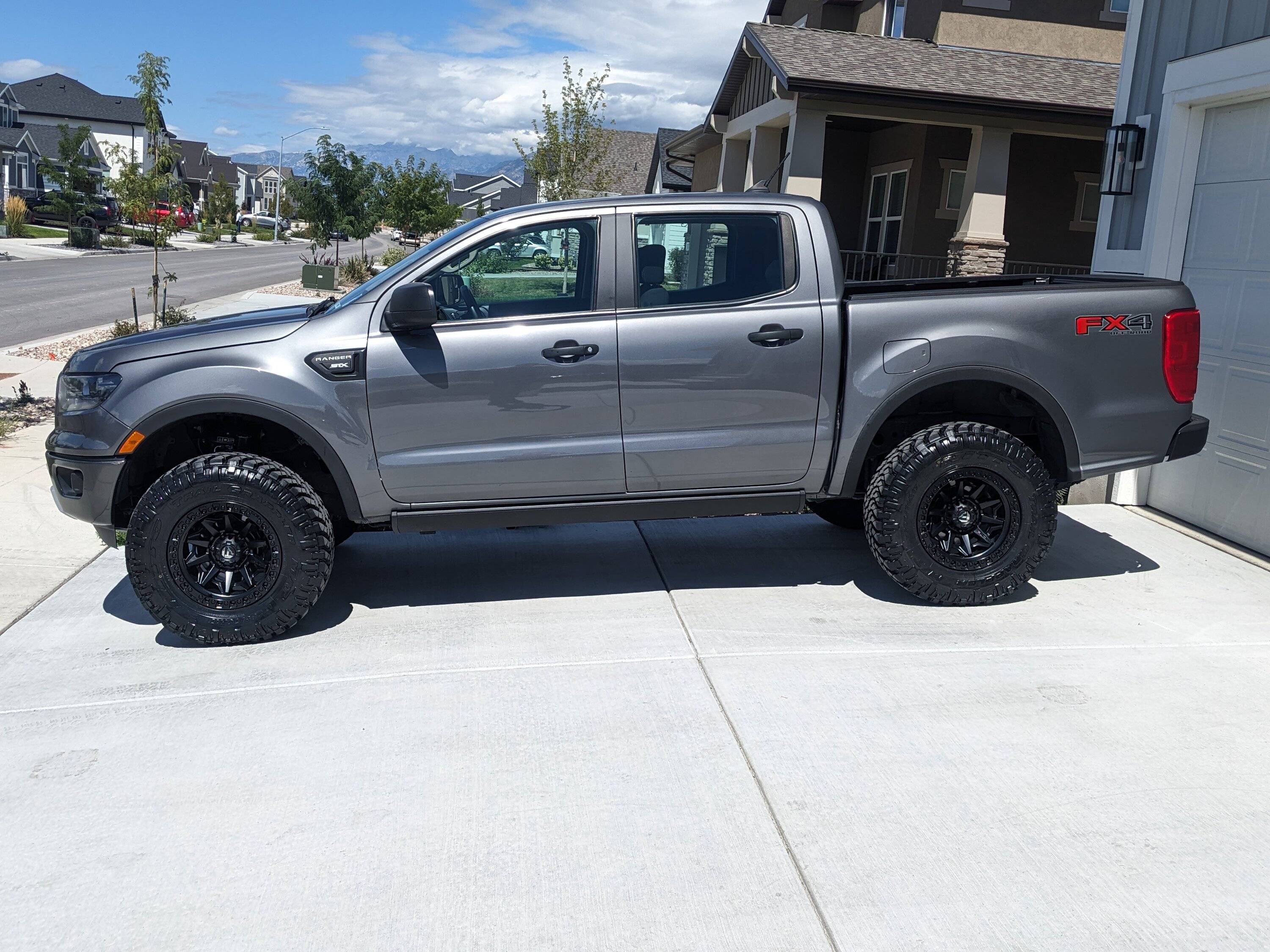

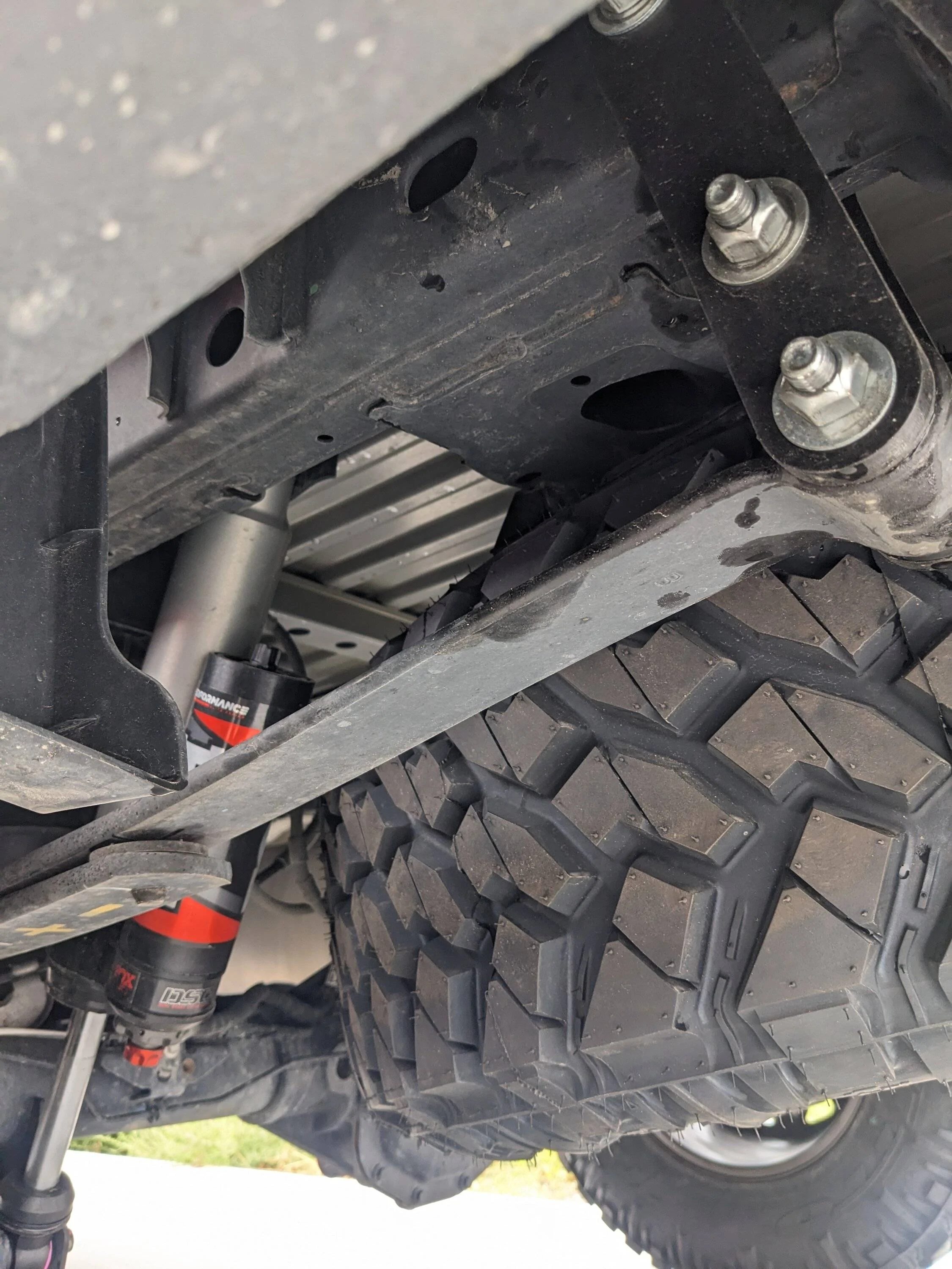

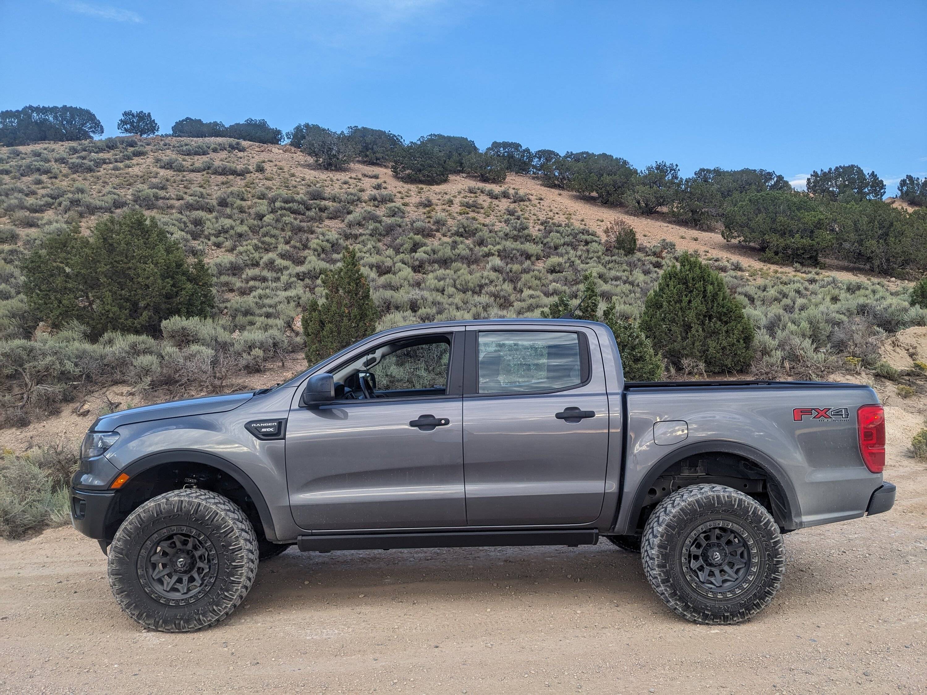

I experienced the lift/shocks debate with myself as well. I went back and forth a lot in every direction ? In the end I did go with the BDS 3.5 lift.
I decided to do the BDS 3.5 lift with Fox 2.5 Remote Reservoir DSC's in the front and rear. This route has a full length coilover in the front. No spacer
The rear is lifted by a leaf spring shackle vs a block.
It also comes with the BDS upper control arms and I did the front differential drop to correct front CV angles.
I also, removed the front crash bars and rear black waffle/sound deadeners in the rear of the front wheel wells. I didn't want any rubbing in any condition off road.
I went the Fox 2.5 RR DSC route so I can adjust the suspension for whatever truck application I need. When I am towing or hauling a load in the bed, I can firm up the rear shocks for a better ride with the added weight or when offroading I can adjust front and rear for a better off-road experience. If I am driving paved curvy canyon roads I can adjust the low speed compression to have virtually no body roll. The larger diameter shocks have made a big difference in all driving conditions. I have been super happy with this lift/shock/tire set up.
Truck specs:
- BDS 3.5 lift (BDS UCA's, Rear leaf spring shackles, and differential drop)
- Fox 2.5 Remote Reservoir shocks with Dual Speed Compression adjusters
- Fuel 17x9 +1 offset wheels
- 285/70R 17 Nitro Trail Grappler M/T
