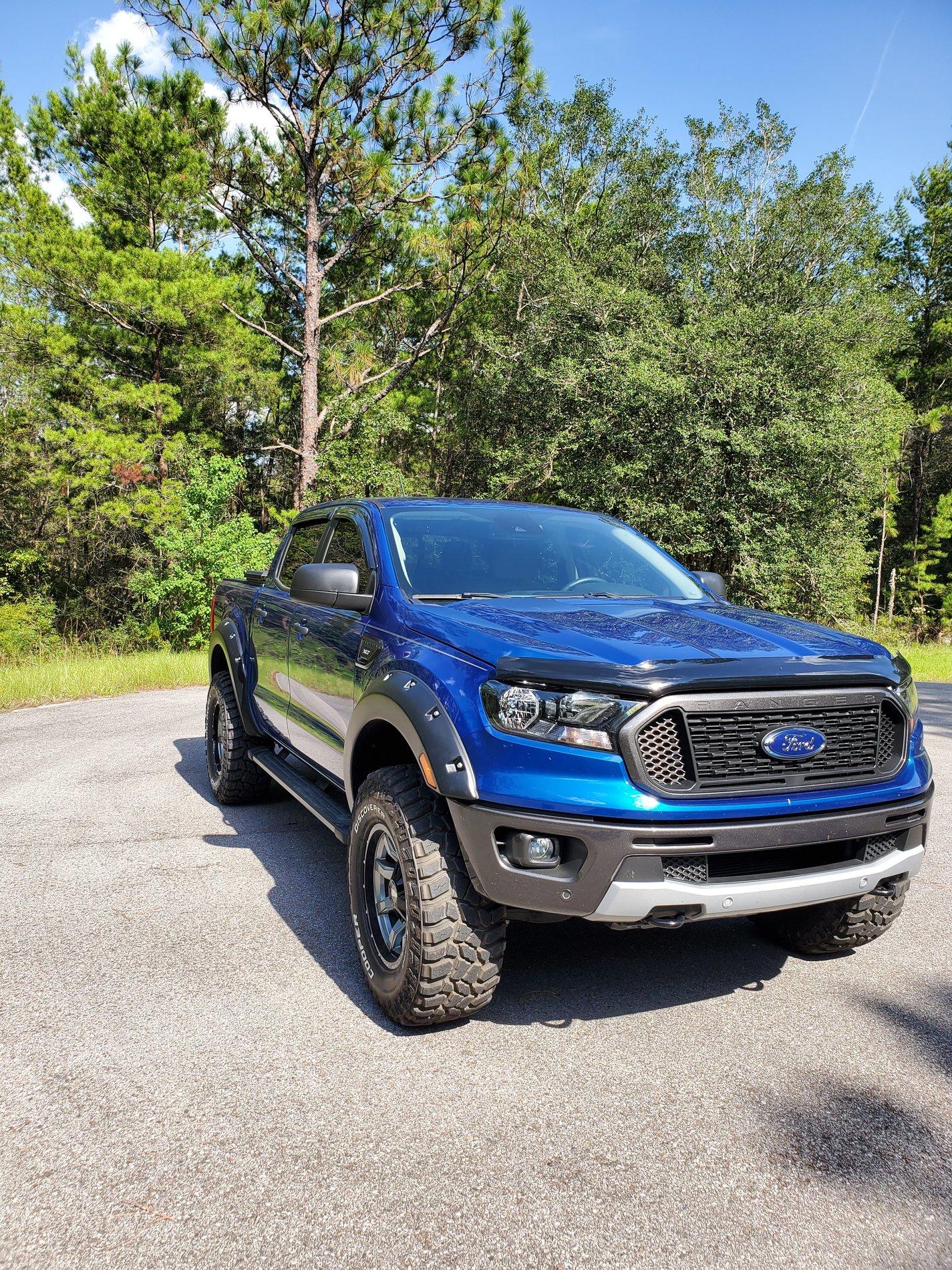

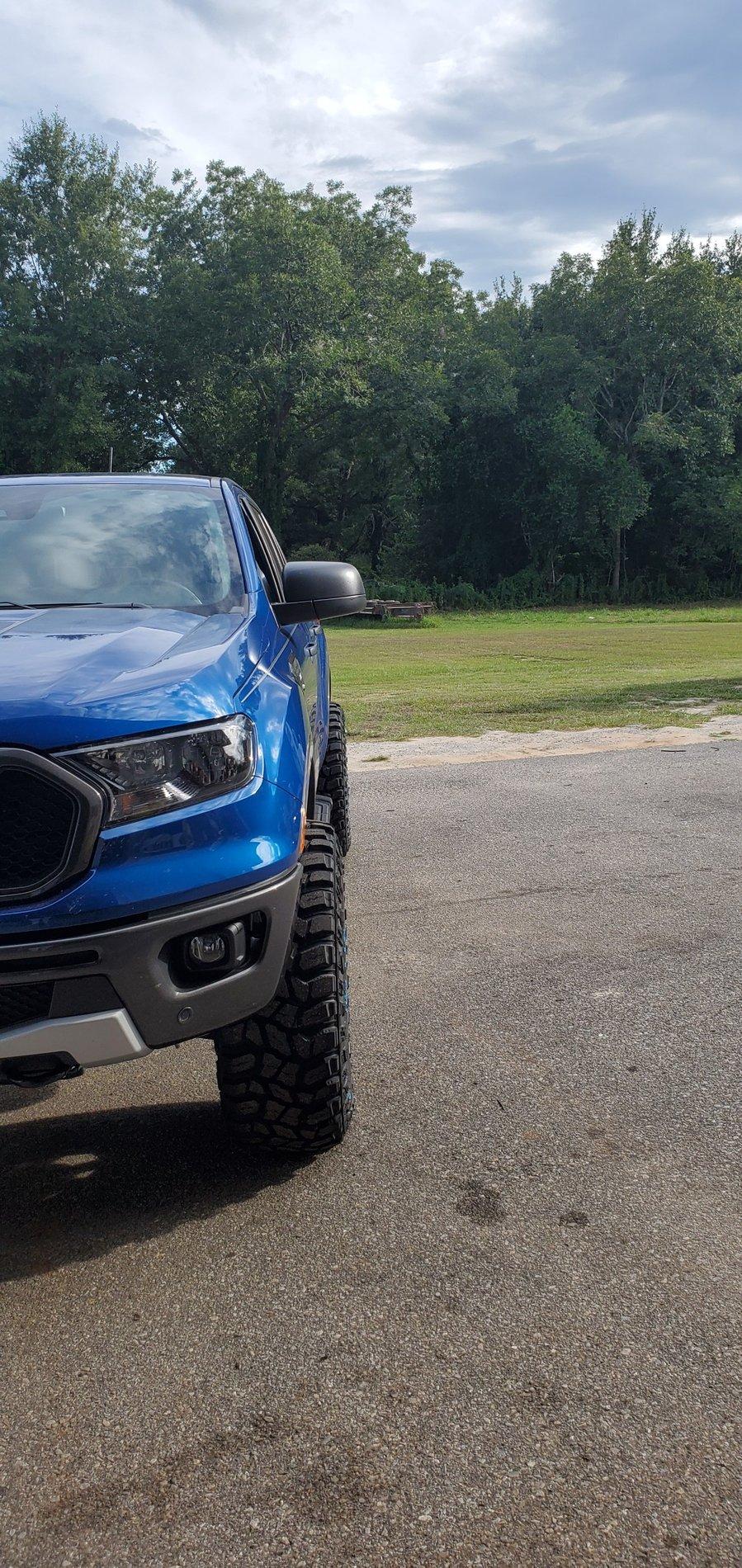

RangerCoby, not to steal Doug's reply but for me I went with the 3inch front only. SST Cooper Pros are outstanding off road and even on road. One of the best performing MTs for wet pavement that I have ever ran. The siping are well engineered to move a ton of water and i have zero issues with take off or hydroplaning at highway speeds. Have you seen my other post on paint protection for the Hunting season here in NW Florida? I used 3 gallons of plasti dip and it was amazing to keep the brush contact off the Ranger. We run deer with dogs here and are always on the move down small tight pig trails to get ahead. Or heck even make our own trails when need be. Have to transition from sand, mud, to even deep water crossing at times. Our season is over and I've just recently peeled the truck with zero scratching of the clear coat.

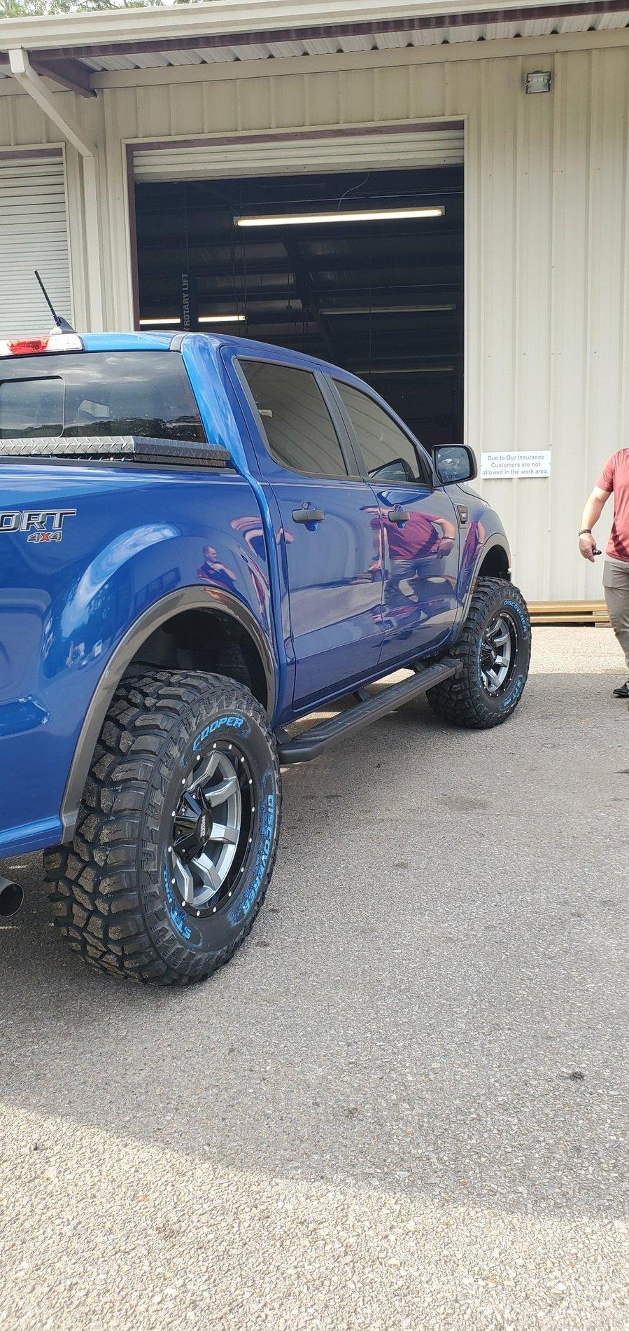

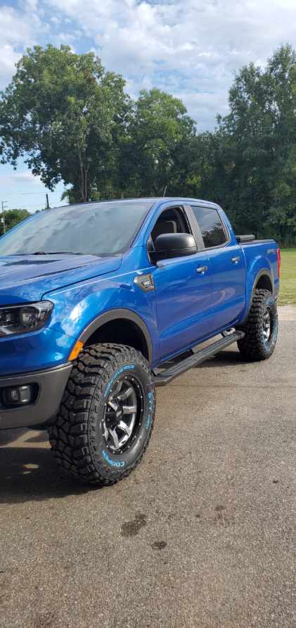

Ohh yea brother, nothing like listening to the dogs at night for sure. I bought my Ranger back at the end of May, at the time noooo one had coil overs ready that were over 3inches. So I went the cheaper route and spent about $200 for the Readylift kit. I've had zero issues with it so far with a tad over 15k miles on it. I'm running a 17x9 -12mm off set wheel with 295/70/17's. Had to add the flares to help cut down on the sandblasting and mud off the sides. Here is what it looked like with out the bushwacker's. I'm still thinking about painting the letters blue on the tires, lol.
