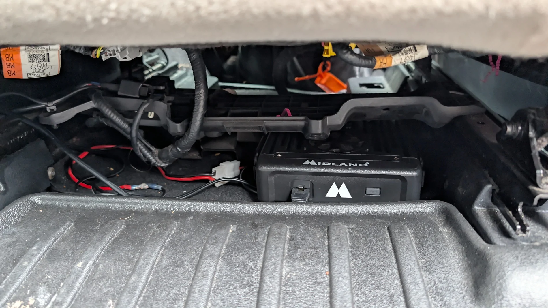

So I installed mine yesterday under the passenger seat. I used the passenger firewall plug which fit the antenna wire perfectly. Power and mic wire routing is temporary, I got this unit out of a trade in vehicle that had been hardwired in so I spiced in a 12v cigarette lighter plug and eventually I will hide it in the center console and cut out a spot for the mic extension to plug into.
