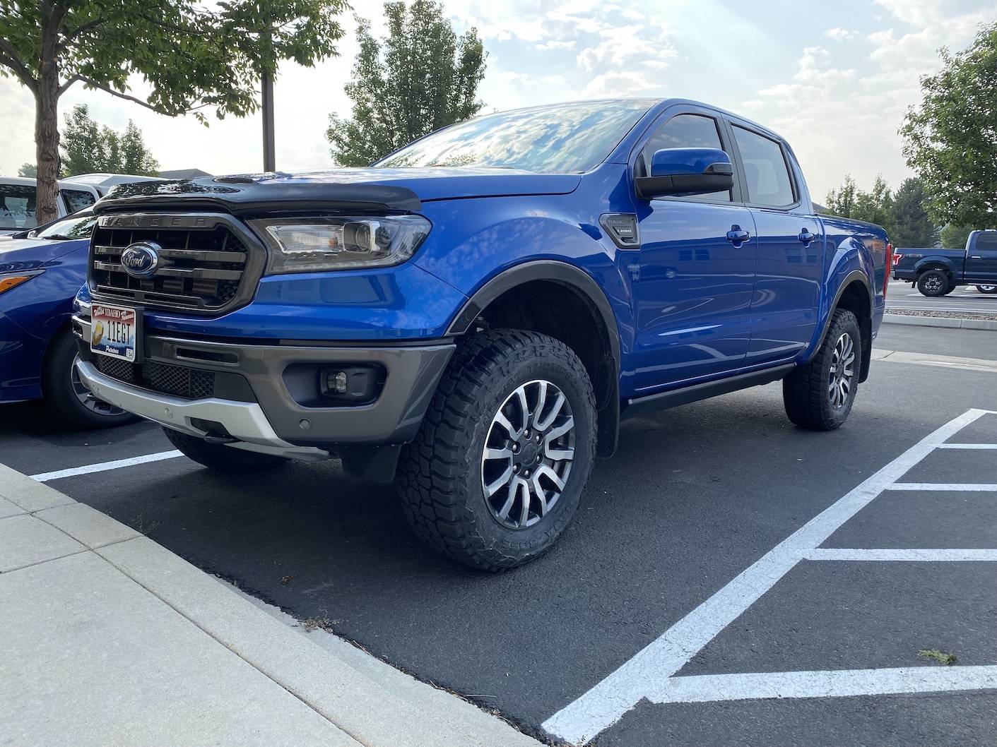

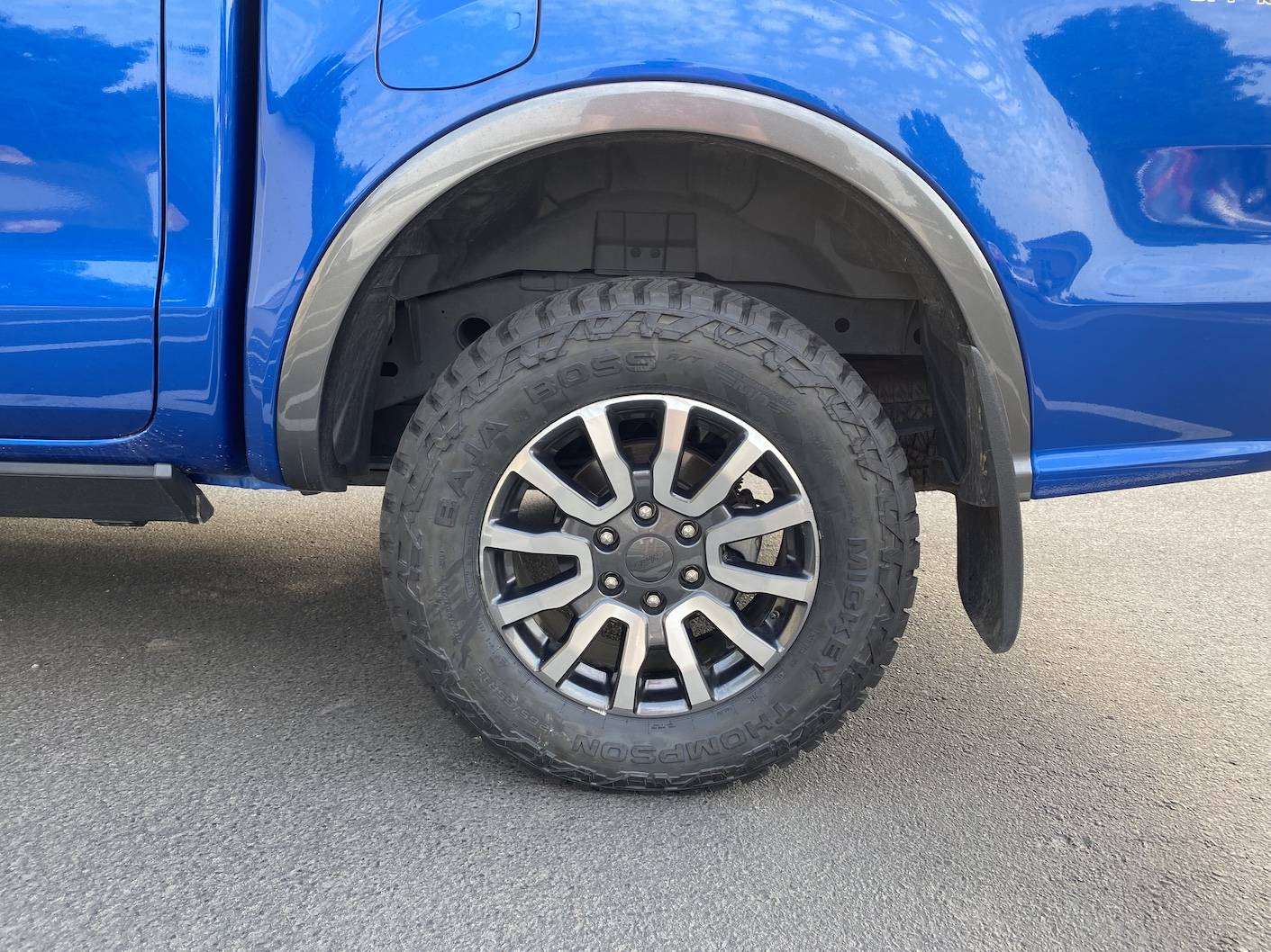

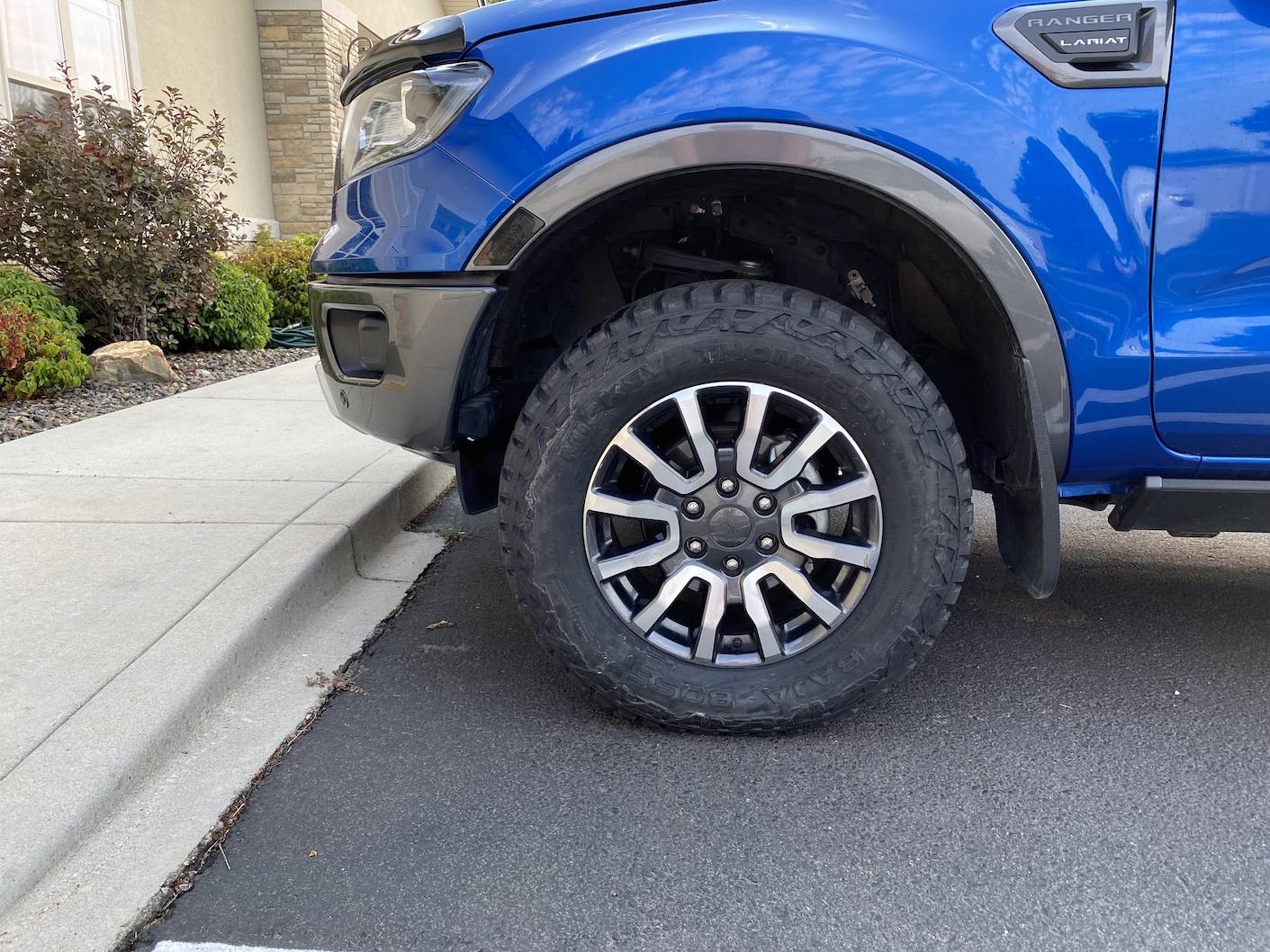

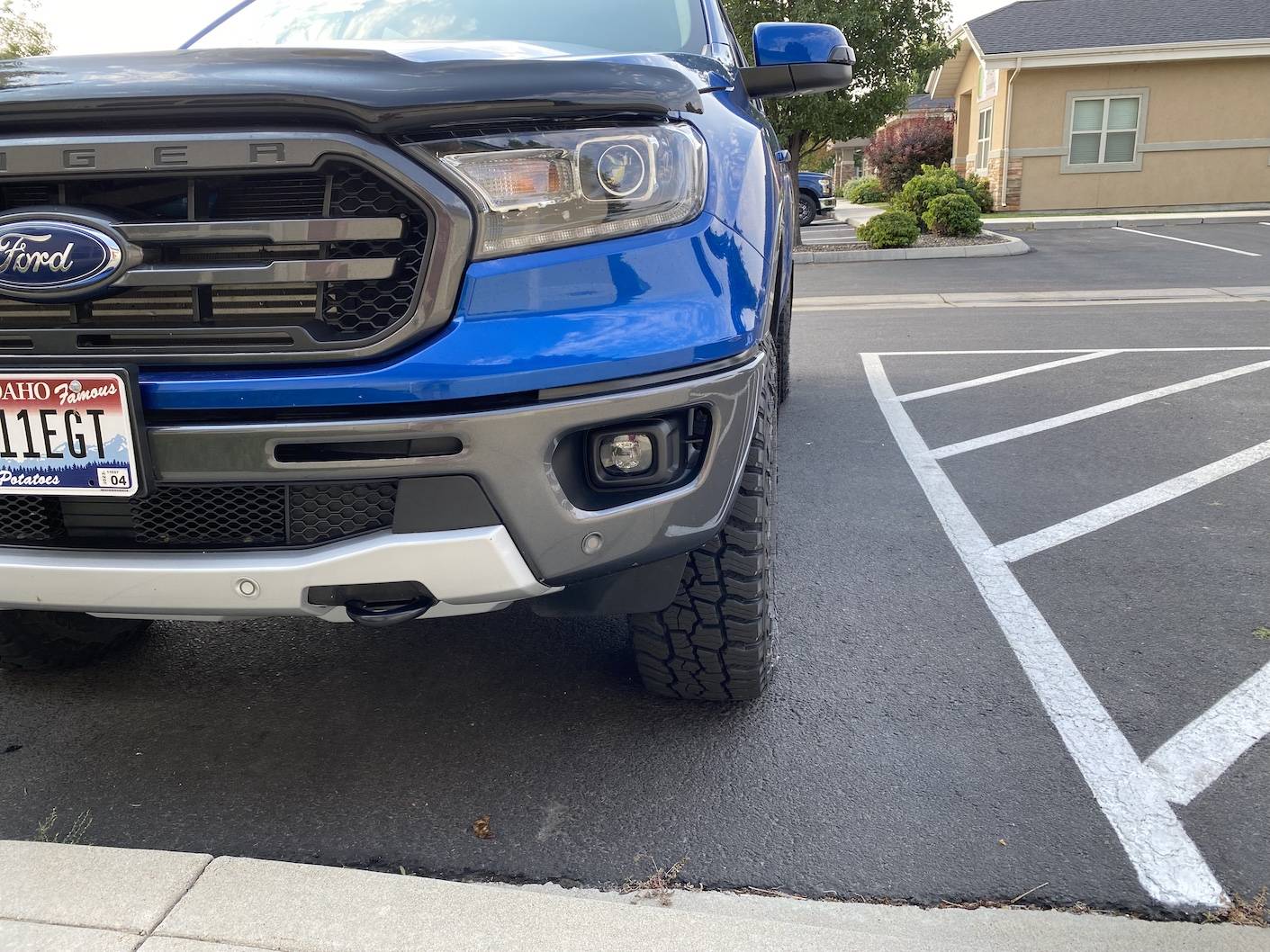

MT Baja Boss installed yesterday. At the tire shop, there was some rubbing on a portion of my aftermarket mud flaps, so I just cut away the portion that interfered. With that done, they *just barely* rubbed the front crash bars at full lock. I know I can loosen up the crash bar and scootch it forward a hair... but I came up with a different solution: I had 1.25" Bora spacers installed with the factory tires, as I really disliked the factory stance. With the new MT's (which have a much wider sidewall profile) the tires now were sticking out beyond the fenders pretty well (by about an inch or so). So, I simply removed the spacers, and now I have about 3/4" clearance between the tire and the front crash bars at full lock on both sides. The stance of the truck looks great on these MT's, so I'm planning to leave the spacers off the truck for now.
So far the only real change I notice is that the MT's ride *slightly* louder than the factory rubber... but just barely. If the climate control is on *at all* I don't hear the tires at 40 mph. If I turn off stereo and climate control so the truck is as quiet as possible, I can detect the tire tread noise. But it really is a quiet tire considering how fat and knobby they are.

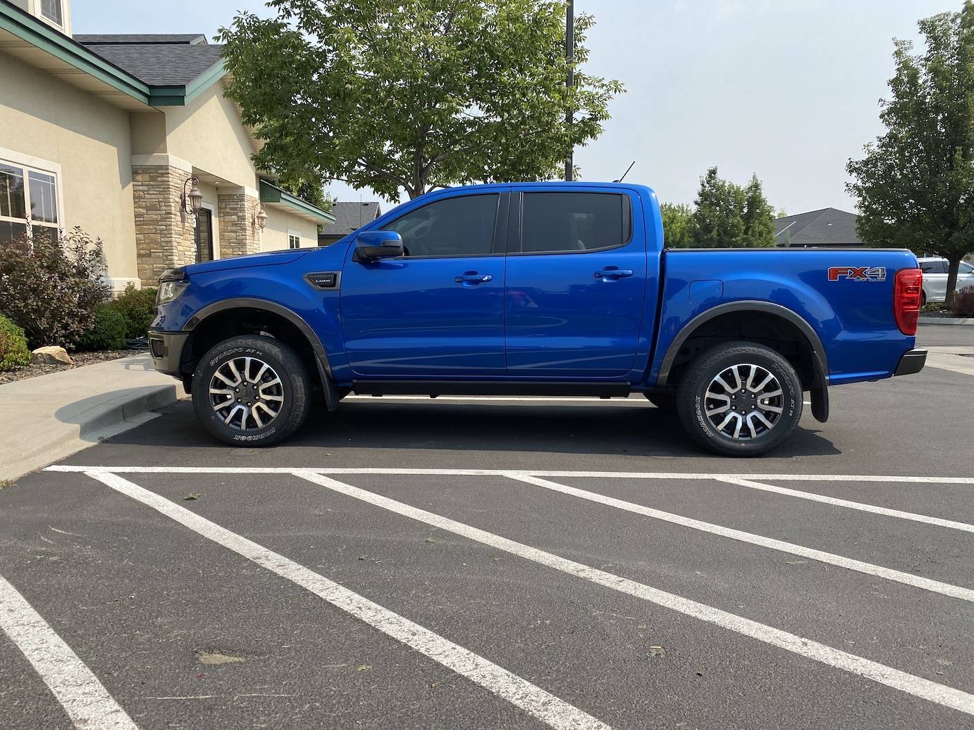

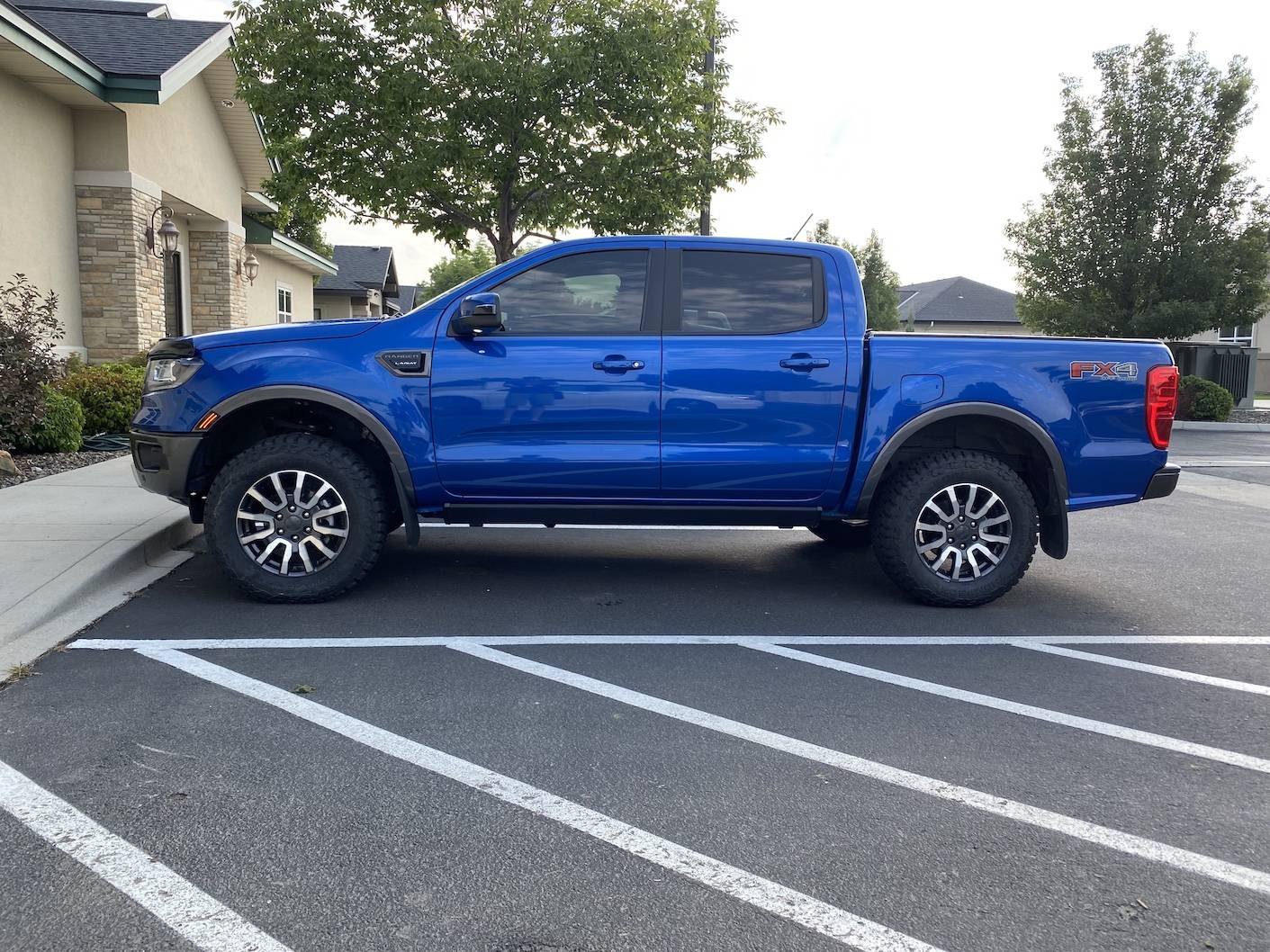

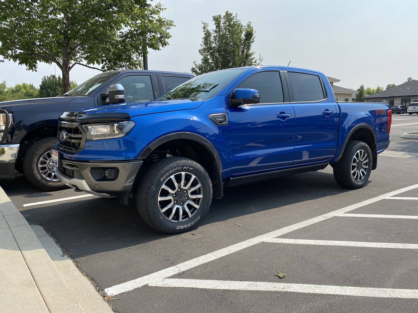

Anyhow, there is not a lot of info on the MTs, so here are some pictures. Note that this truck has a leveling kit on it - the front has been raised about 2.5" from stock.
Factory Hankooks:
New Mickey Thompsons:
Factory Hankooks:
Mickey Thompsons:
Some other assorted shots:
Taking them off roading for the first time this weekend in the back country near Stanley, ID. Can't wait to see how they perform!

Looks good! Those are the 18" wheels right? What size MT's did you go with, you got more width and height. Curious also if the spacers worked well on the factory wheels, I was considering maybe 1" vs dealing with new wheels for more offset.
