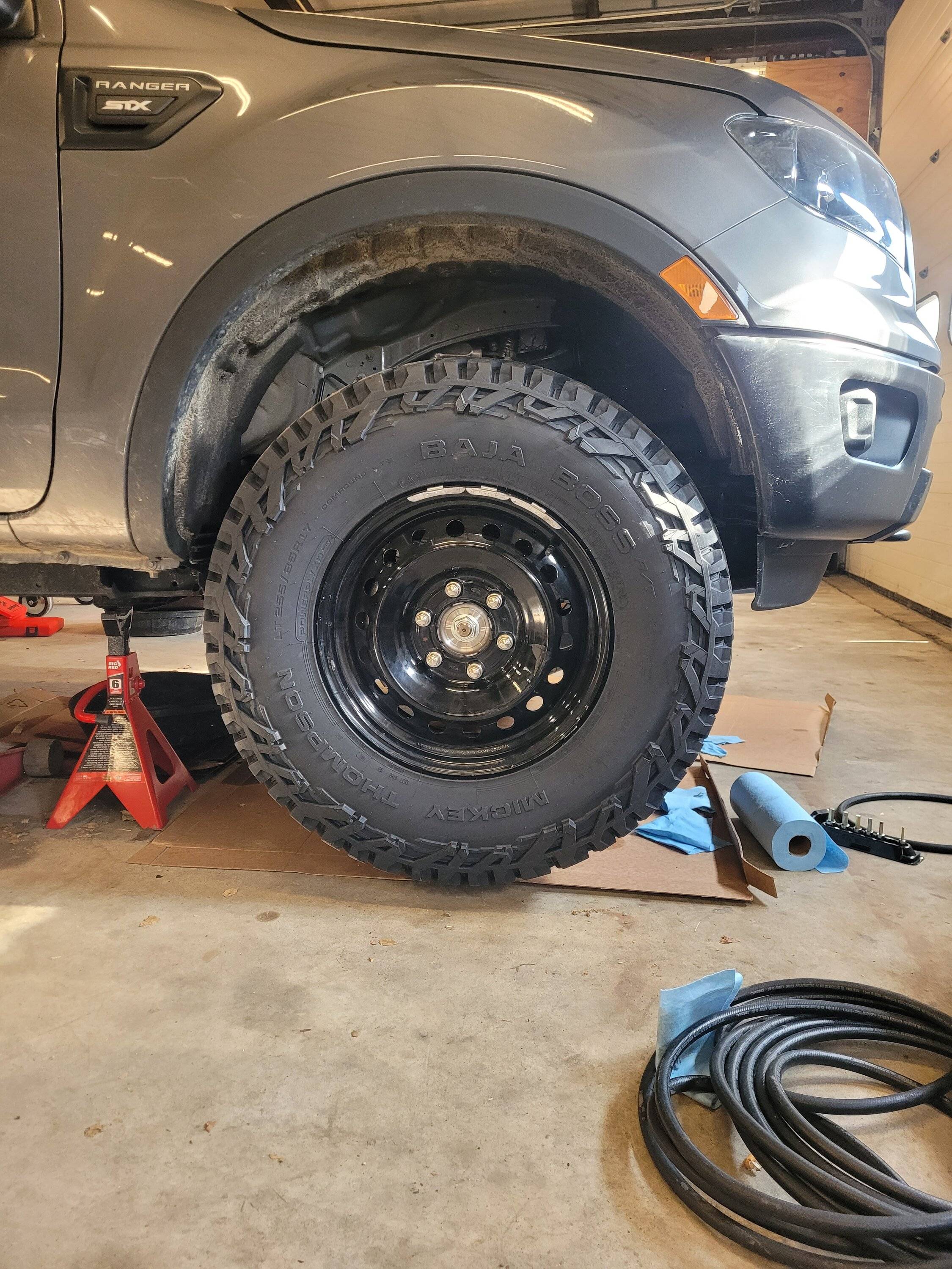

Well, now that I have my transmission pan issue mostly sorted, I couldn't help but throw one of the steelie and big tires on just to see how she looked.
Keep in mind this is with no lift, just the front end jacked up and suspension drooping.
I want to get my transmission pan 100% sorted before starting anything else, and I'm also eyeing some UCAs as suggested here.

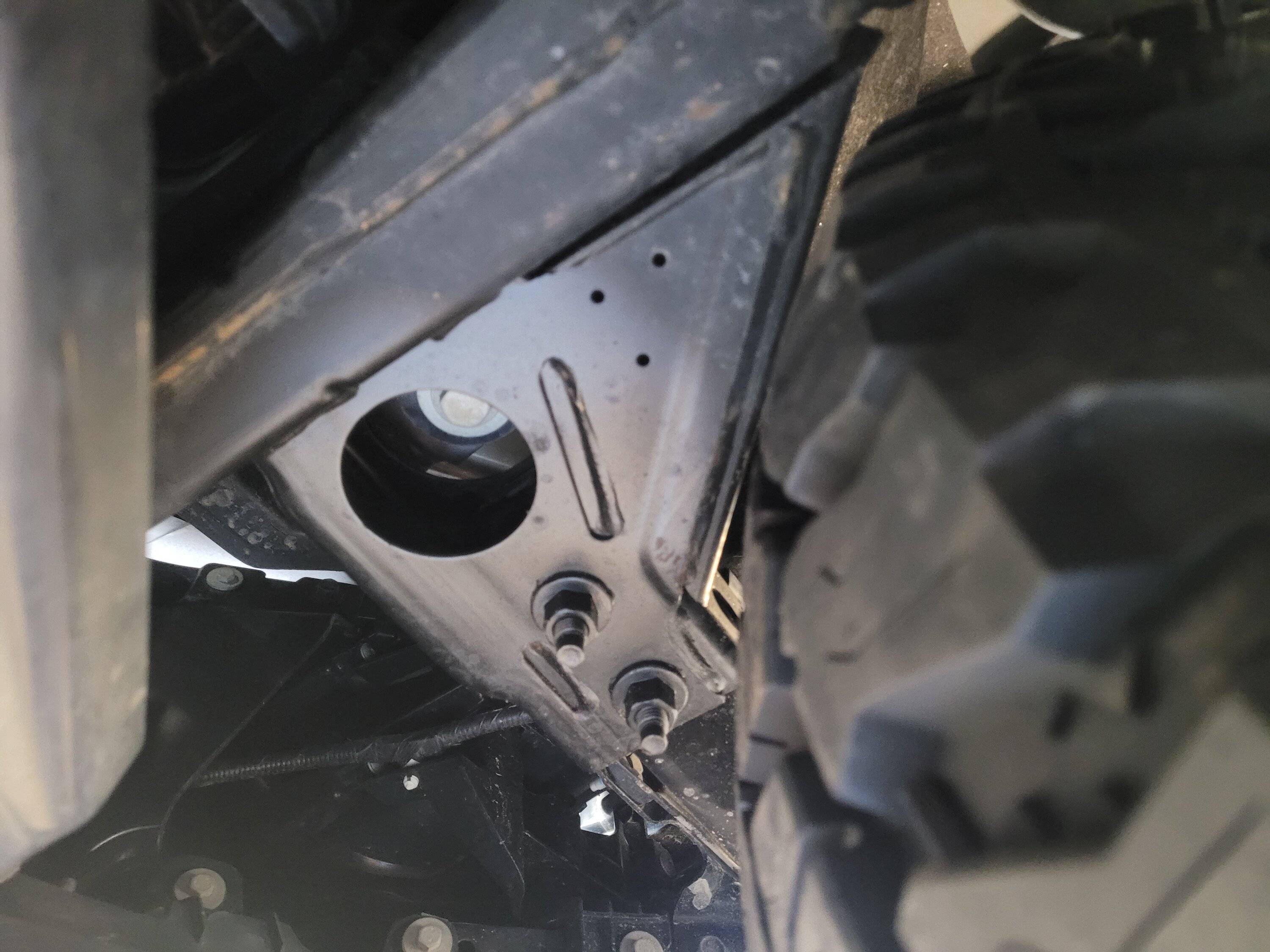

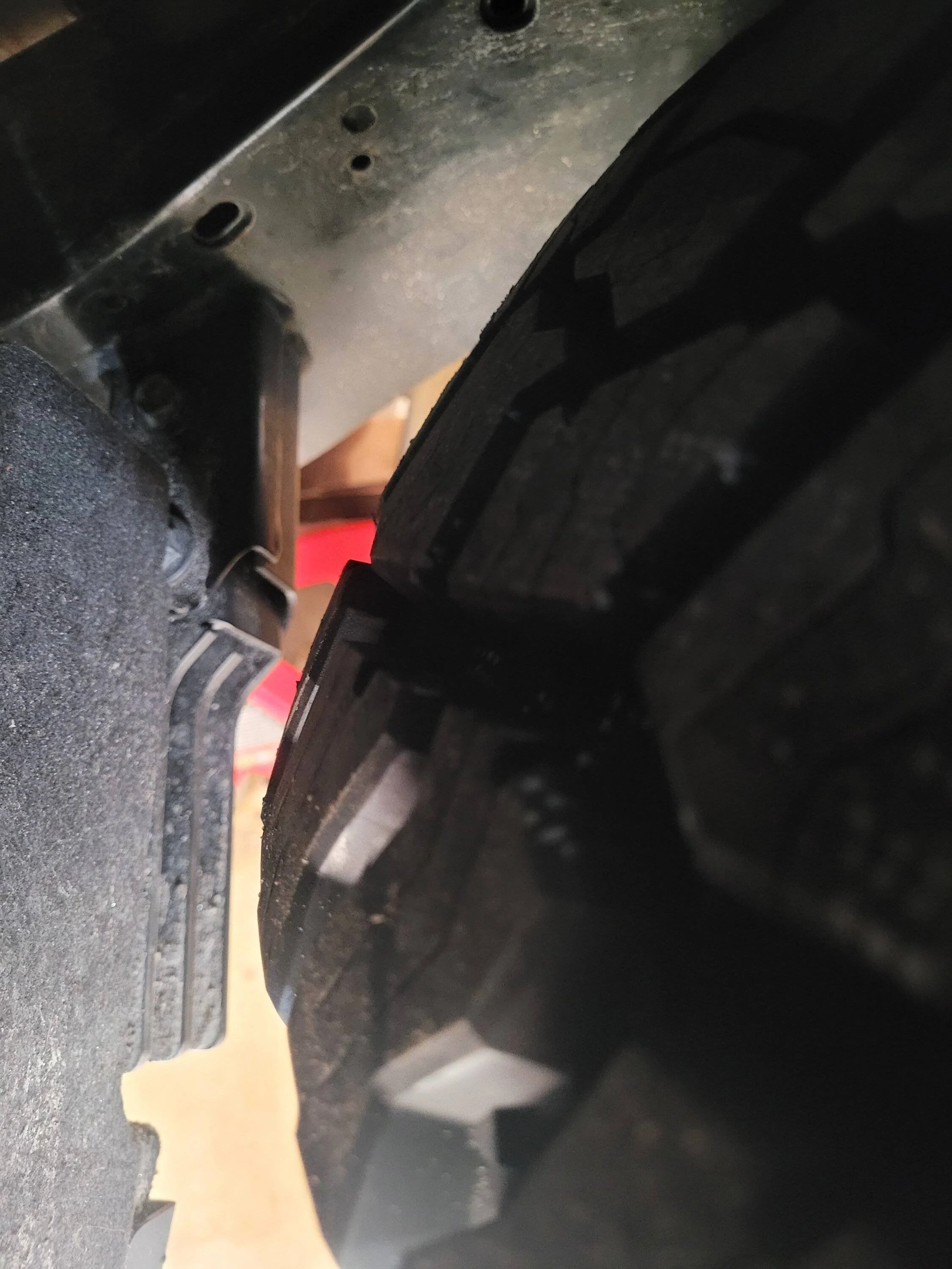

Either way the truck looks mean with these tires. No rubbing in the rear but some serious rubbing up front on the frame.

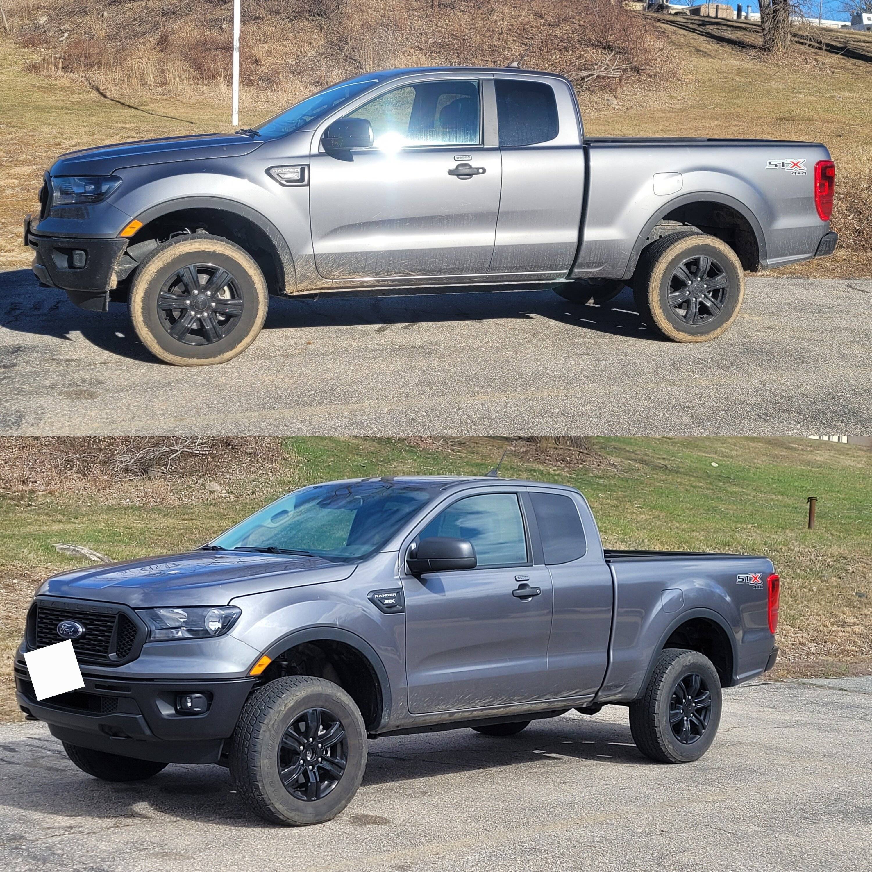

Alright, finally got the lift done. The UCAs and front coilovers proved to be a much more difficult and time consuming task than expected, but once I got the first side done the other side went much easier. The rear blocks and shocks went on much easier and now the lift itself is done.
Here is a before and after:
I didn't touch the front springs yet just installed right out of the box, and I gained 2 inches on both sides. After replacing the UCAs and removing the lower control arms to get the stock springs out my alignment was comically bad so I limped her down to a nearby alignment shop and they were able to get it squared away.
I am super happy with the quality of the SPC UCAs and the Eibach springs and shocks. My only complaint is the new U-Bolts that came with the Eibach Blocks. I have the spacer on the passenger side to fix the lean and the U-Bolts are slightly too short. Not short enough to cause a problem I think but enough to give pause. The blocks are only temporary until I can get some real lifted leaf springs.
