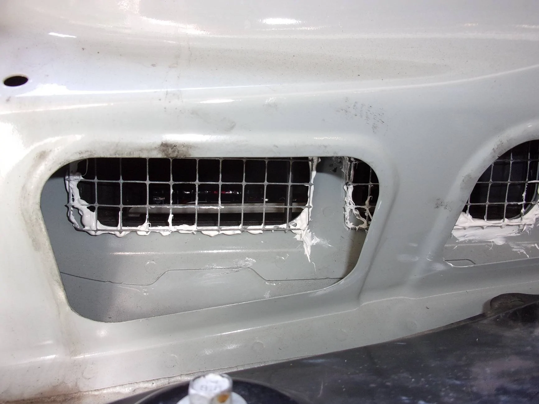

Cover the (Air Inlet) like this
They get into that area from these (On both sides) this is the drain off spots for the rainwater

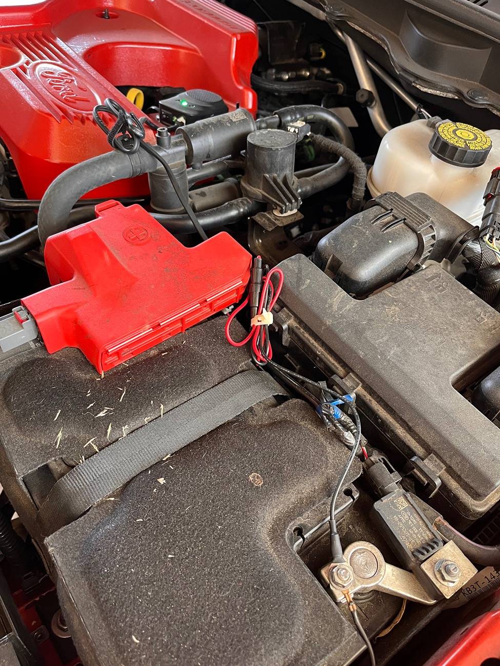

Oh man that sucks. I had mice get into my filter so I installed a screen and I put drops of peppermint oil around the engine compartment.

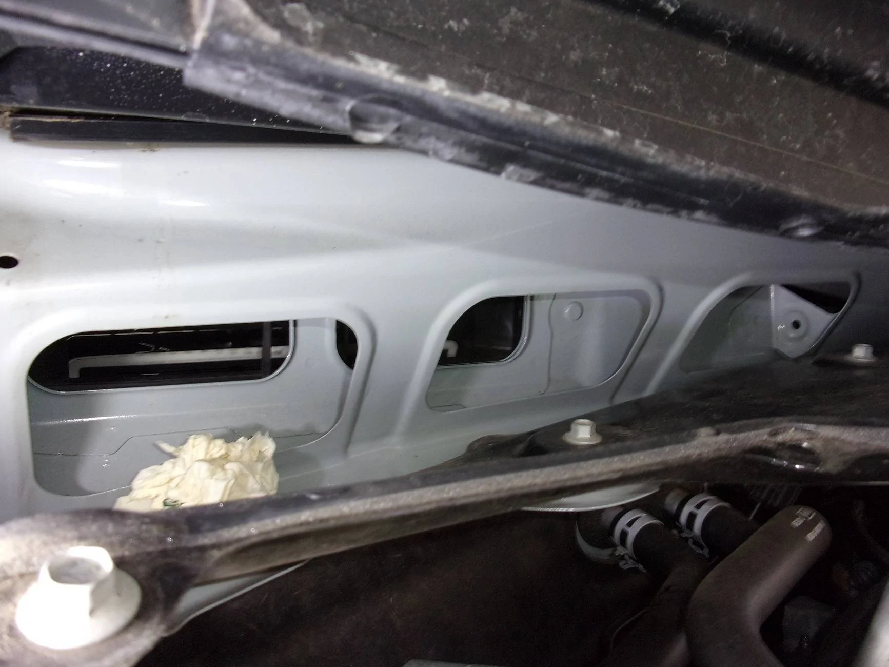

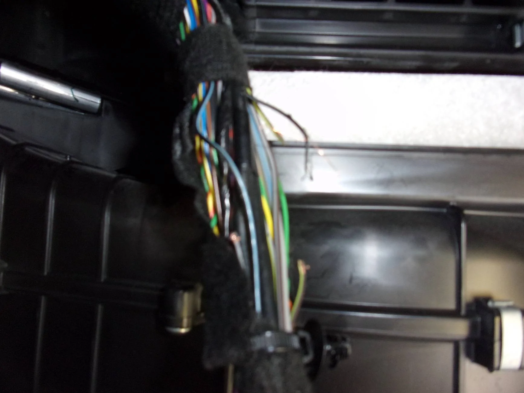

So...the night before last, my truck alarm went off at 1 am, I unlocked the door and relocked the vehicle with my remote, all was good. Then last night, my truck alarm went off at 2 am. Hum, both times my phone stated my hood was opened. So today I opened the hood and found chewed up paper on top of the engine, yes the rats are back and even though I had dryer sheets tied across my engine compartment, I guess they are now numb to the smell. I checked the wires to the front hood switch, and all looked good as did everything else in the engine compartment. For some reason, I opened the glove box and noticed a napkin with green border print on it, it was identical to the one that was chewed up that was on top of the engine. Removing the glove box, I found the rat had eaten through the AC plenum grill above where the cabin filter sits. It had also chewed through 2 wires of one of the main harnesses that sits next to the AC plenum grill. One of the wires was to the passenger door switch (display showed the passenger door was ajar this morning). I'm hoping this wire is what caused my alarm to go off as I don't see any other damage, my fingers are crossed! I zip tied a metal screen over the plastic plenum grill and repaired the wire harness, also replaced the cabin filter because it had rat sh..... in it.

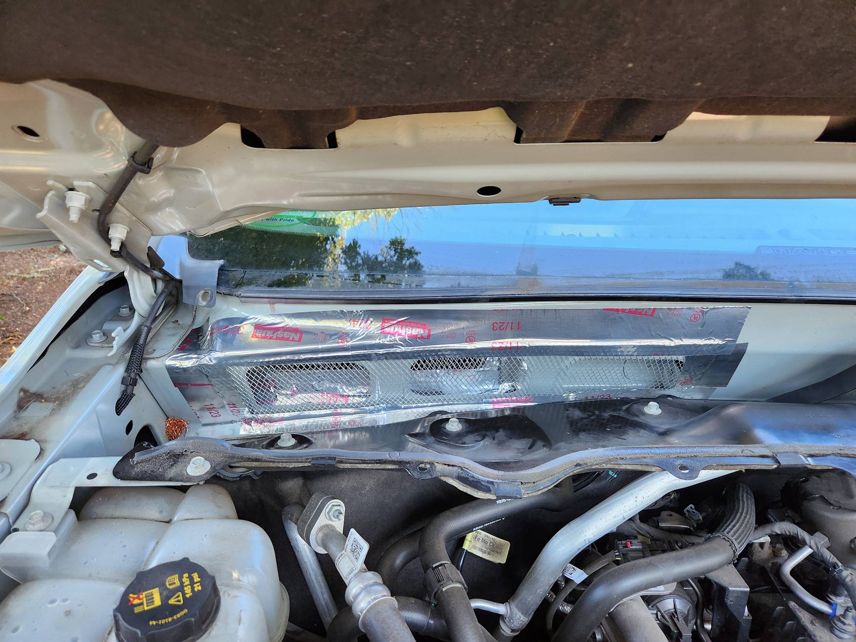

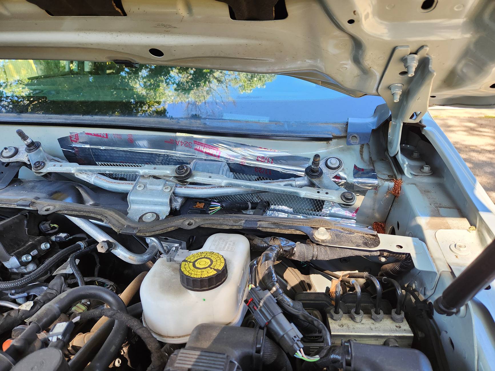

I also pulled the windshield trim panels that cover the windshield wiper linkage and motor (last picture), hoping I could put screens over the opening to prevent rats from entering, it would be a major task, not impossible, but would be a pain because there are 5 openings rats could get through, one would have to epoxy or glue the screens in place and on the driver's side there is not much room because of the wiper motor and linkage. If anyone has an idea, please chime in! I will be setting some rat traps out by my truck this evening, happy hunting!

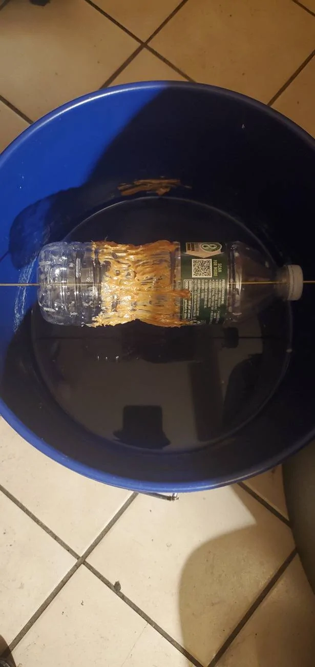

I live in the middle of no where so mice and rats are common, this year they are pissing me off, and Scooby has caught two this year, so I made buckets that have in the past worked very well, I put one on the back porch, one in my basement office, one in the kitchen in case there is one inside and one right next to the truck! its colder early this year so they might be moving around for winter...
A Lowes 5 Gal bucket, Coat Hanger wire, an empty bottle of water and fill the bucket 6 to 8 inches deep with water, put some peanut butter around the bottle when they step on it to lick they roll off right into the water and drown, the water is deep enough they cant stand on the bottom to keep their head up :)
the one year I was keeping track I caught 30 in my garage in two days! toss them out every few days refill the water, catch many for a few days without resetting a trap, reusable year after year, Pet safe ... cheap!
P.S I put a little peanut butter just above the water line and they try and hang from the edge with their back feet and slip and fall in because I have tried it without the bottle too and it works hahaha

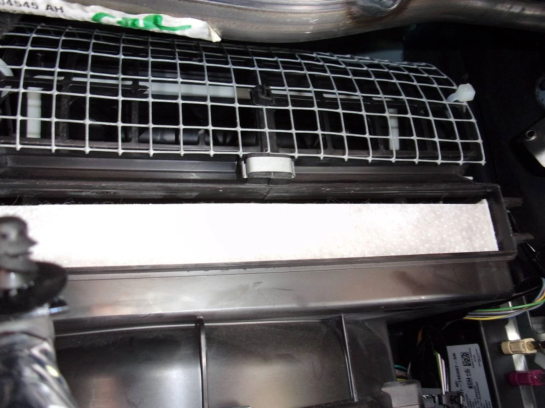

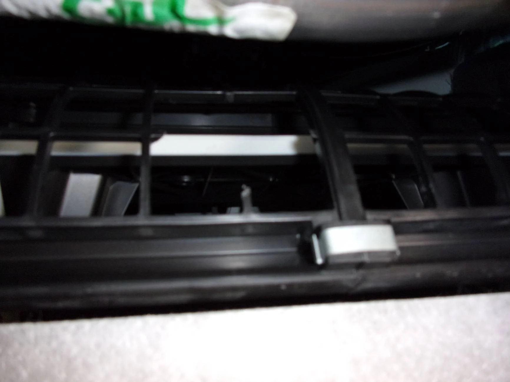

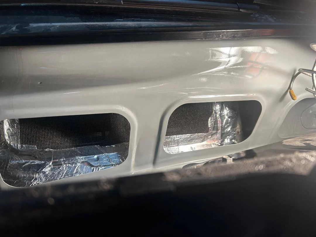

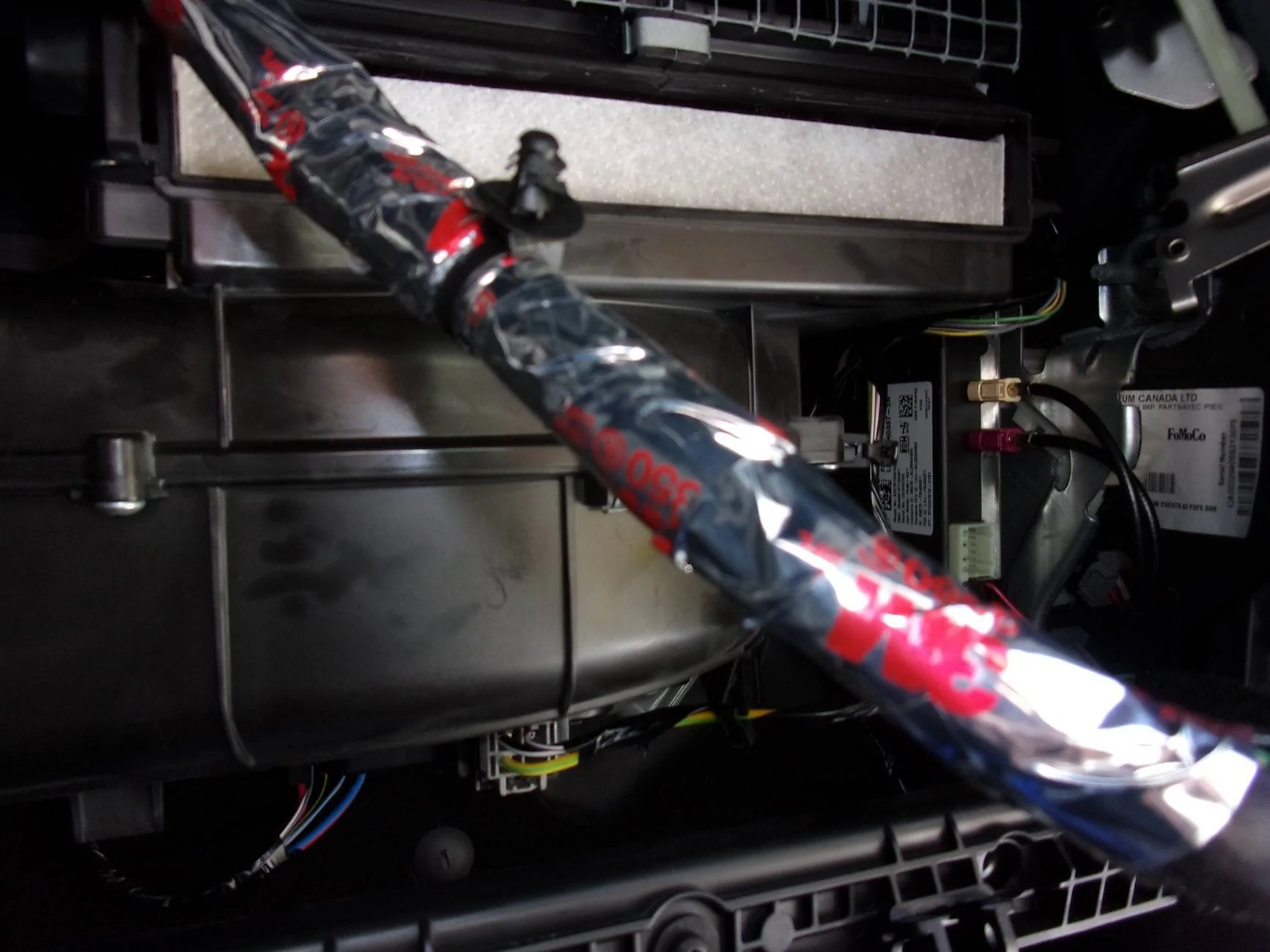

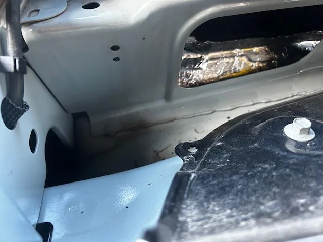

I mouse proofed my cabin today. It took about 90 minutes. I used 6" aluminum gutter screen that I found for $3 at the ReStore, and some leftover copper wool and HVAC tape. The cabin filter side is done in two layers, inside and engine side.
They'll attack the tape and defeat your metal screen...
