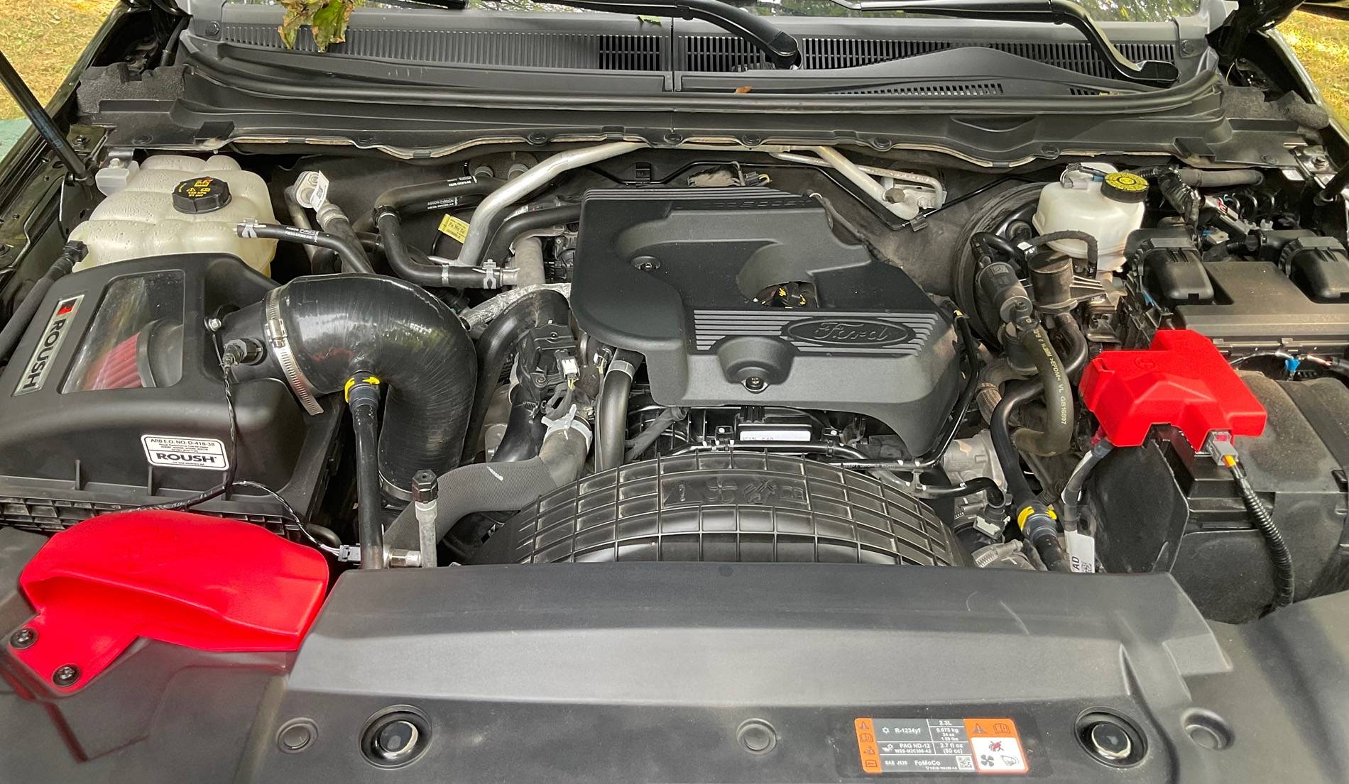

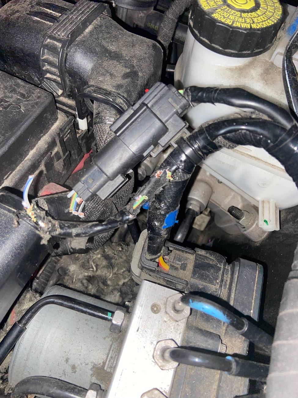

@shovelhd - after I cleaned my engine bay, I wiped everything down and let it dry and then sprayed down everything with the Doktor Doom solution, which is likely water and Denatonium Benzoate. Just a liberal misting on everything, including the hood liner, which was also chewed to pieces when my wiring harness was decimated. No wiping, I just closed the hood and let it dry. I checked a day or so later and it looked like I had detailed my engine bay - spotless and shiny new looking. ?
Living in the woods now I'm probably going to have to do this. Those are before and after pics of your engine bay just from spraying this stuff on there? I guess there is hope for my dirty engine after all. :shock: ?
No, I had the typical dusty engine bay - not super dusty like in AZ or some of the pictures on the forum. ? After I cleaned my engine bay, I wiped everything down with a microfibre cloth drenched in 303 Protectant ? ? ❤, let it do its magic, then sprayed the Doktor Doom - that other pic is just to show the rodent damage, but yeah, it’s a bit dusty.
Dang, Mine's dirty again and I thought I found an easy way out. :giggle:
