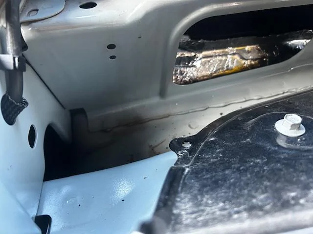

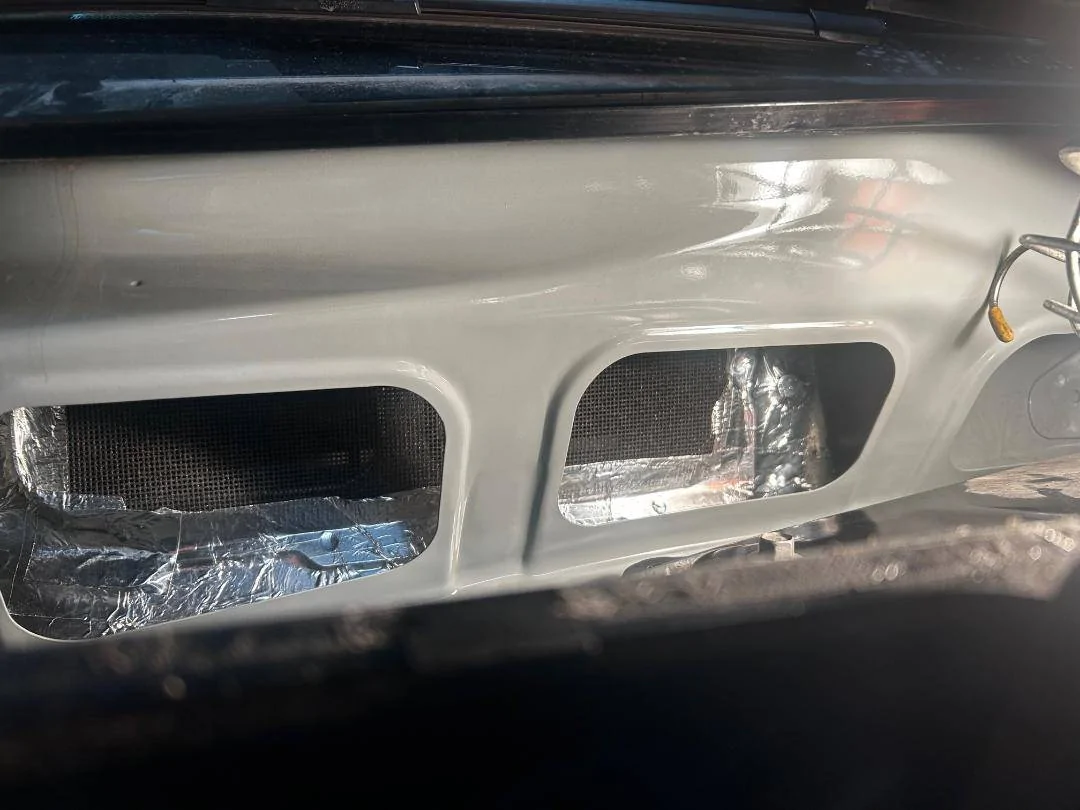

But to answer your question - The Cowl & The Rear Exhaust Vents are the entry points.
Just search through the threads:
Here is my added screen, just a drywall sanding screen - tapped in place
They get into this area from the - Cowl Drains on each side of the cowl.
Thanks for the information about the cowl drains. New information for me. Now I can get into the space beneath that cowl with a plan. All the best. Henri

Thanks. I could not see how they get into that space. I did not want to remove the cowl just to explore. Now I know there are two drainage holes that mice use to enter the space beneath the cowl. Thanks again!

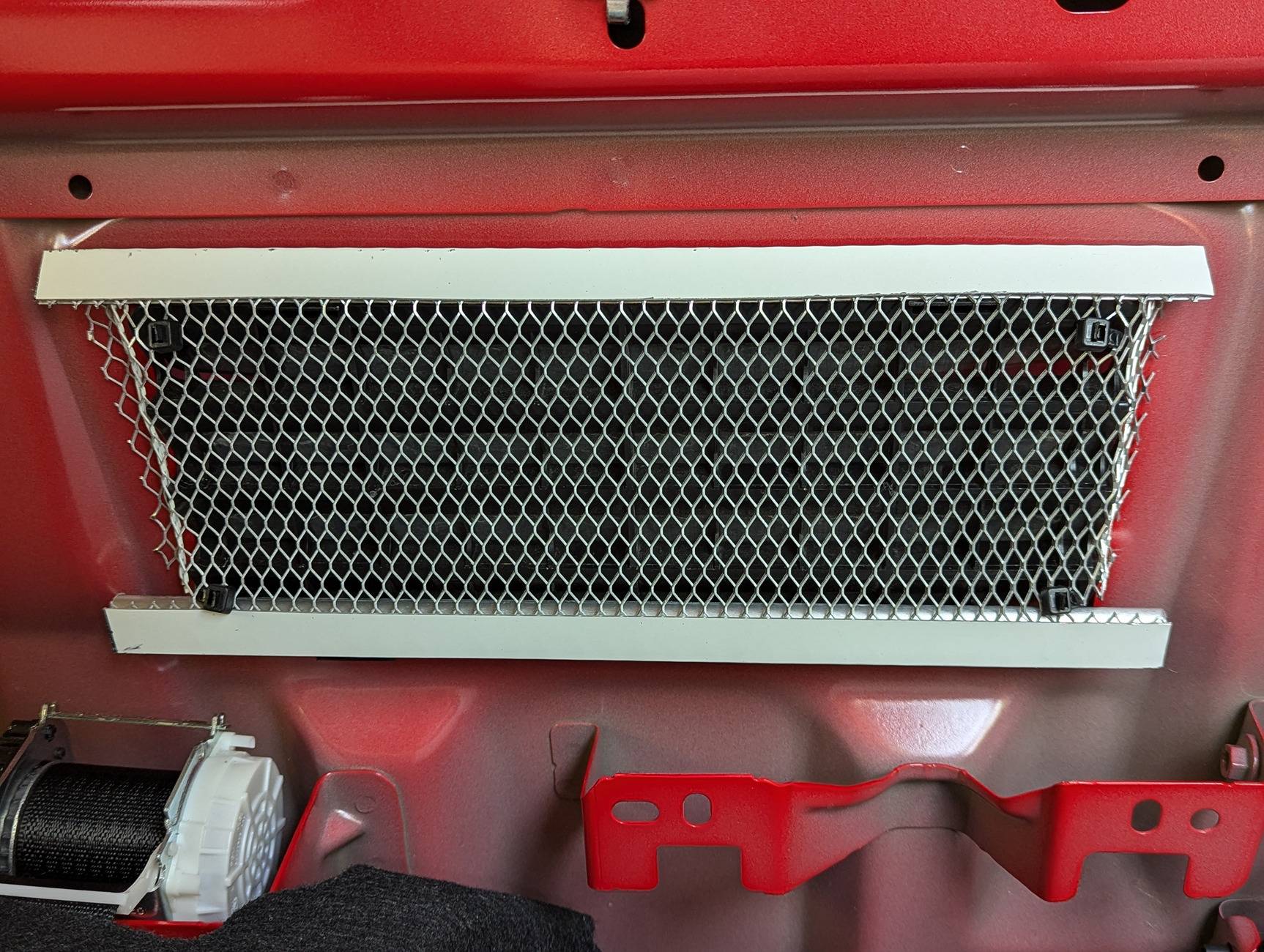

I did the vent behind the rear seat back with aluminum gutter guard that I purchased at my local Menards. I only had to do the driver's side, the passenger side is a solid blank on my '21 XLT. The screen is held in place with weatherproof cable ties that are wrapped around the vent slats at the corners.

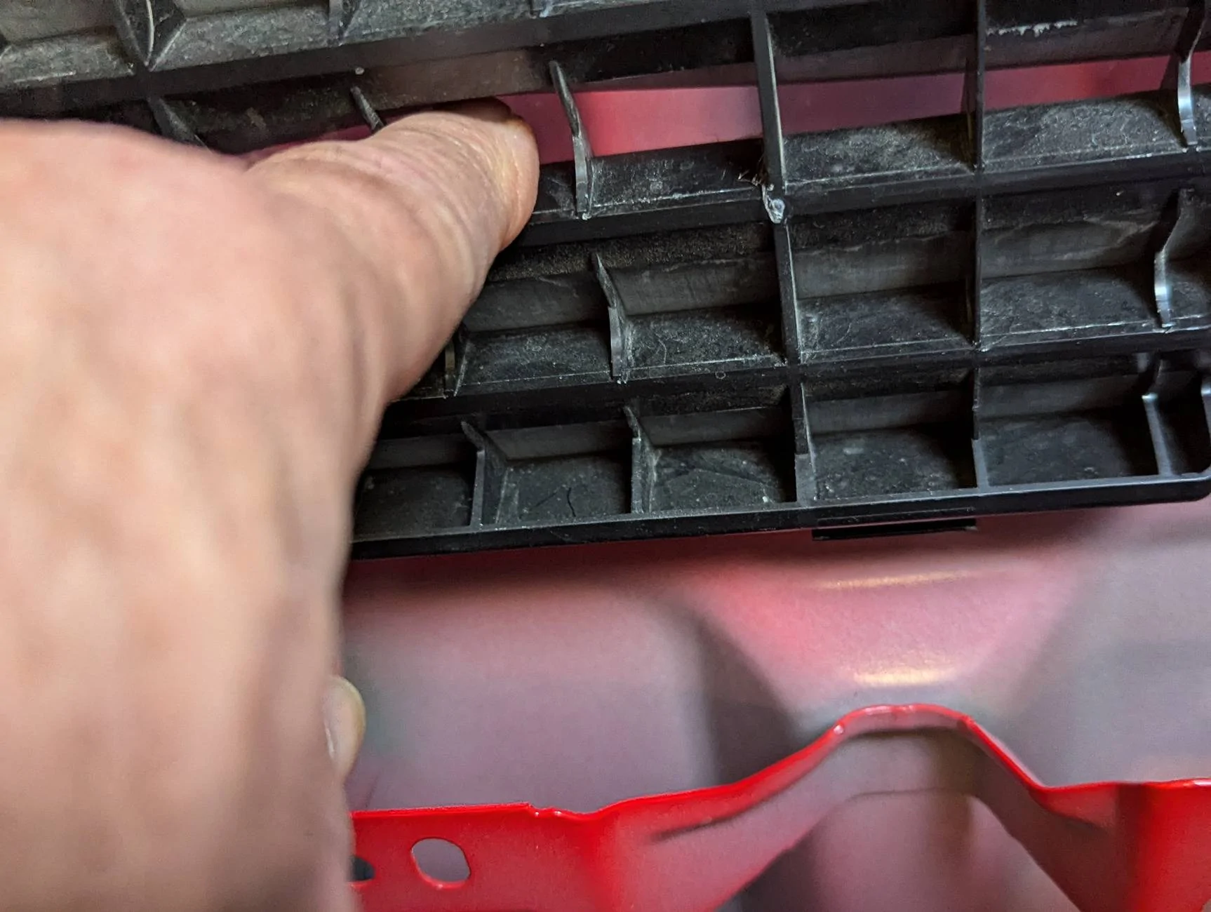

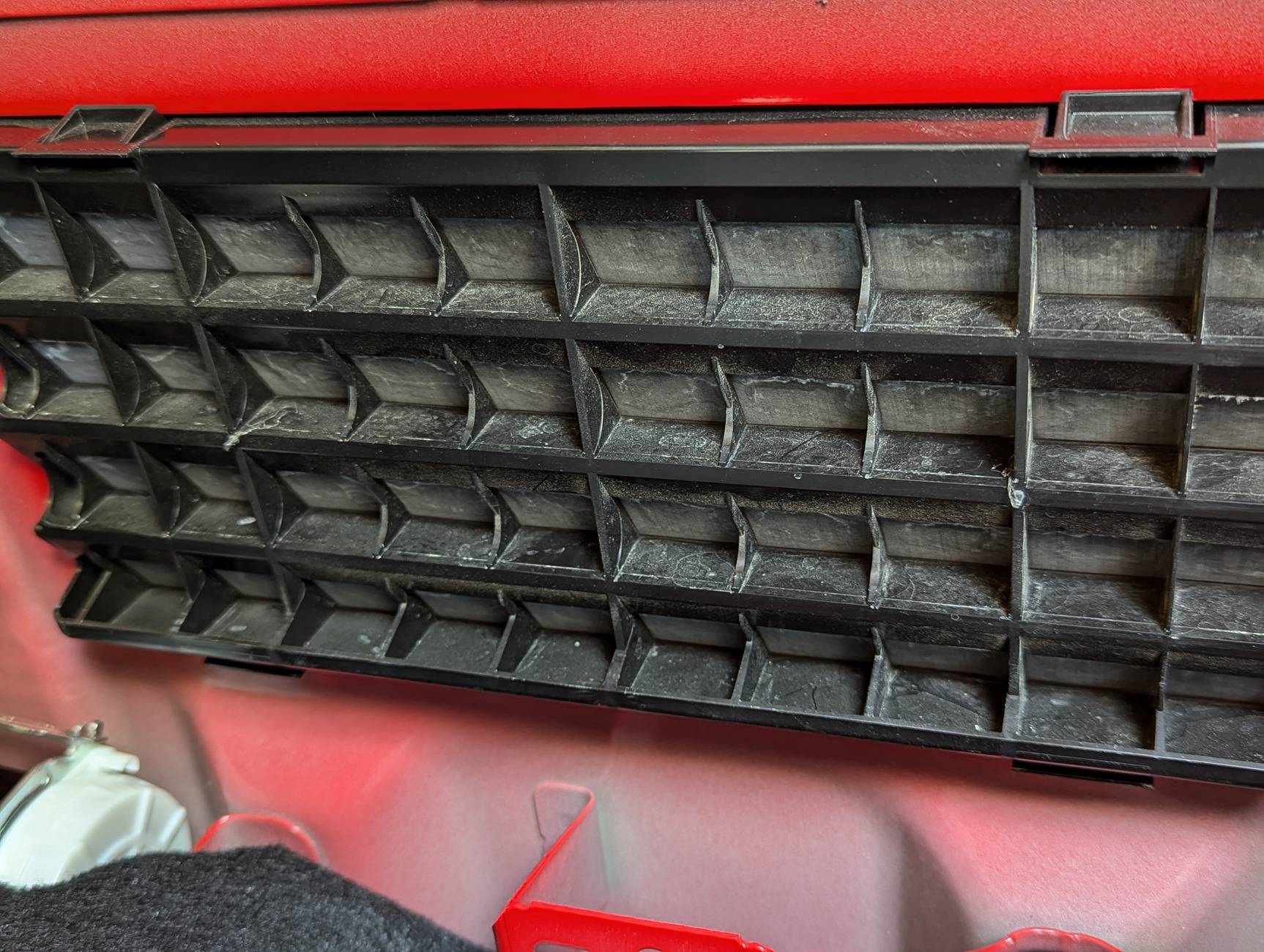

The vents are behind the carpet or AKA Loadspace Trim Panel, all Ranger's will have them.
Now some report only having 1 functional and it is covered up.
You can also see them with a flashlight looking between the cab and the bed.
Borrowed Pic:
Archer88
Henri
Nov 9, 2024
Ontsrio
Ford Ranger 2019
Borrowed Pic:
Thanks for taking the trouble to show this. I will look more closely. Those black vent opening are beneath other parts I have to remove looks like. Really appre

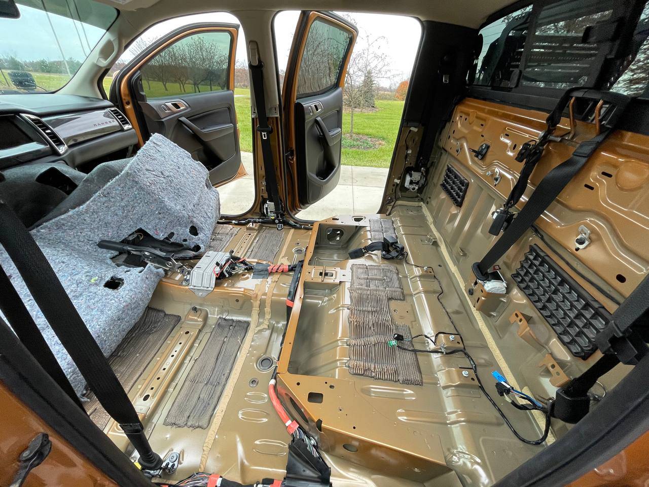

Remove the headrest on the rear seats. You should see a recess in the middle of the top of the seat back. I believe it is a 13 or 14 mm bolt to remove. After that the back pulls Out and up. On mine one vent is blocked off with a thick foam the other is functional. I’ll be removing the foam on the one and probably replacing with a sheet of aluminum like someone else did on here.
