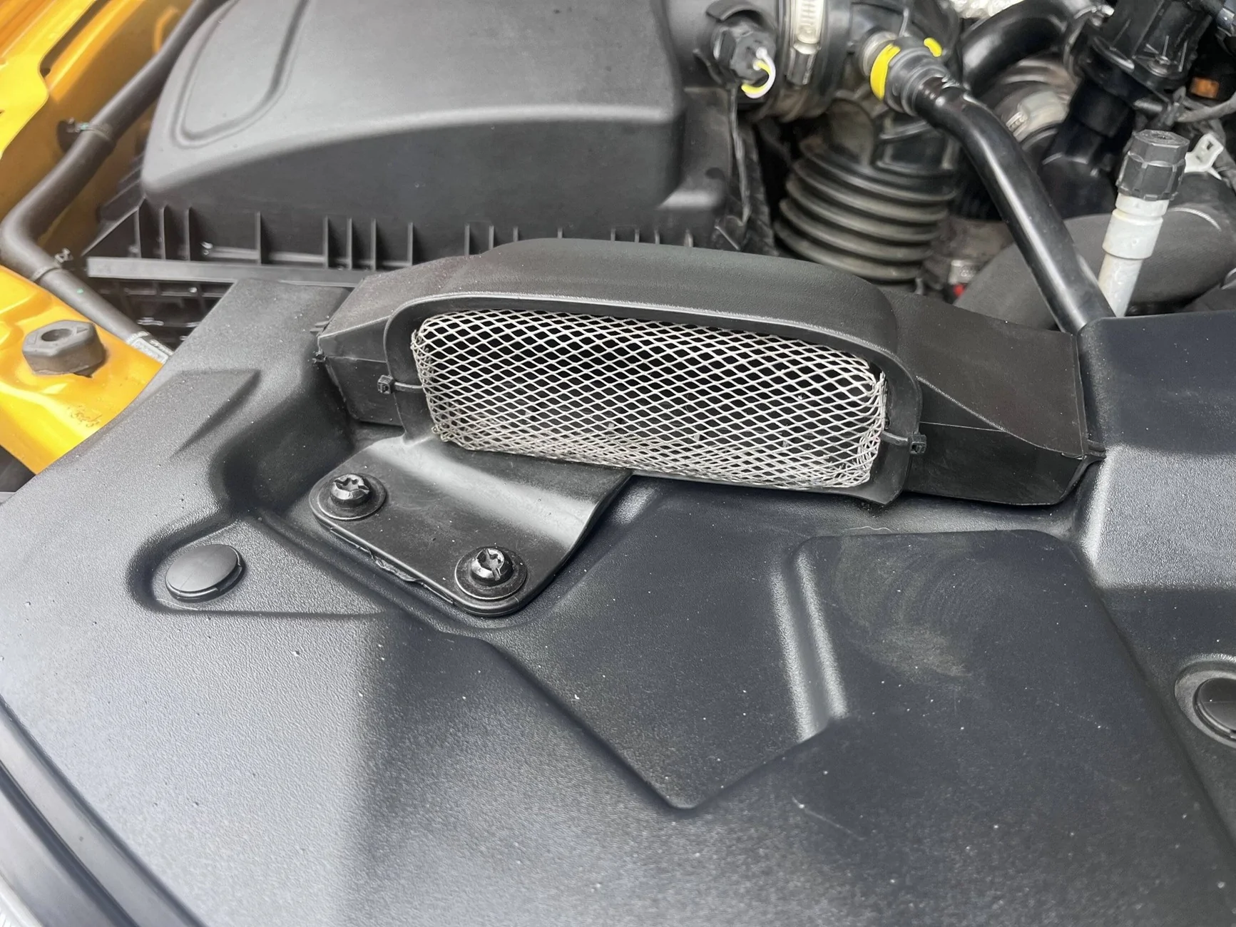

If you’re in an area with a lot of rodents and you’re closing off the cabin air intake because they’re already a problem, I recommend doing the vents. Removing the rear seats is easy and you only need a bit more hardware cloth.

Just pop the passenger side of the cowl... Here's a pic of the openings meshed over. These are lawn mower filters with the filter material removed, and mesh overlaid, then held in place with auto black adhesive tape. A 5 pack of filters for $8 at Amazon. I ruined the first one before figuring out how to remove the filter material - Hint:- use a razor knife and be patient. I formed the rubber adhesive tape over the back edge of the filter, and pressed them into place. The frame is not a friction fit by themselves, so an adhesive is needed to insure they stay in place. The tape stays in place once you press it into place.
This wasn't my idea. A forum member put me on to this method.
Or simply secure the mesh in place with aluminum duct tape. It is a tight space, just take your time.

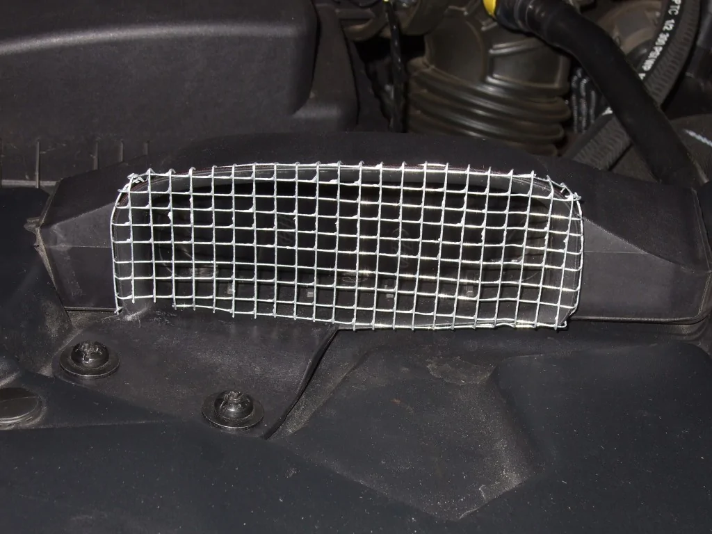

Here's my air intake. Mesh simply wrapped around the intake opening.

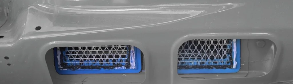

And finally follow this link to see the rear cabin vents sealed off.
I removed and reinstalled the vents from inside the cabin. Doors close a little tight, and folks worried about airbag pressure... I figure the pressure will exit through the AC vents.
At any rate the critters have no entry into my truck. And my road noise is less too!
