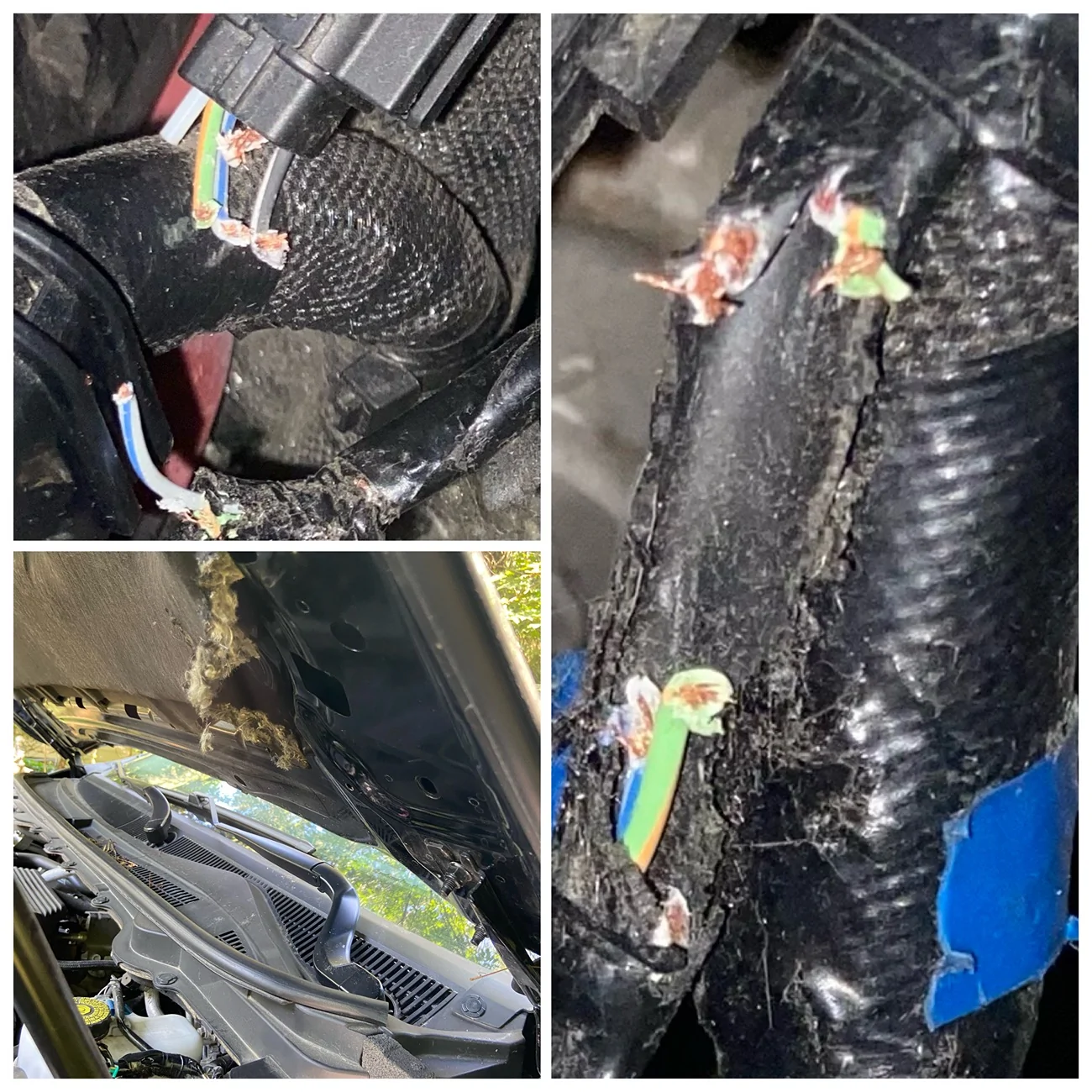

arrrrg. second nest on the battery blanket. don’t think it ventured inside this time … nothing in my peanut butter trap
cut the shredded bed off the top. then moth balls and peppermint
just wanna warn yall. this time i heard seeds and nuts in da hood
bed and breakfast. ?

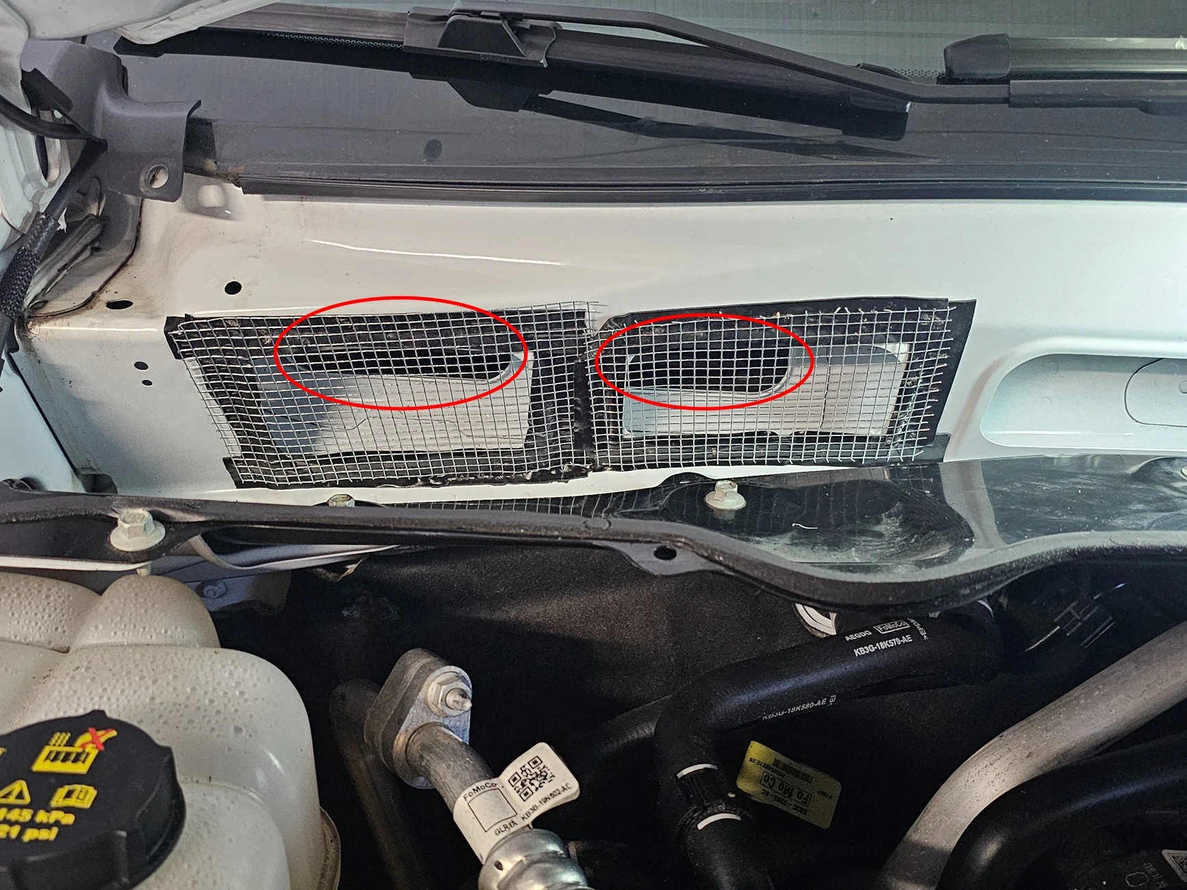

After sustaining $543 worth of damage to the passenger side airbag wiring, I went on a rodent proofing mission. You will need a Lisle Tools 54150 wiper puller if you have any hope of ever getting the wipers off. Why do I need to take the wipers off you ask? Because both wipers come up through the driver's side half of the cowl cover. You need the cover off in order to access the oh so convenient rodent access holes that Ford nicely left open in the fire wall. The passenger side is very easy since you just need a small screwdriver to undo the black plastic clips holding the cowl cover on.

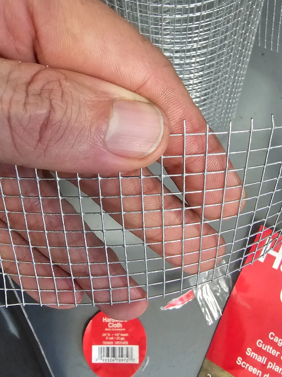

Mark the wiper blade postions on the windshield with masking tape before you start. The passenger side wiper came off sounding like a small .22 going off. The drivers side just slowly came off. I used 1/4 inch mesh, 23 ga hardware cloth from my local hardware store (part of the Do It Best hardware group). 3M/Scotch extreme mounting tape (can be purchased in store at Walmart or online at walmart.com or The Amazon). Get the big roll, not the dinky one. Ask me how I know. When done, I sprayed everything in the cowl & under the hood with denatonium solution (purchased on Amazon).

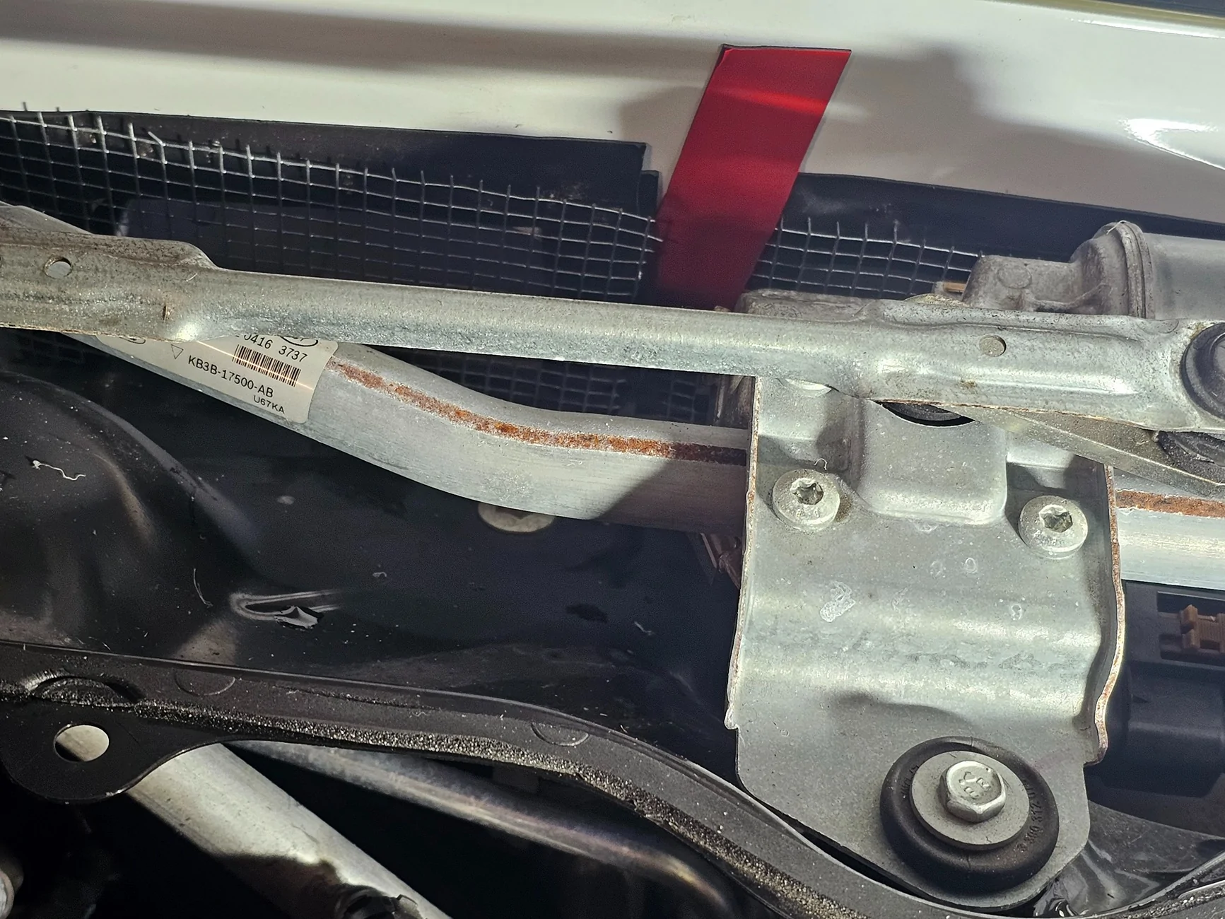

This was not a fun job between running out of tape the first time due to the small roll I bought at first, only being able to complete the passenger side at first since the wipers prevent you from doing the driver's side, having to weasel everything around the driver's side center hole because the wiper motor is in the way, and it being very tricky to get the red release film off the tape once the pieces are in place.
Pictures attached. I really hope this works. I will mess with the cab vents behind the back seats another day.

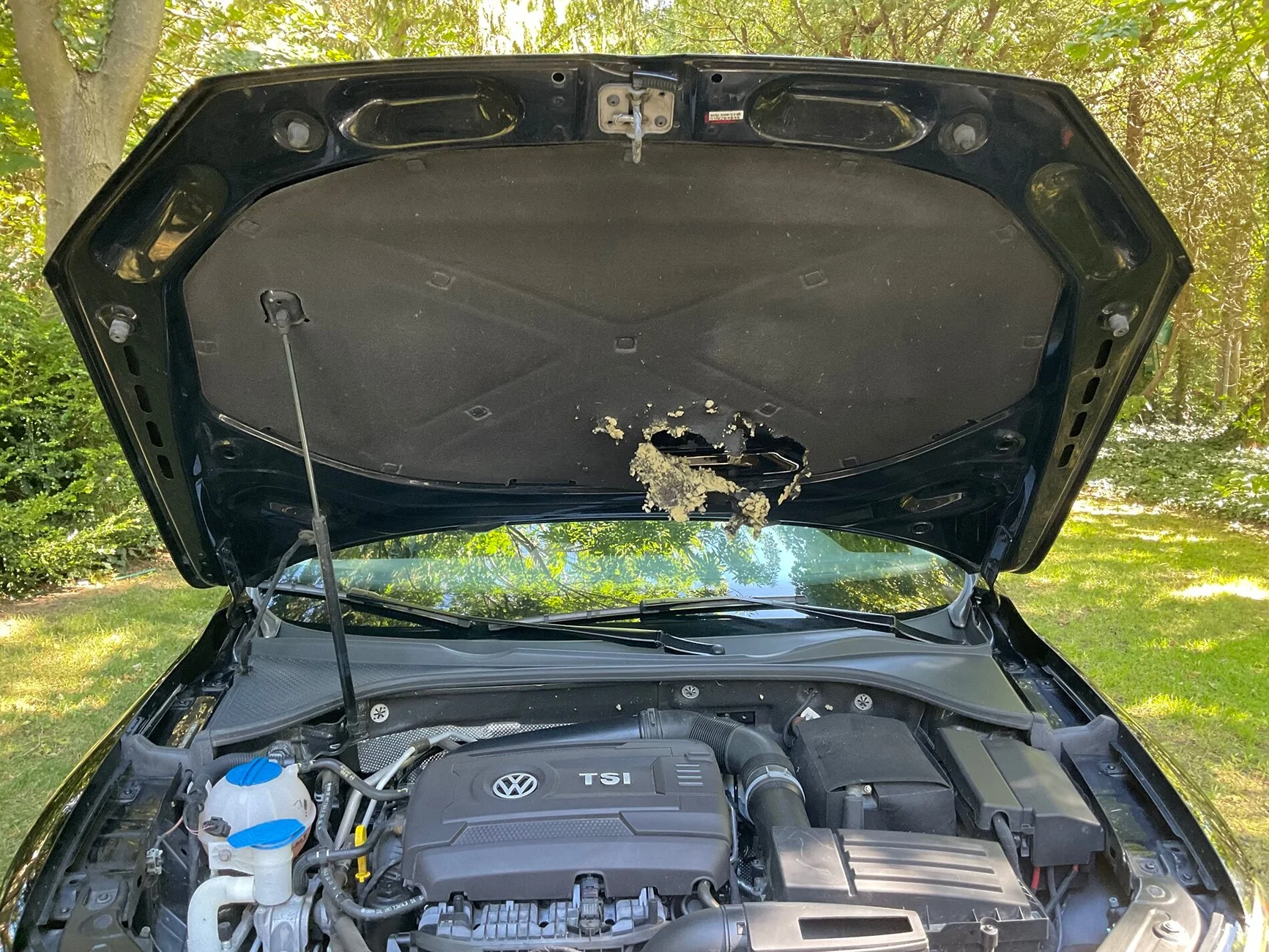

I hates meeses to pieces. They got to the hood insulation in my Passat. Then, they got to the hood insulation in my Ranger and chewed the heck out of a wiring harness. If all they did was make a home in my air cabinet filter, it might not seem so bad - however, they carry way too many diseases. Folks who live in the southwest know all too well about Hantavirus. They are gross little critters.
