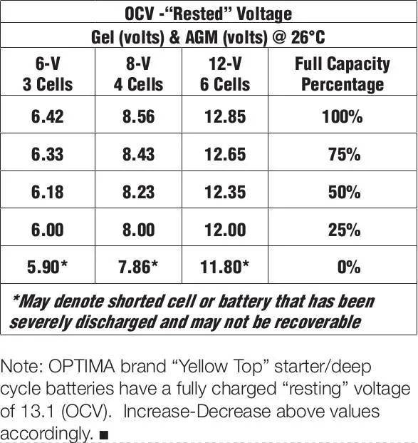

After a week on the BM desulfator my 2020 Ranger battery is showing remarkable progress. Note that this is NOT a rested reading. I did not test the battery before putting it on a charger and topping it off. I did test it after the initial charge and a 24 hour resting period.
Initial Results
Voltage = 12.44V
Internal Resistance = 4.24 mOhms
CCA = 603.2
1 Week Later
Voltage = 12.96V
Internal Resistance = 3.26 mOhms
CCA = 904.8 (well above its rating)
Charge of AGM battery based upon Resting Voltage
Based upon the above chart(an excerpt from the BM Desulfator user Guide) my Ranger battery was at a 57% charge 24 hours after charging to 100%.
I am going to leave on the battery maintainer for the next week to keep the Desulfator active. I'll record the results after allowing the battery to rest. Then remove the maintainer, and let the desulfator do its thing while the truck is running.
Remember, the Desulfator is only connected to the battery (no external power), and only desulfates when the alternator is charging the battery at =>13.5v. Once the charge voltage drops below 13.5v the unit goes dormant.
