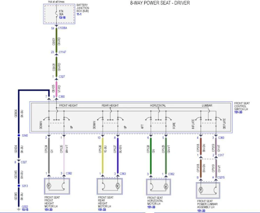

it needs some wiring to get power to it either by the fuse panel or if you have the higher end dash harness for duel climate control you could try hooking into the side harness.
As long as you (NOTE) that this is a 30-Amp Fused circuit and 14-Gauge wire to feed the connector.
So, if adding your own power via battery or fuse box tap from a not used source - ensure you have an inline fuse and 14-Gauge wire, with this being a high amp usage item, it needs its own circuit.
If the (Truck) harness side has the needed wiring, its easy and just need a Power Seat if not you will have to run your own to the connector.
There are (4) Total connectors in the circuit

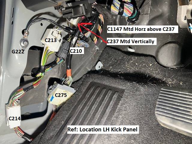

For Ref: C327 is the main connector under the seat

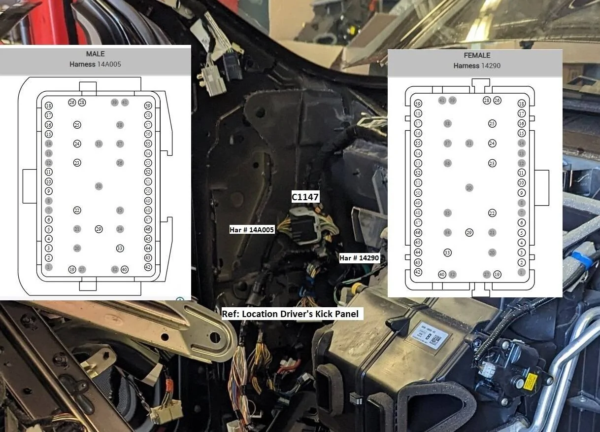

and C1147 is here
Note: C1147 is limited access and can barely see it
So, I have a hunch that C1147 Pin #23 will be the termination point and not extend out to C327, a quick way to see would be check the C1035A connector and check if Pin #54 has a wire in the cavity - if yes then C1147 has the needed wire feed to extend downstream to the C327 connector.

C1035A (BJB) (Note C1035A = The Inboard Connector)
Seat Power
Driver's Seat = Pin #54 from fuse #74
Passenger Seat = Pin #55 from fuse #70
So, if wires are present in these cavities, you have power running to (Female-C1147)

However as stated above C1147 is buried and hard to see with the dash installed
Seat Power
Drivers Seat = Pin # 23
Passenger Seat = Pin # 29
So, if the C1035A connector is pinned then the (Female) side of this connector is also pinned.
The question is: Is the (Male) side of the connector pinned or does it terminate at the female side?
If the (Male) side is pinned, then the C327 (Dr) & C320 (Pass) seat connectors should be pinned

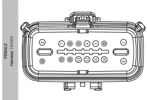

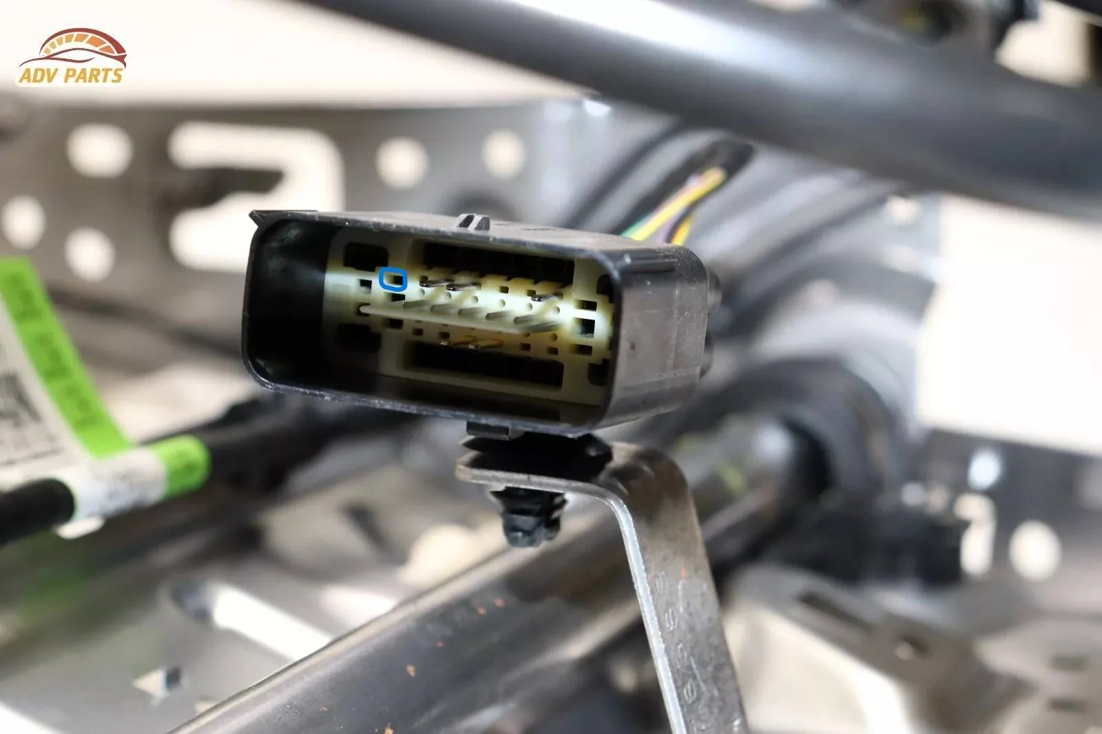

Ref: C327 Connector (This is Seat Side) for a manual seat as a reference and shows what pins are missing from the (Seat Side)
The unknown is - yet to be confirmed is: The (Female - Truck Side) connector wired for the noted missing (not pinned) in this connector
Starting at Blue Circle - Top Row (Left to Right)
Top Row
Pin #1 - Switch Power - Missing
Pin #2 - Not Used
Pin #3 - Dr. Buckle Switch (You Have)
Pin #4 - LF Seat Track Position Sensor (You Have)
Pin #5 - Not Used
Pin #6 - Not Used
Pin #7 - Grd for Seat Track Position & Buckle Sensor (You Have)
Pin #8 - Grd for Seat Switch & Heater Mat (Missing)
Bottom Row:
Pin #9 - Heater Feed (Missing)
Pin #10 - Heater Feed Return (Missing)
Pin #11 - Heater Sensor (Missing)
Pin #12 - Air Bag (You Have)
Pin #13 - Air Bag (You Have)
Pin #14 - Not Used
Pin #15 - Not Used
Pin #16 - Not Used
Note: Not Used = Not used and is an empty cavity
So, you need the other side of this connector to have the (Missing) wires, this is the one coming out of the floor carpet up to the seat.
If they are missing, then you will have to run you own wiring to Pins 1 & 8 or direct to the seat switch and by-pass this connector (if you are only wanting) seat power
