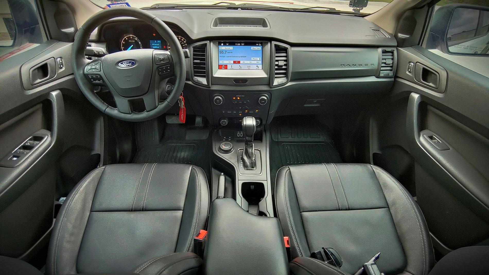

I swapped power leather into my XL from lariat. Happy to help if you have questions- The harness under the seat will fit, and if your truck is not equipped with power for the seats, it very easy to simply run power to them.

I'd be happy to help- there's only 2 connections required for power and ground. The best thing to do is send or post a pic of the wiring harness you presently have under your seat- then cross-reference the new seat. If I remember correctly, the power wire for the seat motors are purple. Simply run 20A power to that circuit and you're in motion.
