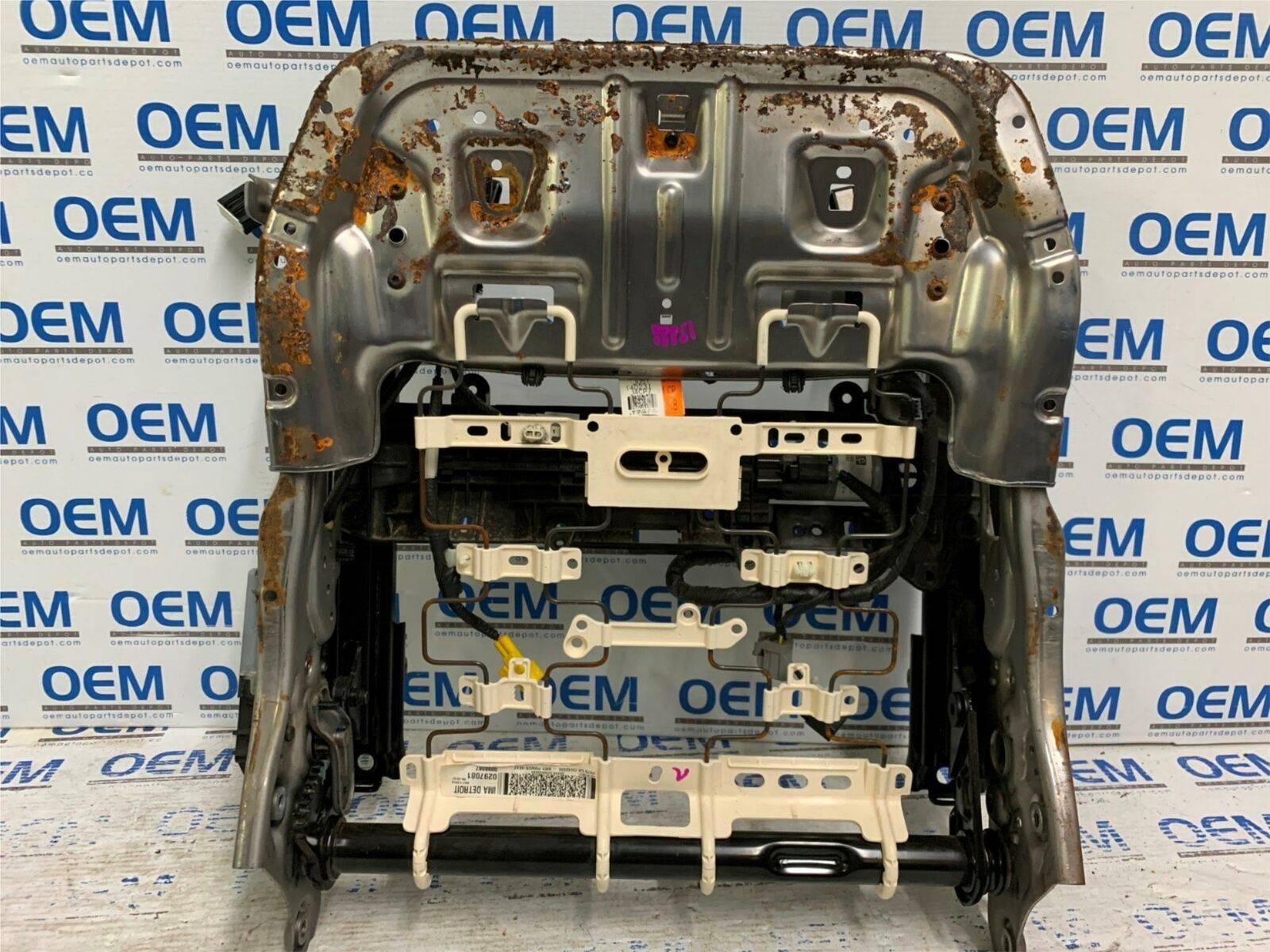

Something like this - an actual pan, eliminate the springs or give the springs support under them so they will not sag downwards.
This IPC is from my last vehicle which I drove for 15 years, Note Item #8 is the seat pan, the cushion itself provided all the needed support, the Ranger has a combination of a cushion and spring , I tried the cargo straps (x2) and interweaved them in the springs, you feel the straps.
The main issue is that the center of the spring mat inherently forms a V when you sit in the seat, so your tailbone always sits lower than your but cheeks. that is what I have found to be MY ISSUE with comfort.
Its hard to explain unless you actually open it up and place you hand on the springs.
Example: If you were to place your hand on the RH Side of the spring mat - it creates a slope downwards on the RH side - so if you picture you sitting in the seat, now you are sitting sideways (Uneven - Unlevel), this strains the back, so in a turn (roundabout) when your body weight shifts it feels like you are sitting on a uneven seat.
So I may revisit this someday and come up with a way to dump the seat spring assy or fabricate a seat pan that will stop any deflection (a solid surface)
or I may try - a cargo strap (Horizontally) across the back side as I only tried placing them vertically.
Now I am brain storming ideas again and may have to sidetrack my remodel project - Grr
May try a (Ace Bandage) temporary and wrap it tightly around the back side of the spring mat - Simulate webbing
