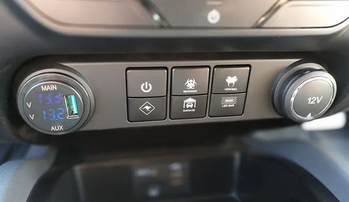

    Light force fascia installed!

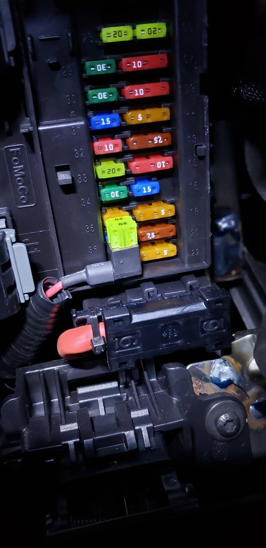

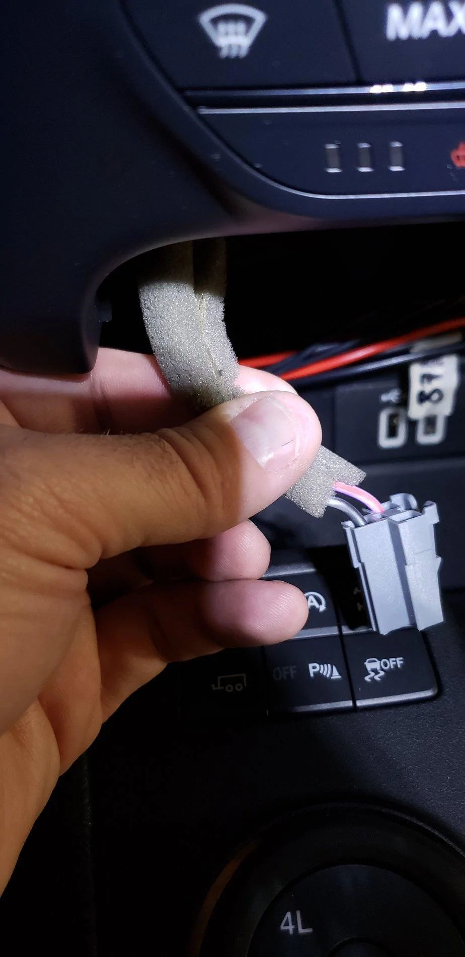

    What wire did you connect to for the switch background light and did you simply unplug the PowerPoint and plug in the volt meter/USB charger?

    Add a fuse tap on one of the spares. Yes.. I added a tab insert to the wire lead ends of the USB/voltmeter and inserted it to the existing plug and electrical taped it off.
