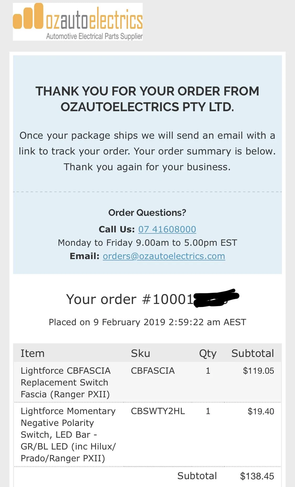

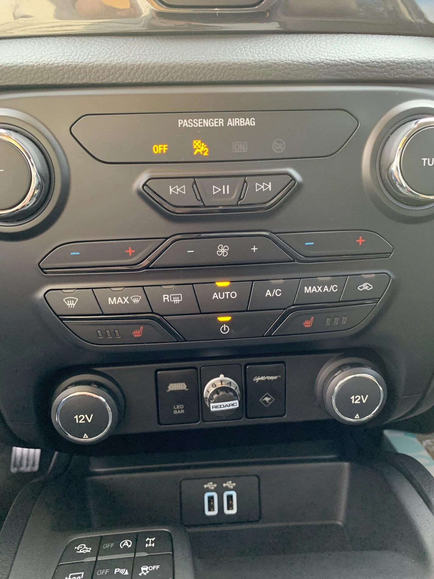

Saw the old fascia switch post and noted that the rep from Lightforce said that the only modification would only be needed if the NA Rangers had a dual usb port where the left 12v socket is. Since they ended up just having two 12v like the global Rangers, I decided to take a chance and order the fascia from Australia. I ordered from https://www.ozautoelectrics.com/ and paid $118 AUD and $35AUD for shipping and took 5 business days to arrive here in California.

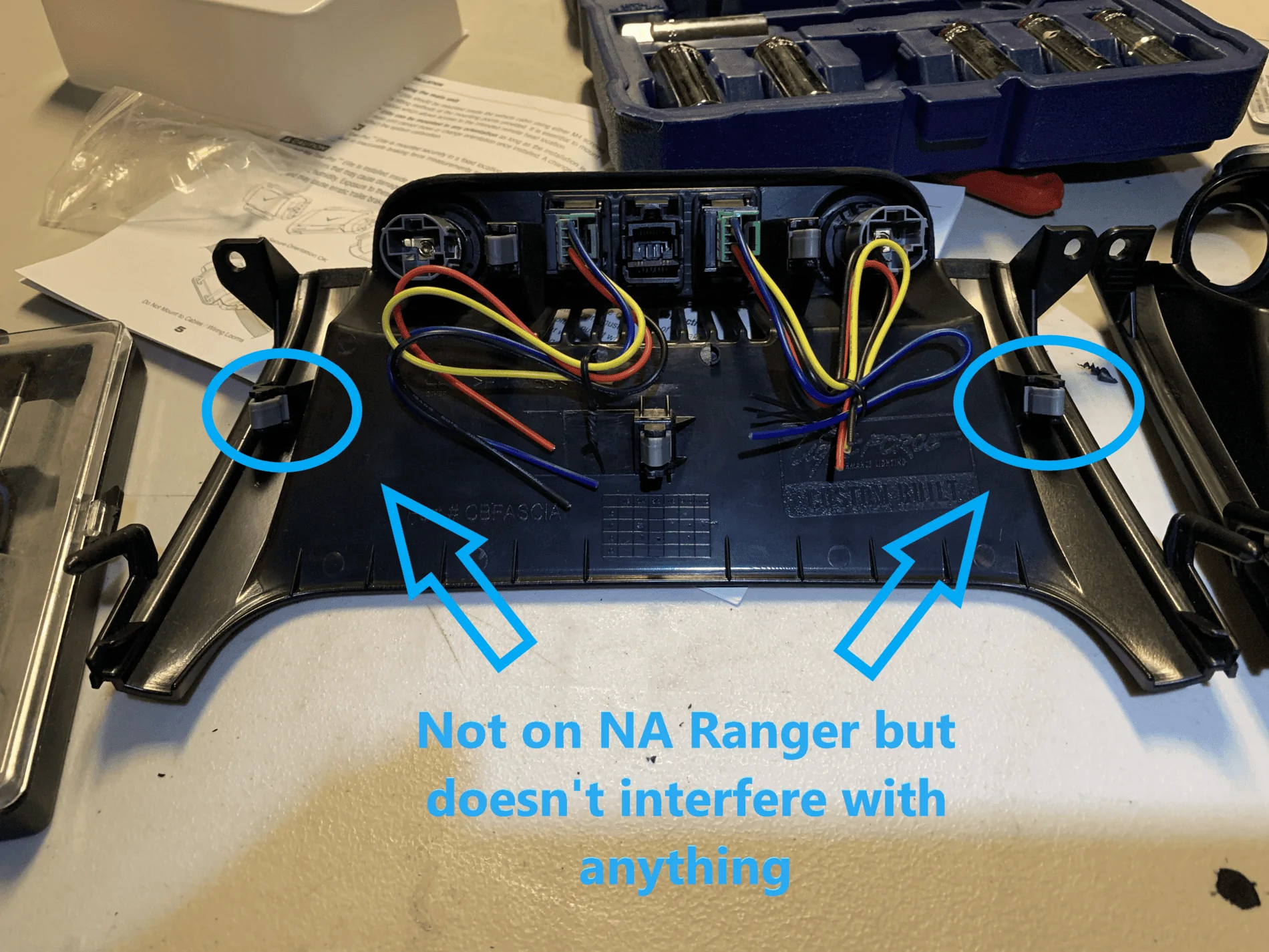

I found that installation was exactly like the Lightforce install video for our Rangers. So I'm not going to go into detail with it.

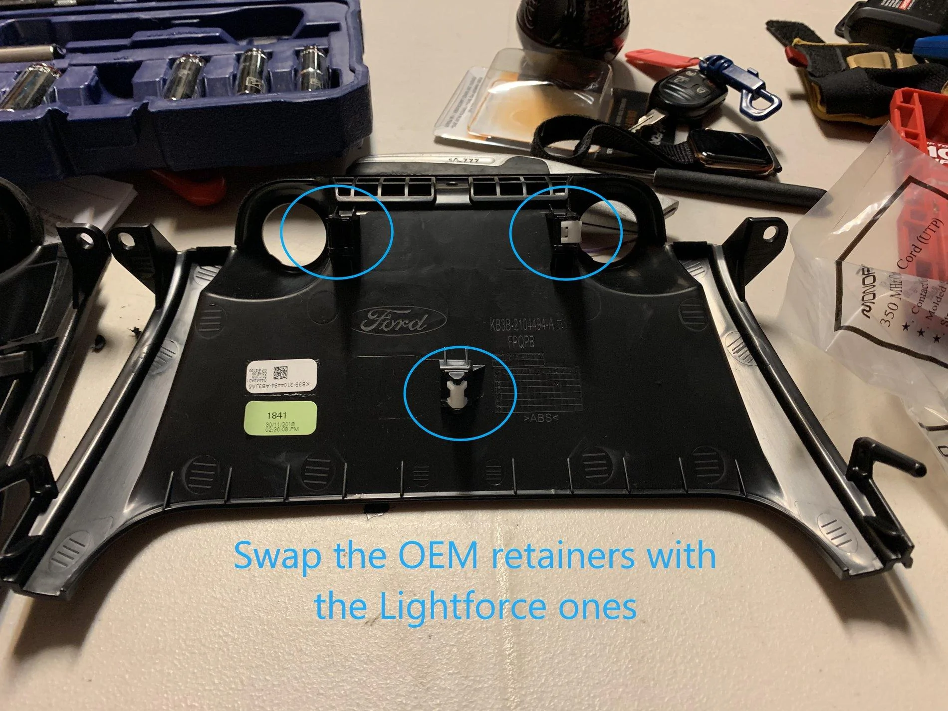

A tip I could give for those planning on doing this in the future, swap out the gray Lightforce retainers that come with the fascia with the white OEM ones from your original fascia. The lightforce ones didn't seat properly and had some trouble setting it in securely. I took it out, reinstalled the OEM retainers and they snapped right in :handsinair:

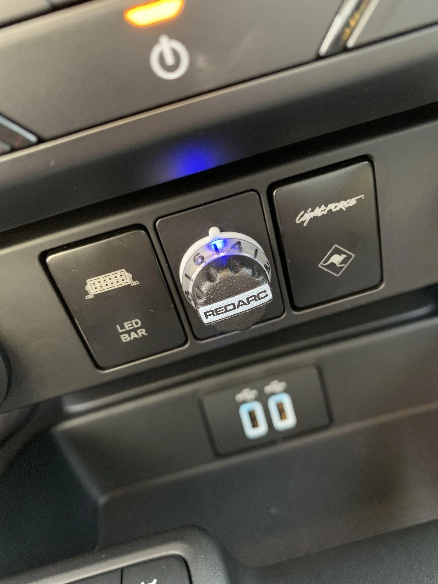

Very pleased with the product, my wife thought that the switch panel came with the car when I showed her the remoted control unit for the brake controller. All edges sit flush agains the side panels and the brake control unit is in the perfect position for where I wanted it to be. 12V flip cups work and function properly like before.

Whoa nice!
Does this mean you can provide a write up for install the Redarc as well?
FYI $153 Aussie is $108 US and $143 Canadian for everyone else
Yep! Planning to later today!

I love modifications that look like they came that way from factory. Great write up!

Do you have any tips for getting the trim pieces off either side of the fascia to get to the necessary bolts? I can’t seem to get those off. I know they just pull off, but it feels like I’m about to break the tabs on the back.
Thanks!
Jda1981
JD
May 28, 2019
46
64
Pipe Creek, TX
Just pull straight back on them. They are pretty tight but they will let go. There are a ton of clips in there.

Where did you run your wiring from switches to battery and lights? Did you go thru the firewall into the engine bay? If so, where? On the Ford Raptor there was two ways to get into the engine bay.

Did it come with those 2 extra switches? I clicked their link that said see which switches fit and I got an error message. Also did you have to buy any extra cables for anything? Their info stated space may be an issue on some vehicles so the extra cable fixes that. Also the etrailer site states that you can buy a direct plug in harness but didn't see it. I will call the tech support before I order anything. I'm up for a self install if it doesn't mean cutting a bunch of oem wires etc.
Although I don't have any extra lighting anywhere, those 2 spaces could be handy for later on or at the least have snap in hole covers.
