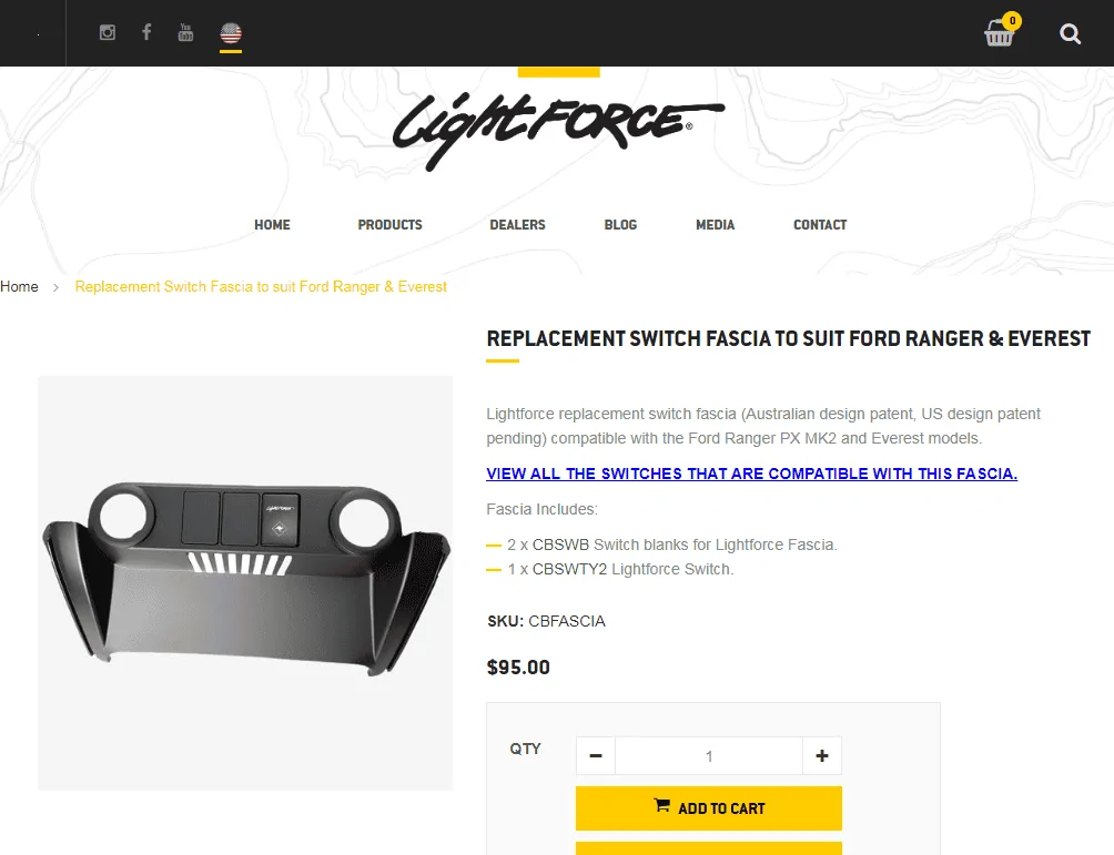

They are on the website and available for order. I was the first to order off the website and it has a glitch as far as adding email and shipping address. It's best to call directly and speak to Brian in sales.. he will get you set up. $95 + $5 shipping.

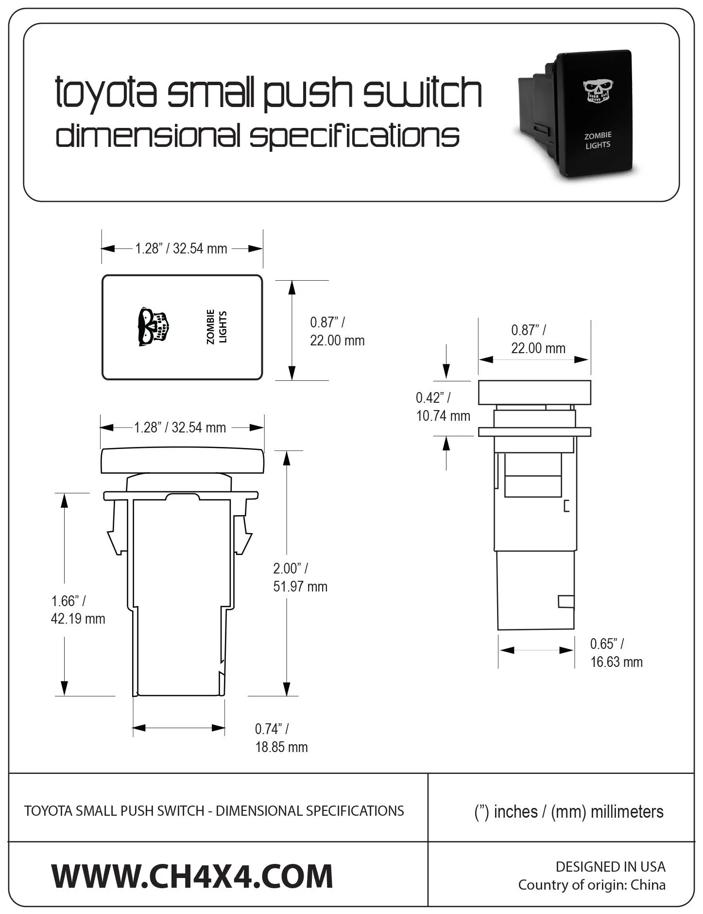

The switches used are the aftermarket generic type used on the Toyota Hilux, Prado, Landcruiser etc.. they are available all over the internet. Pay attention to the dimensions shown in the photo below as there are 2 different sizes of toyota style switches out there. Can even be customized. Here are a few links. Does appear lightforce USA does not have them on their site yet- their link kicks you over to the AU site.
https://www.ebay.com/i/222649885315
https://www.ch4x4.com/product/ch4x4-custom-laser-etched-toyota-small-push-switches/

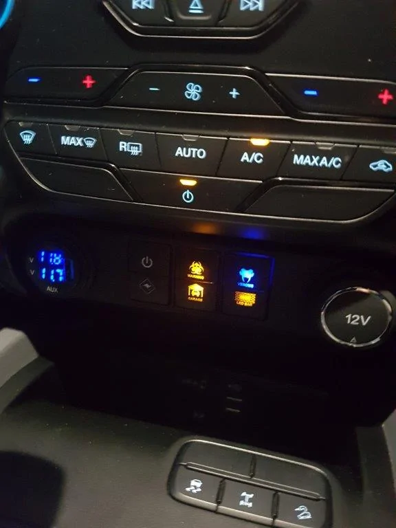

Garage door remote (as I don't like it stick to the visor)
LED Bar for the front (yet to install)
LED lights in the front grill (yet to install)
Reversing light
Front locker
One extra for just in case (probably compressor)
So, for the garage opener, is it an actual remote or does it need to be modified or connected to something else? I need 4 so the stock visor with 3 isn't enough for me.

It's just a momentary switch that is connected to the actual garage opener
Open up your remote solder two wires one on each side of the micro switch job done!
