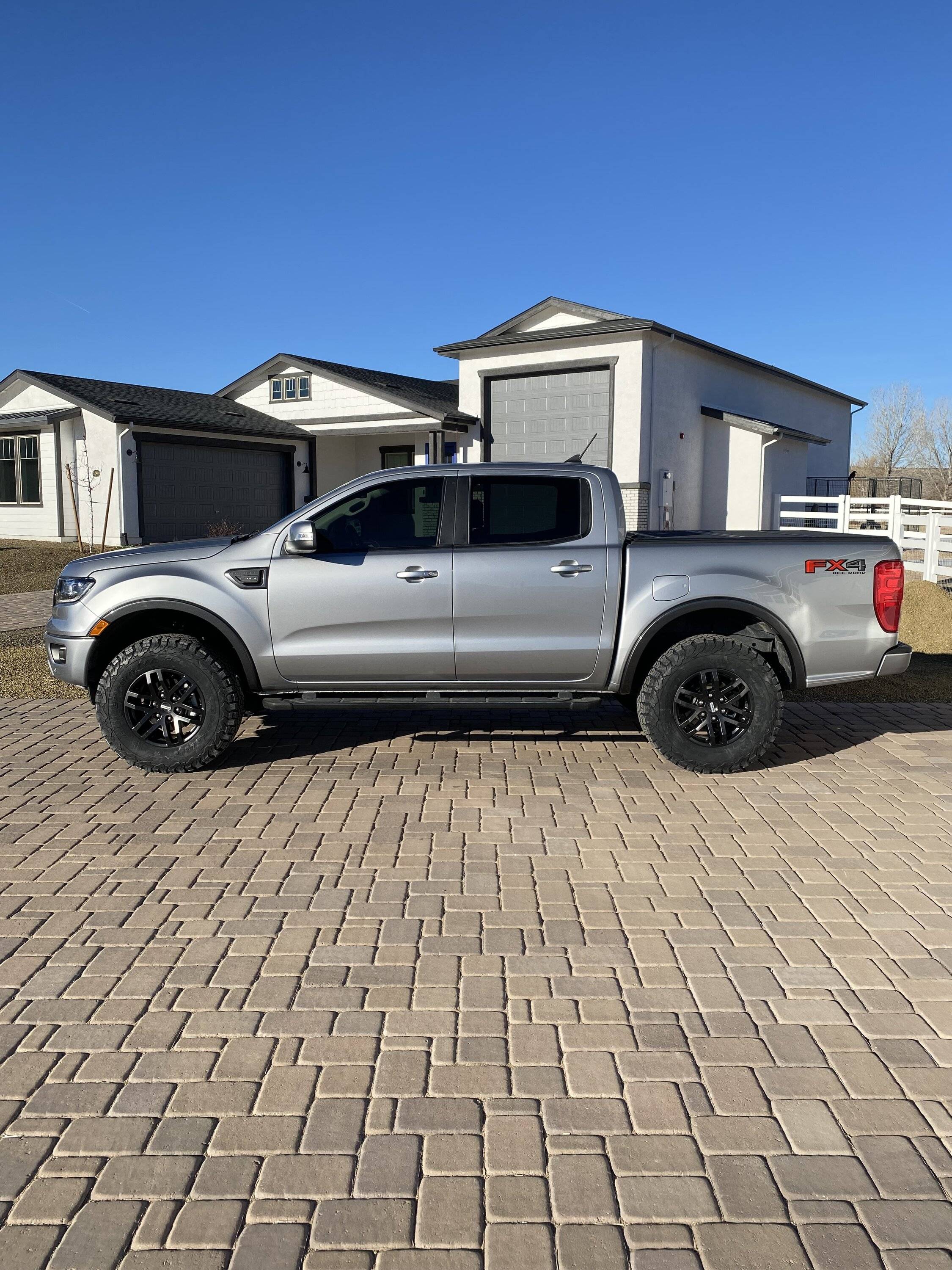

Before: front - 37 1/4”
Before: rear - 39 1/8”
After: front - 38”
After: rear - 38 3/4”
Not sure where the 3/8” went but I like the look.

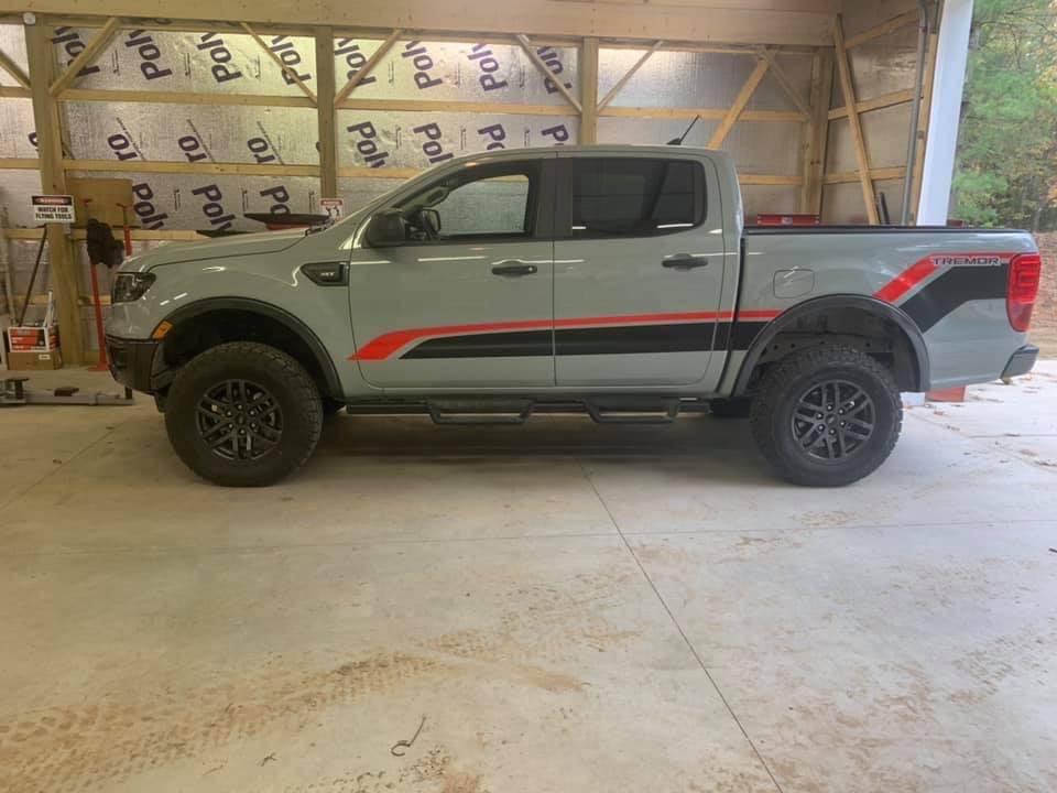

I just had the Ford Ranger Lifts 1" level installed on my Tremor and wanted to add another pic for those considering the kit. There's still a slight rake (about an inch) but I think it looks perfect!

Appreciate the response. From what I'm seeing on here if you level the front it will actually also lower the rear slightly. How much it lowers is my concern because mine has 2 3/4 from front to rear so if raising the front an inch would actually lower the rear by a 1/2 to 3/4 I would be very happy with that. Sucks you had to get rid of your truck. I'm sure was a hard decision to make. This economy has made many have to make some pissy choices they shouldn't have to.

Raising the front wont lower the rear ride height at the wheel well, the rear bumper will be lower, but the rear springs will still be the exact same height.
