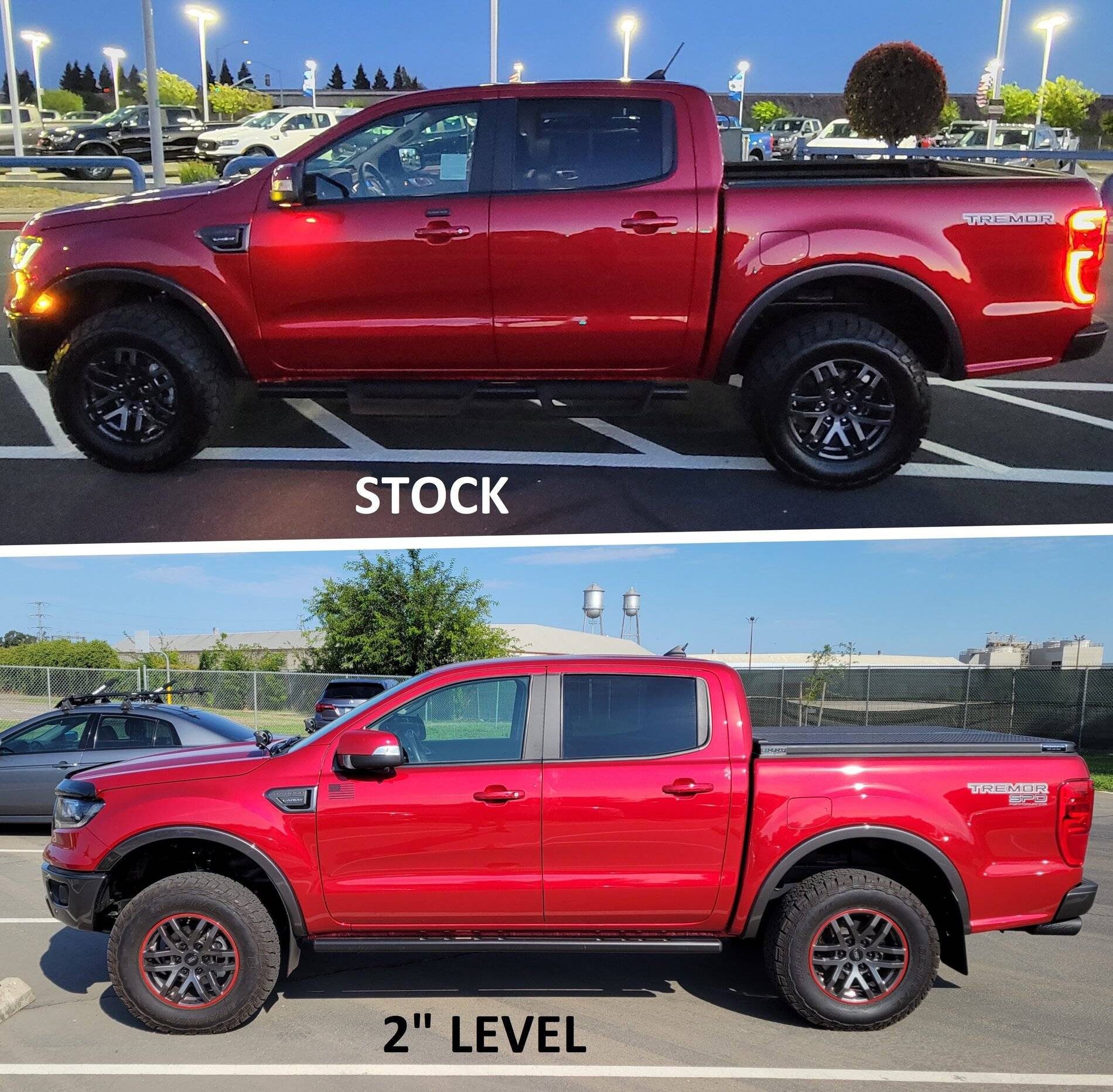

@Robby887 just added a 2" Tremor level. I ordered and will take pics once installed, though it will look better with my bumper and winch installed.
wow... great, going with a 2" level kit ... l have been looking for one myself ... what brand 2" ... is this a special kit made for the Tremor pkg ... from what l read no manufacturer makes one for the Tremor pkg due to the already .8" higher ride height and at most recommend only a 1" level kit ... using a 2" level kit ... they feel would take the upper ball joint to its max limited and possibly stress the ball joint since using a 2" level with the already increased .8" would be like a 3" overall ...
update ... if l read it correctly from the manufacturer ... they're recommending the 2" level kit if you are adding the winch bumper and winch which is adding from 250-400 lbs... that l can see ... since adding the additional weight will bring the front end down at least an 1" ... lmk thx
Here you go:
2" Level Spacers for Tremor
I will give you some advice that will save you hours of headache. It may have been stated on the instructions that Robby sent me with the spacers, but I lost the page before installing, so I am not 100% sure.
Remove the CV axle from the wheel bearing prior to pulling down on the lower control arms to remove the strut.
I started on the driver's side and had to use so much force to get the strut clear of both control arms that I pulled my CV axle apart. I had never done anything with CV axles before, so I had to learn. The retaining clip that holds it together came out and was in the back of the CV joint. I had to remove all of the ball bearings from the CV joint to be able to flip it around and reinstall the retaining clip. I then put all the bearings back and packed with grease. Put everything back together, but that entire process, including the time I spent learning about the CV axle was about 6 hours.
I then did the passenger side, but removed the CV axle from the wheel bearing first. That side took 30, maybe 45 minutes. Nearly 7 hours spent for what shouldn't have taken more than 2 hours.
This was a Saturday night from about 6pm to 12-1am. Thankfully I had plenty of CV grease around, as well as a clamp for the boot, or I woulda been outta commission the next day. I used a worm drive hose clamp temporarily while I waited for the 98mm Oetiker clamp to arrive.
Since I don't have my aftermarket bumper installed yet, my Tremor does technically squat very slightly, just under 1/2". It should be much better once I get the bumper and winch installed.

Do you have pictures of it with the 2” installed?
