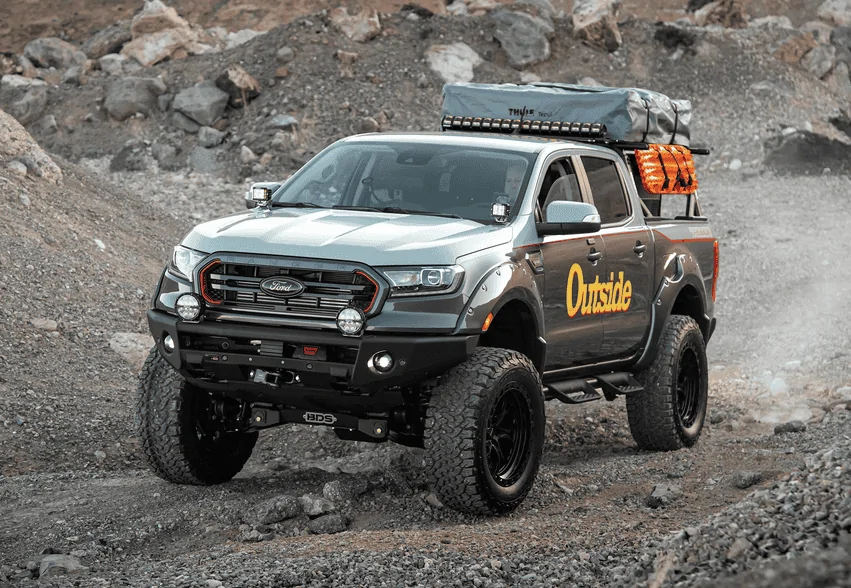

Good day, I was just looking at the BDS site to see about getting a kit to lift from the +2" I have now to something more substantial.
The notes for all the 6" kits say it's not compatible with the Tremor models but I really have no understanding as to why. In the site images they do have a 6" lift on a Tremor, so I'm left wondering what the real difference is between models and why wouldn't something work?

Was curious to see a Tremor with 6” lift so I went to their website and they show an FX4 not a Tremor. ?‍♂
Directly off their website. Has the nostrils and the side steps. Can't imagine why anyone would go out of their way to upbadge with either of those options unless it's a Tremor.

Didn’t see that one. It does have the Tremor nostrils and steps but those are easy bolt on items. I would ask them if it is a Tremor and if so why do they say you can’t do a Tremor.

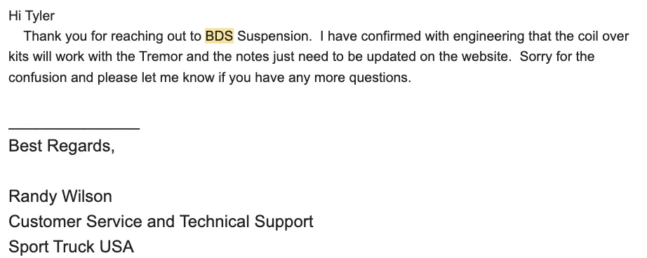

They said that the Tremor pictured is one they did for them.
Yeah, that's what I got too. Seems bizarre to have the images with a kit that's not compatible. Also didn't get any clarity on what's different either. Guess I'll just look into something else.
