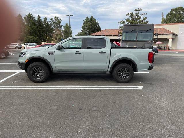

Had the 1” Traxx kit installed yesterday. Makes the Tremor perfectly level . Exact wheel well to ground height across all four tires. My initial thoughts: Noticeable improvement in look; Ball joint sitting fine; Ride is pretty much same. Pictures don’t really do the change justice but I find the truck looks much more rugged. Due to time had the stealer. Install it but they said it was straight forward no issues.
I was looking at the 2" but it looks like based on your pictures it would create a negative rake? Anyone know if I did a 2" spacer up front and a 1" block in the rear if 33" or bigger would fit and clear? Great looking truck.
