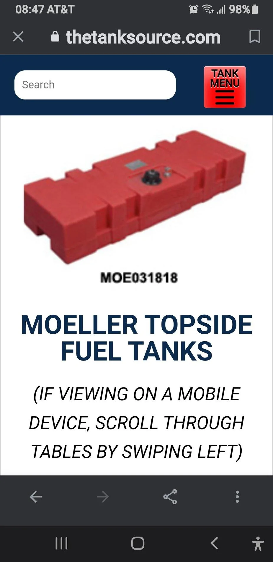

I have dead space under and behind my box that houses my retractable bed cover. If I do it I want bigger than 5 gallons, this one would double my fuel capacity and range. If it would fit and can be secured. Being plastic it should be easily removed when not needed. The website below has many other options
"TOPSIDE FUEL TANKS - THE TANK SOURCE" https://thetanksource.com/topside-fuel-tanks/
