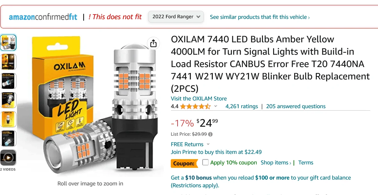

these? they work even though amazon says otherwise? thanks!
Can confirm in my 21 Lariat that the Oxilam 7440 with built in load resistor work flawlessly! Cleaned up the hyperflash in the cab and a Canbus created problem with the overhead maps lights (one wouldn't turn off). Good stuff but they do run pretty warm.

There are numerous threads on adding LED's and I think the error free ones are what you need, if you know the brand, just use the search bar here and i am quite sure you will find the specific install notes on them. I have the LED taillights as well but installed thses in my front turns and no issues with hyper-flash.
OXILAM 7440 LED Bulbs Amber Yellow 4000LM for Turn Signal Lights with Build-in Load Resistor CANBUS Error Free T20 7440NA 7441 W21W WY21W Blinker Bulb Replacement (2PCS)
Visit the OXILAM Store
4.4 out of 5 stars 4,102 ratings
| 195 answered questions
#1 Best Seller in Automotive Vehicle Top Clearance Light Assemblies
-17% $24.99$24.99
I have those as front signal light and they are bright as hell!!! love them!!!!
