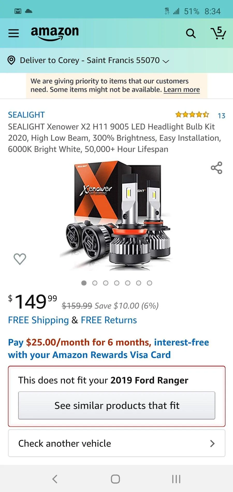

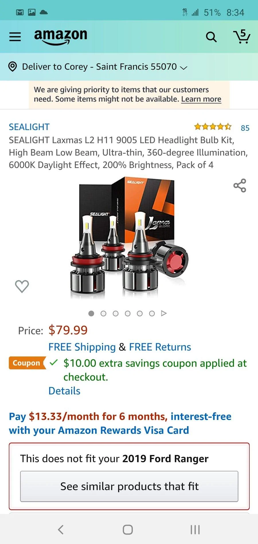

How are the headlights holding up? Any hazing? How about the plastic dust caps?
I have the Sealight S2's in my wife's Escape for a few years now and still perfectly bright and no issues yet, but she has more clearance than the Ranger would.
I want to get a set for the Ranger as well but debating on their newer versions of the led bulbs, the L2 or the X2.

Their customer service wouldn't or couldn't give me dimensions, not sure which one.
But having a feeling both of these might not fit because of the fan and heat sink, but they still look relatively small.

By looks alone, the X2 would be the better bet, but not guaranteed. As I stated in post #133:
- max heatsink size should not exceed 35mm diameter and 24mm depth/height
You could measure them before install to see how close they are.

that's good to hear. Thank you for letting me know about your experience so quickly.
I'm going to just order them and try it. I'll measure first, and based on your measurement requirements I'll determine if they'll fit so if they dont I'll return them.
