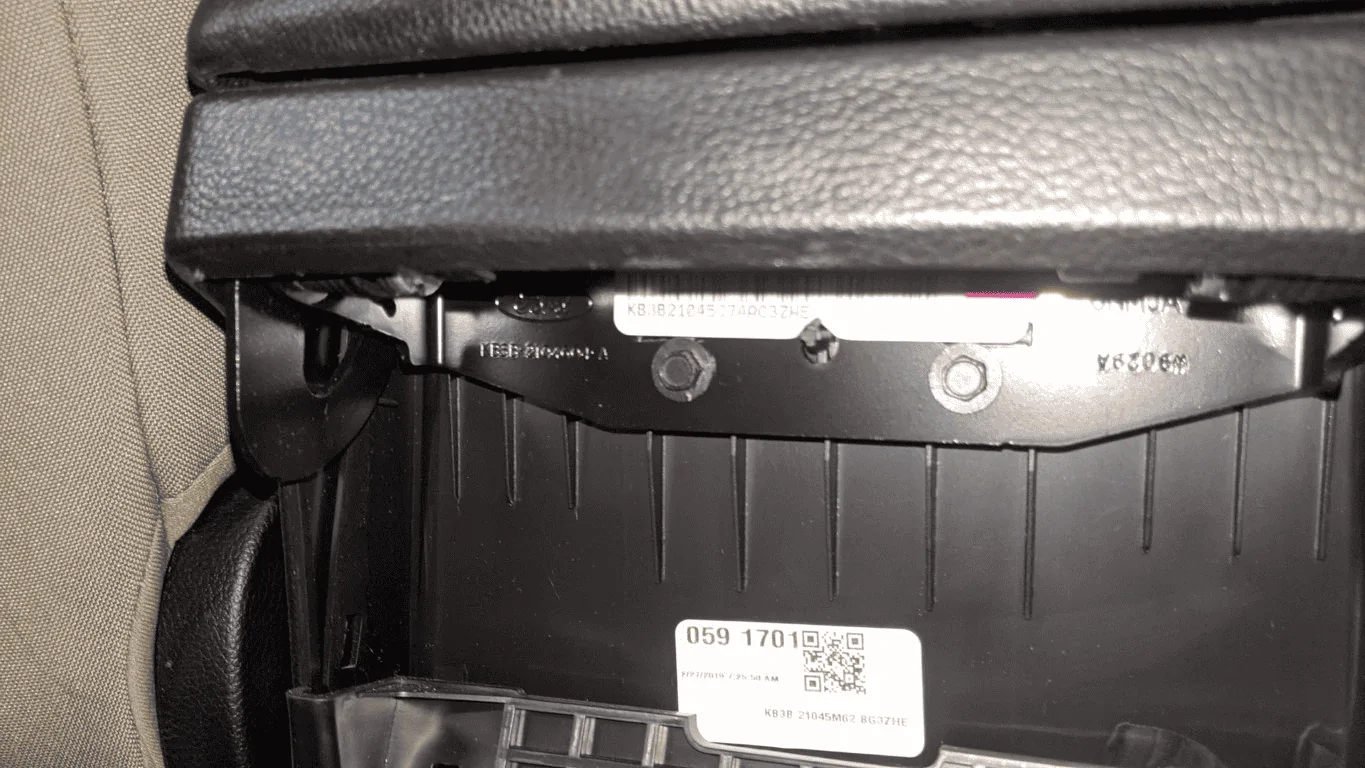

I would say, once you pull the back cover, this will give you access to the 2 bolts, holding the cover on.
Remove the bolts and the cover should lift right off.
The Lid & Hinge Assembly is one unit
