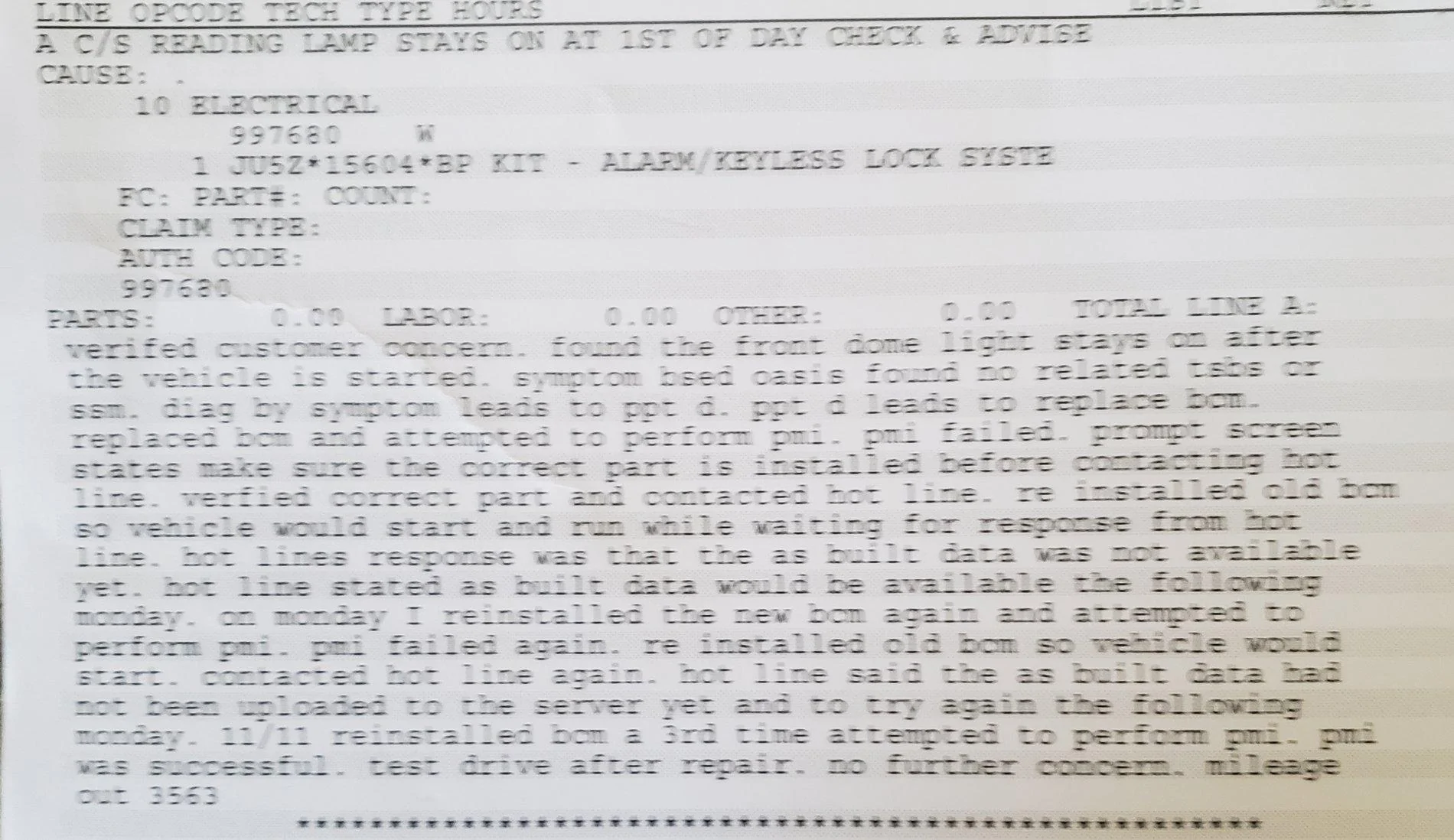

Thanks, but there is not anything I can do about it. It's a coding change, not a spare part. Thankfully, we have a second vehicle. I'm of course disappointed but I'm guessing it's not just my truck that's affected so the coding change (and there are probably other changes) will take time.

Finally got it back. Took a new BCM and new programming. Would have thought they would have washed it after storing it outside for 3 weeks. Dirty inside as well, but at least it is fixed.

So far it seems to have worked. I didn't really notice the lights staying on when I parked it (although I did notice once when I just opened the door and closed it and the map light wouldn't go off), but the map light never went off when I started it after sitting for a while (like overnight or maybe a few hours). You could toggle the map switch and then it would go off. Only the map light would stay on, the overhead light (which should go off with the map light) would switch off by itself.

Shouldn't be a problem to get it fixed. There is no way they did a code change just for my one instance and yours show that it's not a one time thing. At least you shouldn't have to wait over 3 weeks waiting on code. New BCM and code update and you should be good to go.
