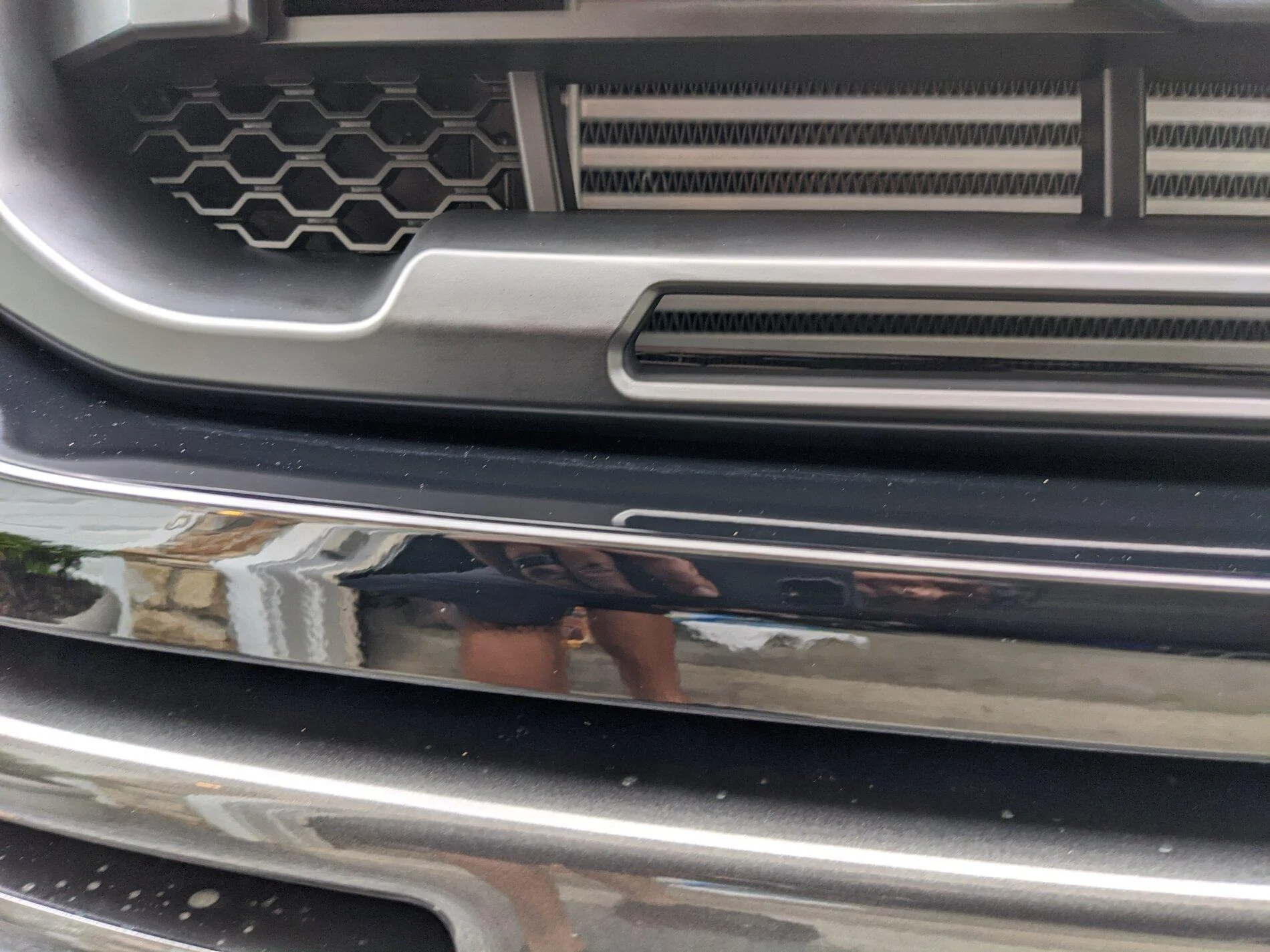

The replacement raptor grill I bought has the tabs across the bottom but they don’t all line up with the existing slots. Any suggestions?
May 11, 2019
NJ
I just figured it out. I had the tabs screwed into the grill in the wrong order. Gah!

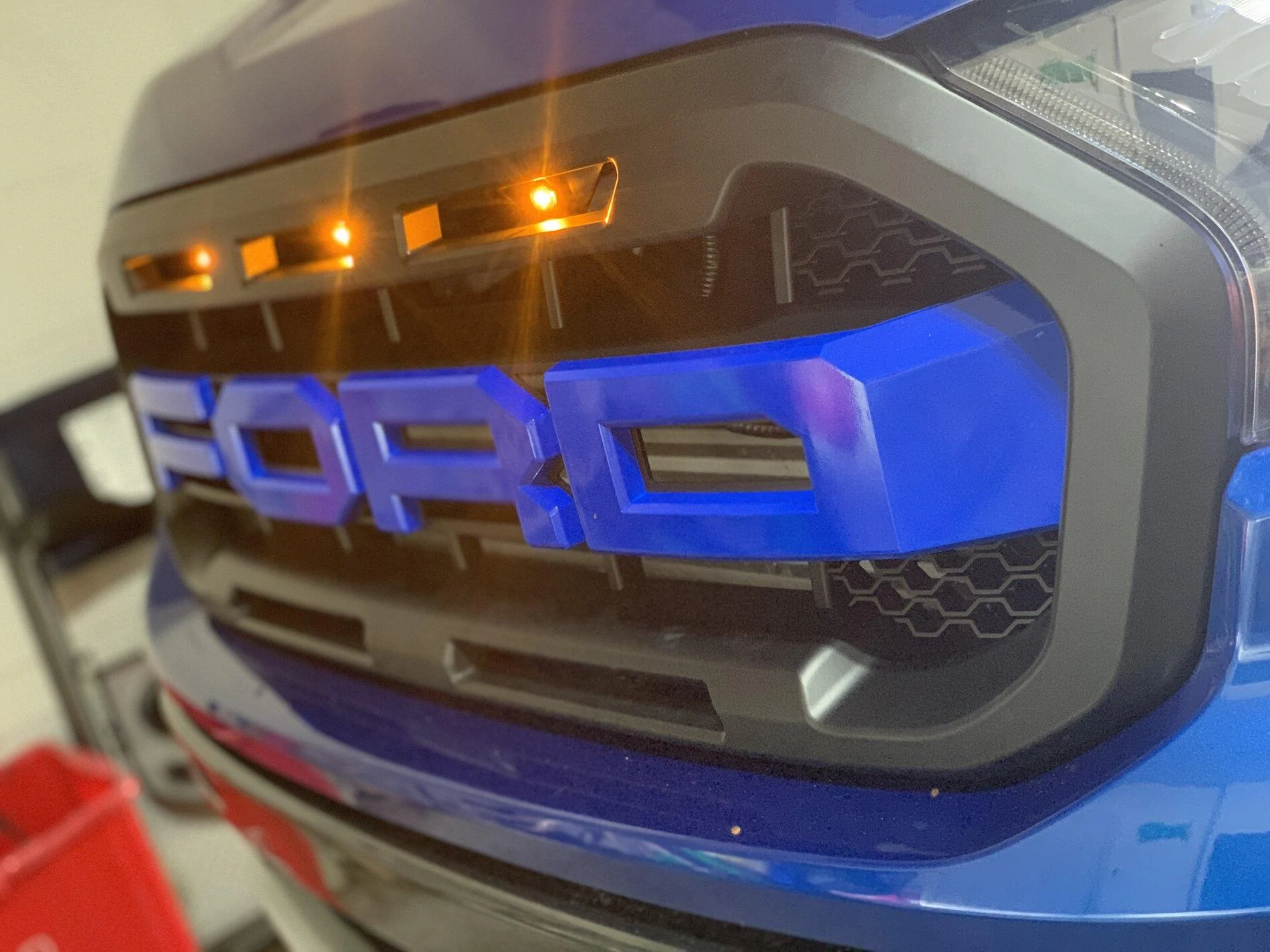

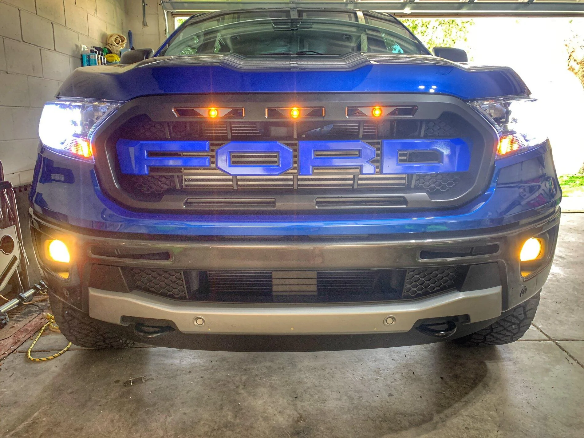

Late to the party, but I finally got it done. I painted the grill and the letters gloss black then put metallic blue vinyl lettering on top. The lights were sprayed with a few coats of smoke Plastidip before I attached them so that the orange wouldn't stand out too much during the day.
Where did you get your raptor grill lights? Also, did you change the fog lights bulbs or the whole housing?
The Lariat trim has LED fogs that are made as a whole assembly, so I couldn't change the bulb; I used Lamin-x yellow film instead. The fun part was removing the assembly to put it on - the lens is a circle that's placed behind the square openings.
As for the grille lights, I pretty much followed the procedure that msfitoy did: https://www.ranger5g.com/forum/threads/project-msfitoy-v3-0.2804/#post-37610
I used exterior double-sided gorilla tape instead of epoxy to mount them. I think I wired them a little differently, but the end result was basically the same.

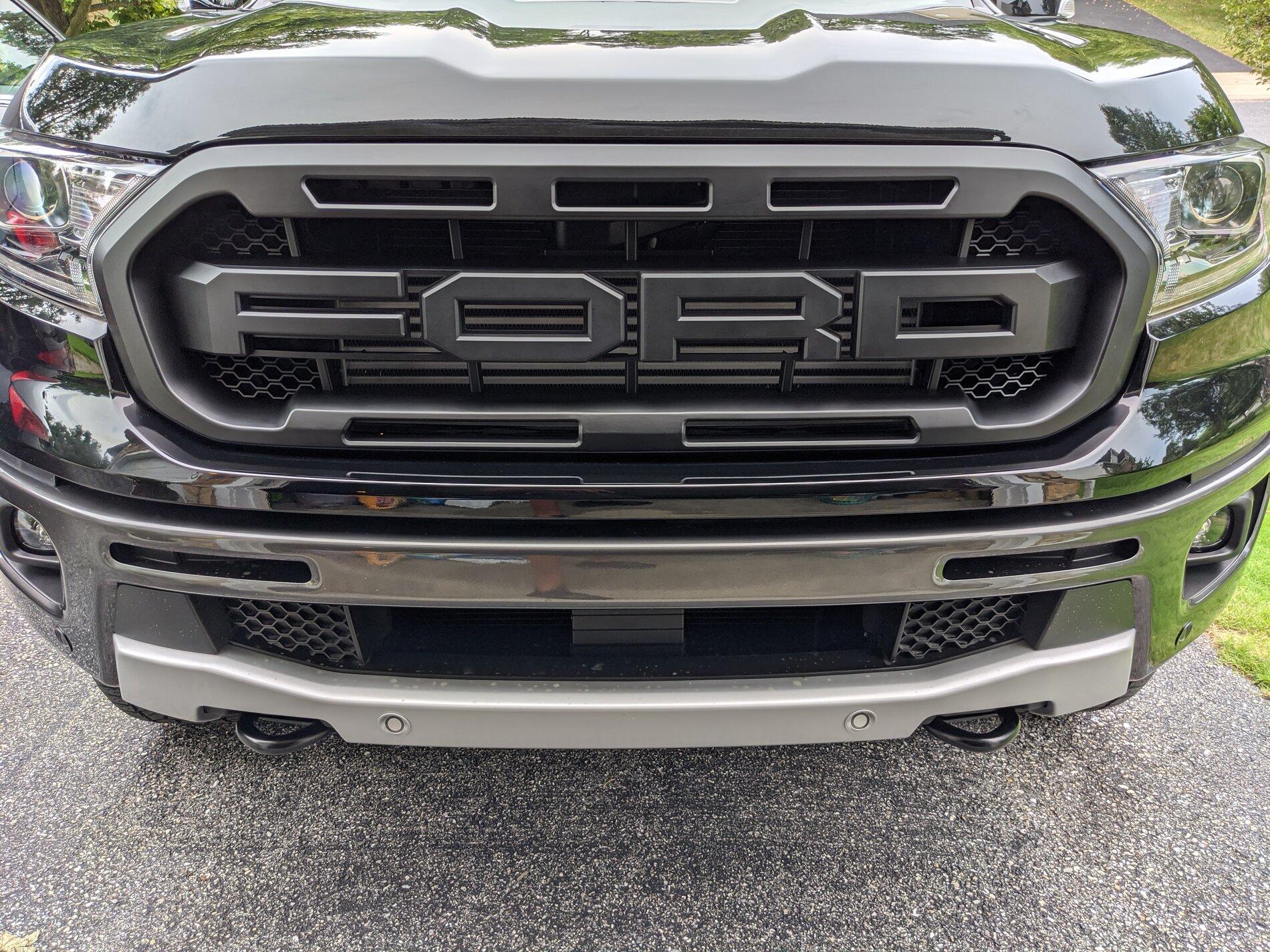

Late to game, finally installed it today. No Gaps, no issues...uninstall of original was a pain but luckily no broken tabs and still all done under an hour. Just wondering what people did for paint...like will OTC spray paint work?
Looks great! Welcome to the party, hope you didn't come empty handed!!
