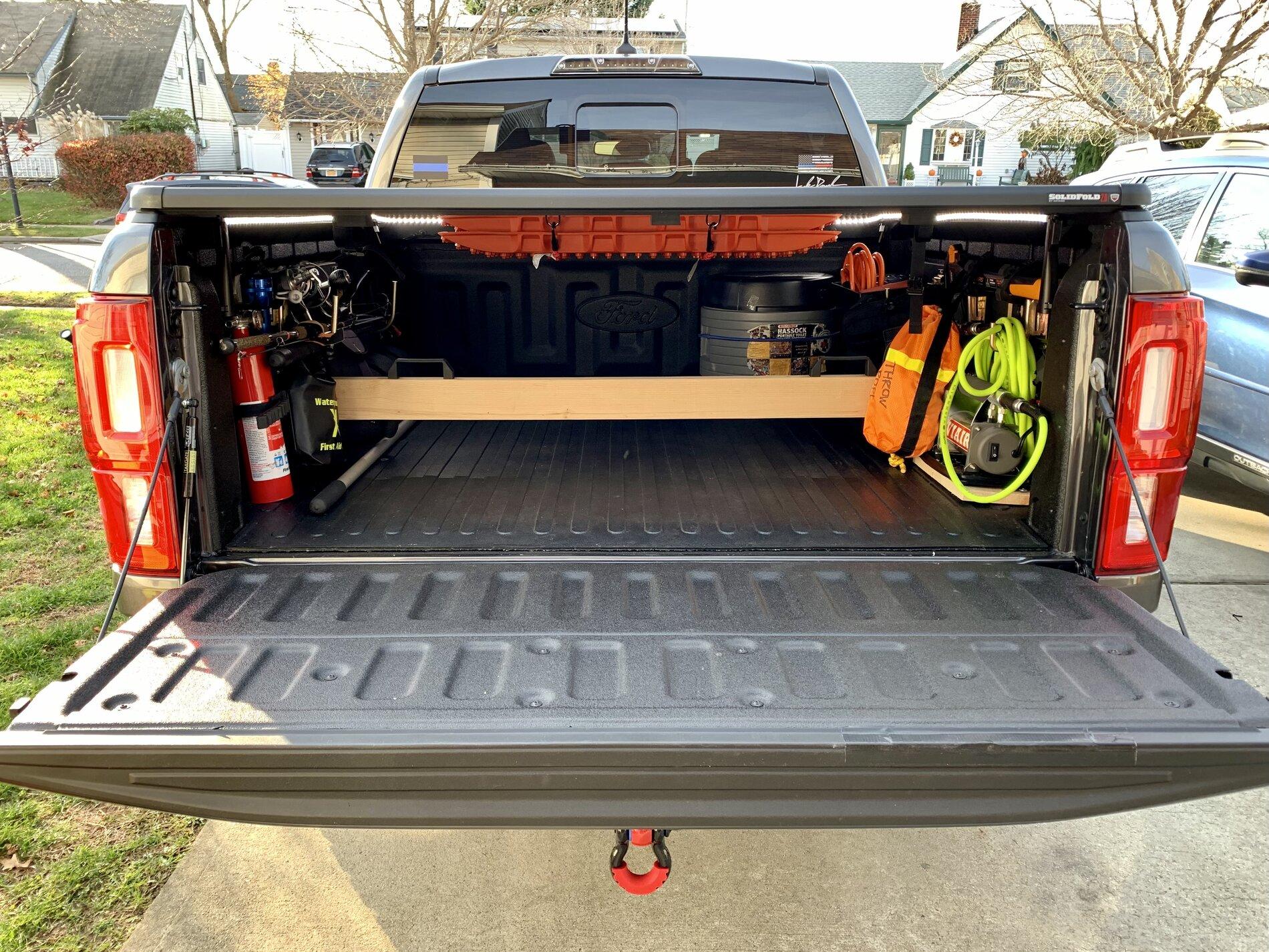

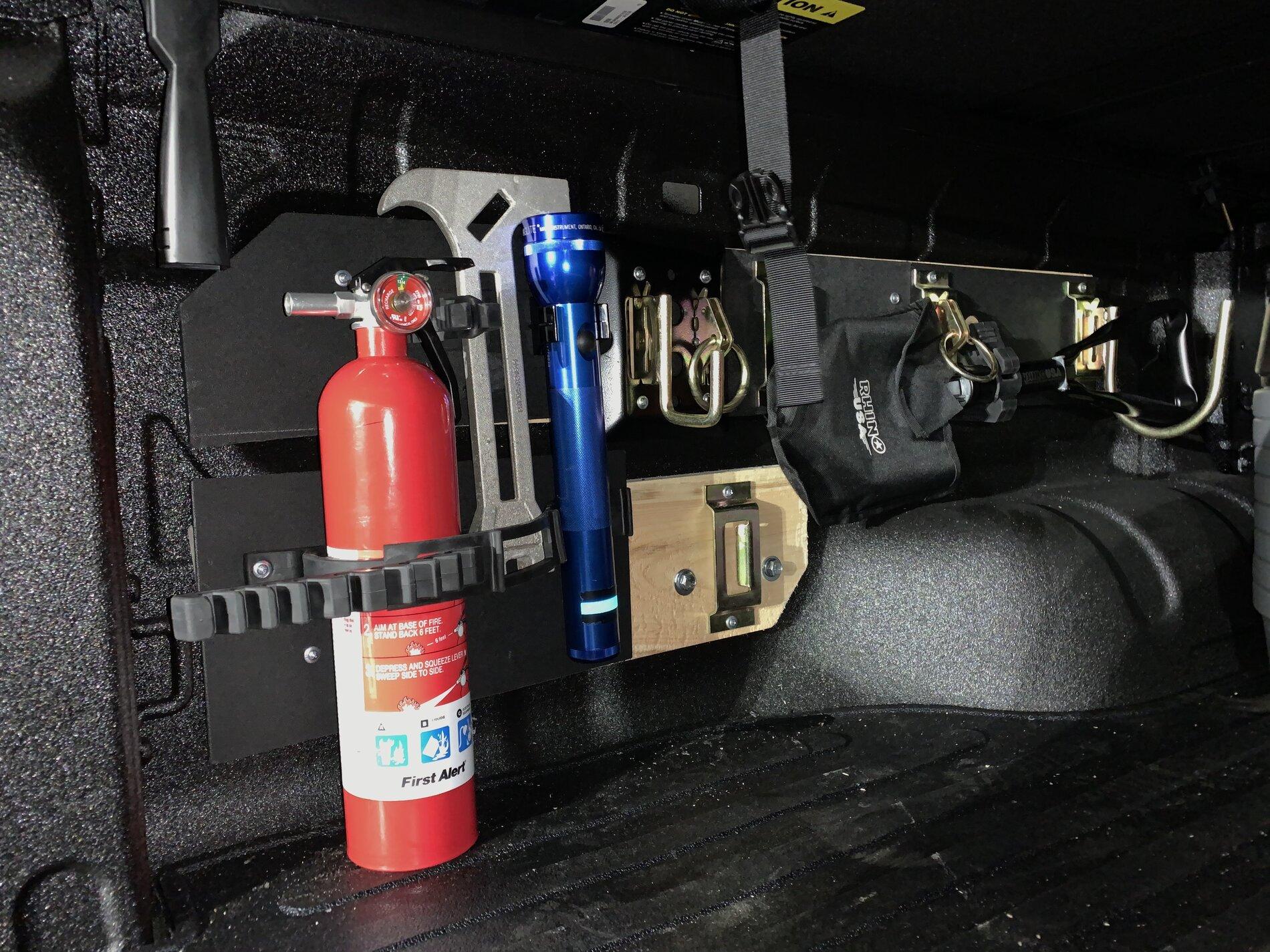

Note: This is an ongoing project, still waiting for bed led light and some misc mounts. Still need to decide on onboard air.
DIY Caveat: Need to drill 2 holes each side of the bed.
Pros:
Organize your bed and tools.
Place to mount your fire extinguisher, flashlight, etc.
Easy to remove DIY panels by loosening 2 nuts per side.
Versatility of the E track and attachment accessories.
Cons:
Need to drill x2 holes per side.
May not be the look you want.
( Im still waiting for Builtright Ind to make the Ranger panels)

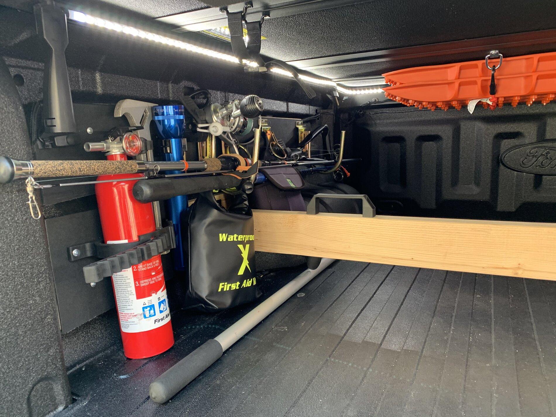

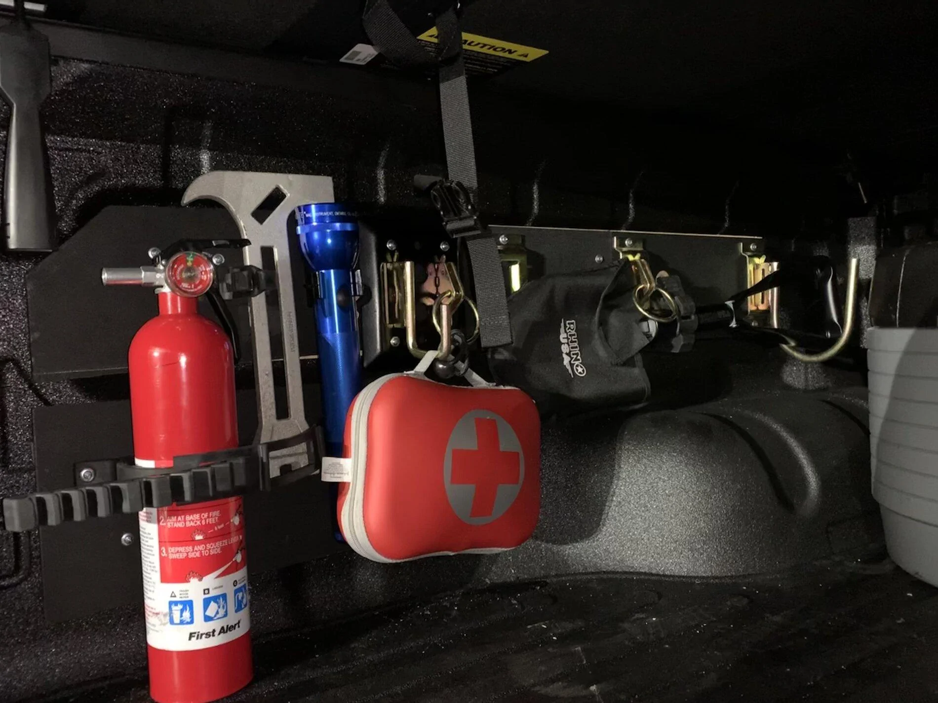

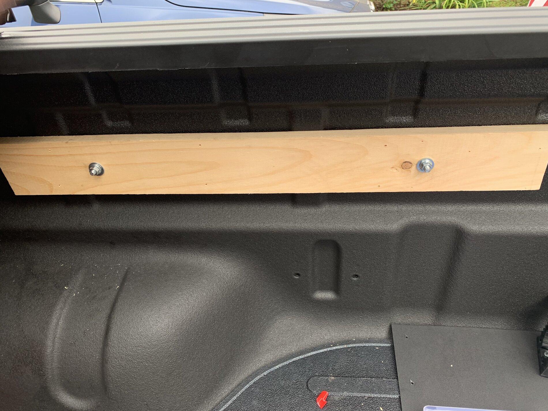

So, took me a few days to decide wether I should drill or not ( dilema for lots of us here in the forum...lol ) But I need mounts and holders on the truck bed! I want to be able to hang my fishing rods too.
I am posting this, in case anyone wants to do something similar.
Most stuff you see in the pics are materials you can get from Lowes or Homedepot.

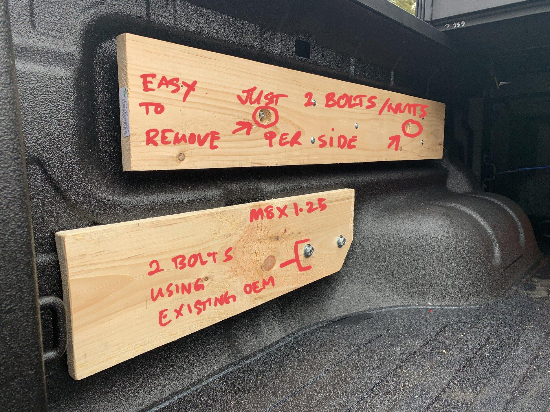

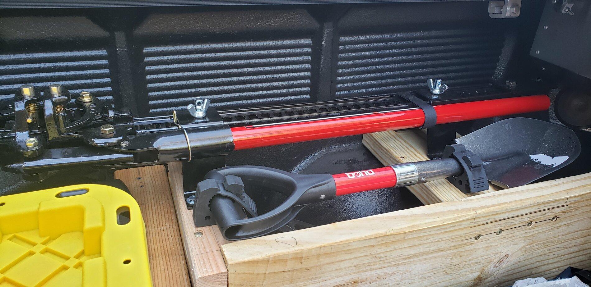

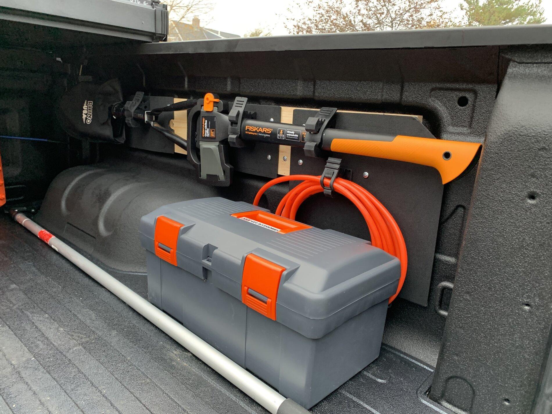

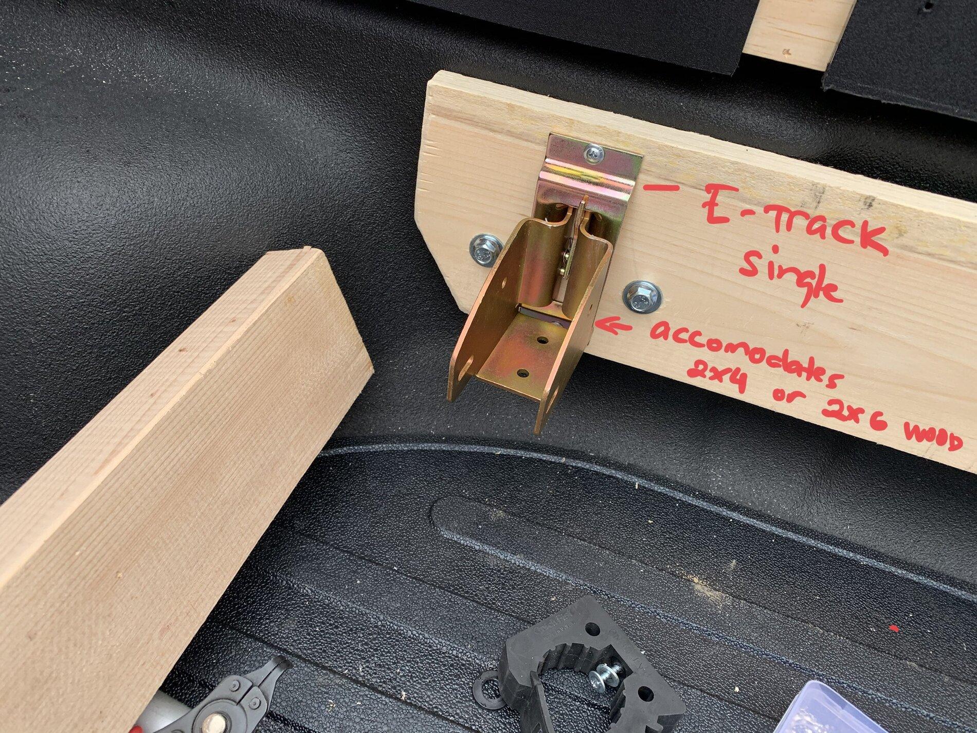

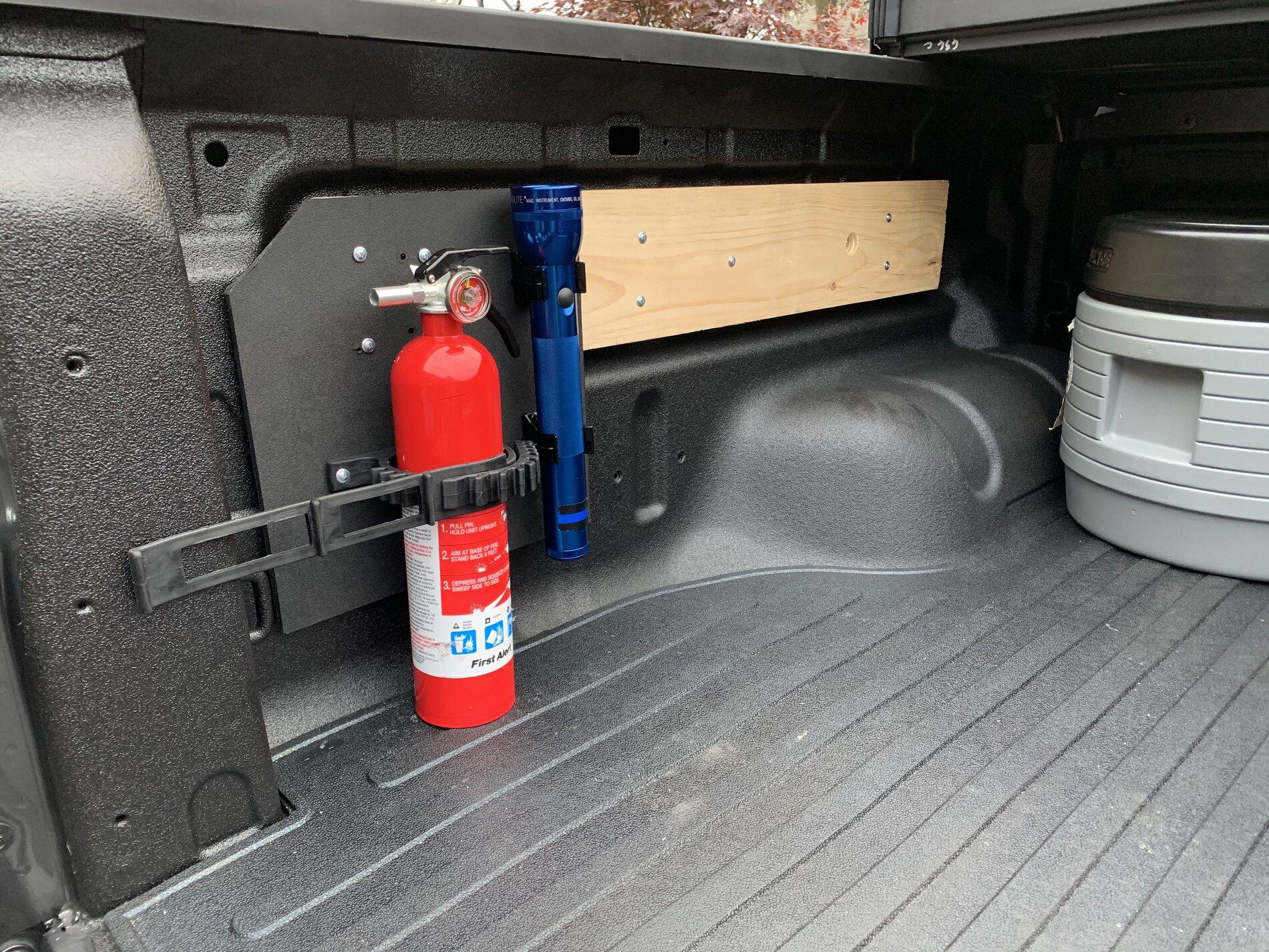

I used 1x6x6 (but its actually 1x5.5 wood) 1x4 for the inside attaches to the 2 main bolts in the pics. You may use whatever wood material and size, type you like.
Notes:
My Ranger came with a factory spray in bed liner.

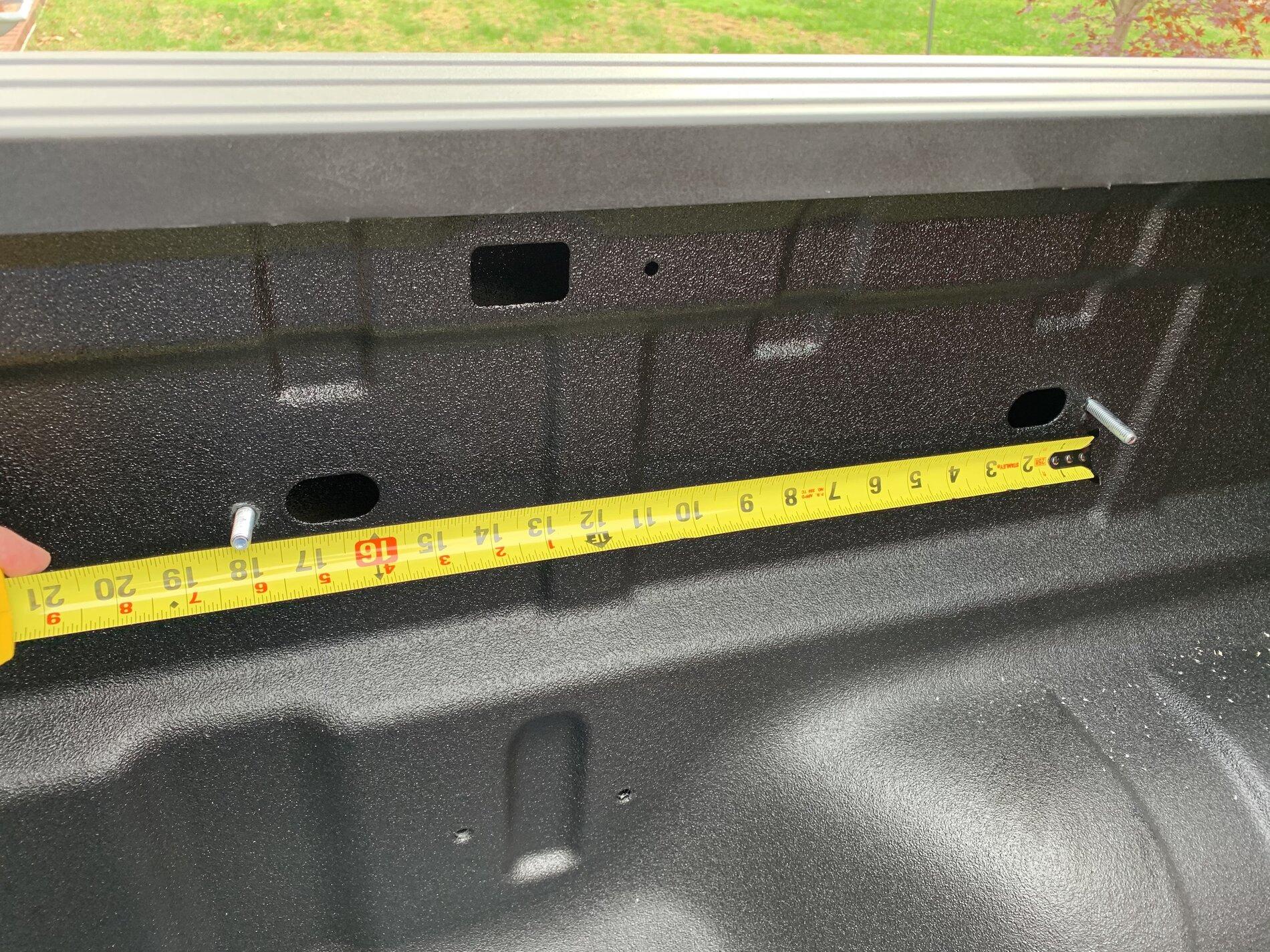

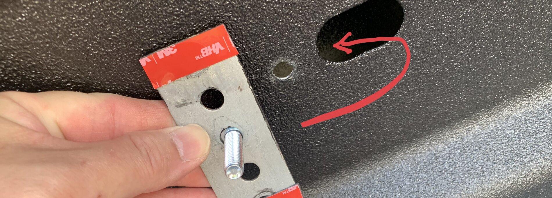

It has the 4 pre existing oval holes on the bed ( see pics)

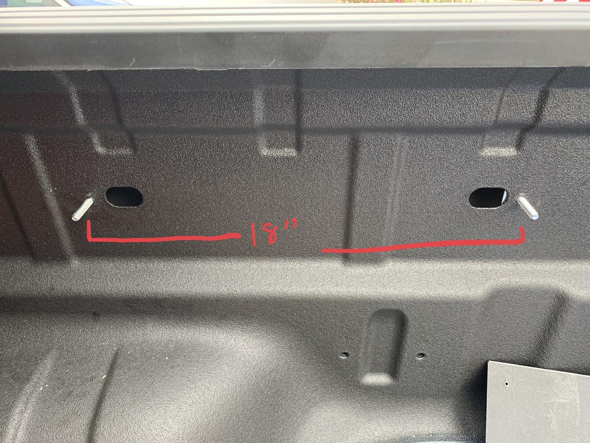

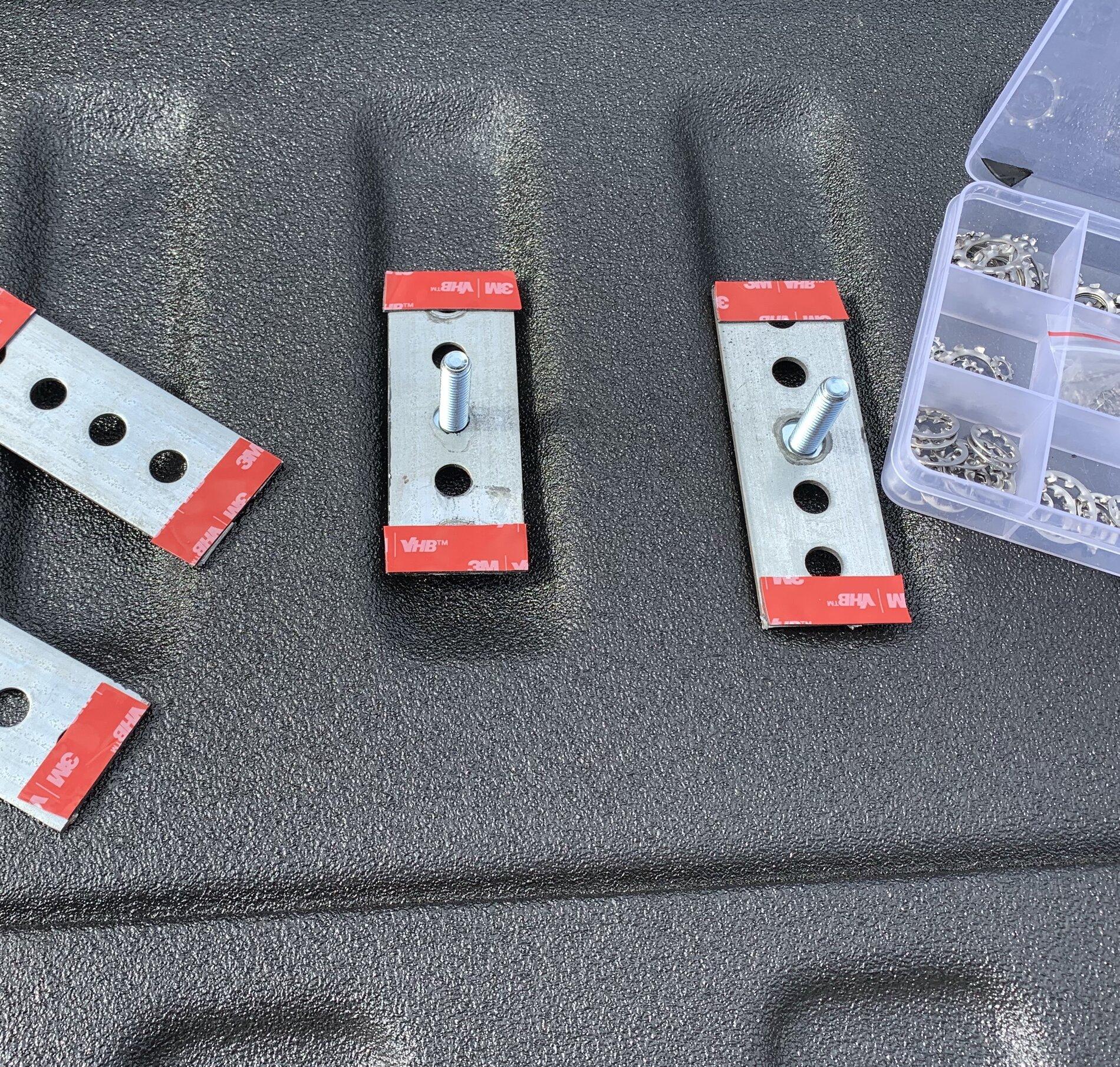

I decided to drill the holes 18 inches apart, near these oem oval holes.
(I used these oval holes to be able to insert the metal brace/ backing plates).

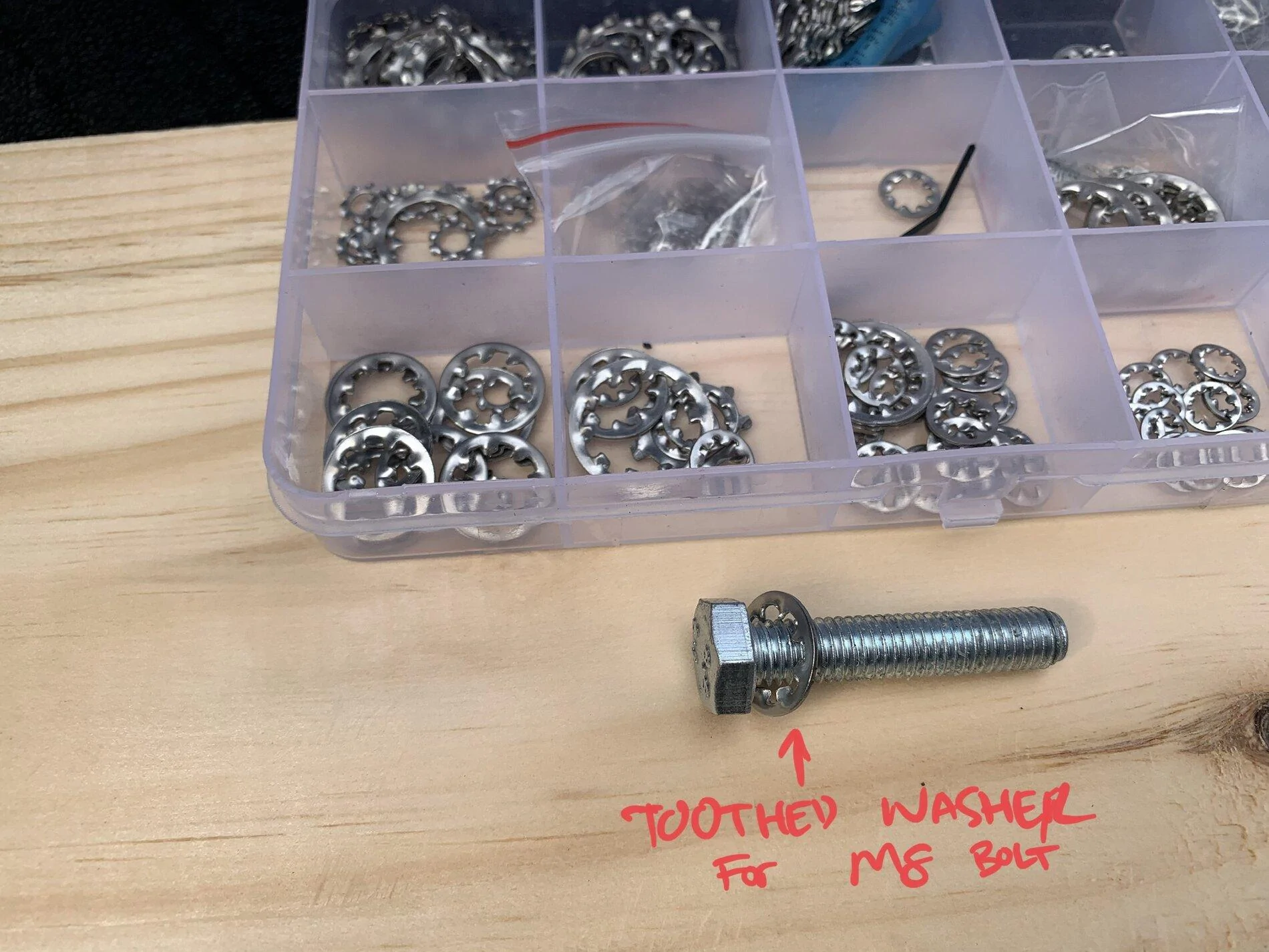

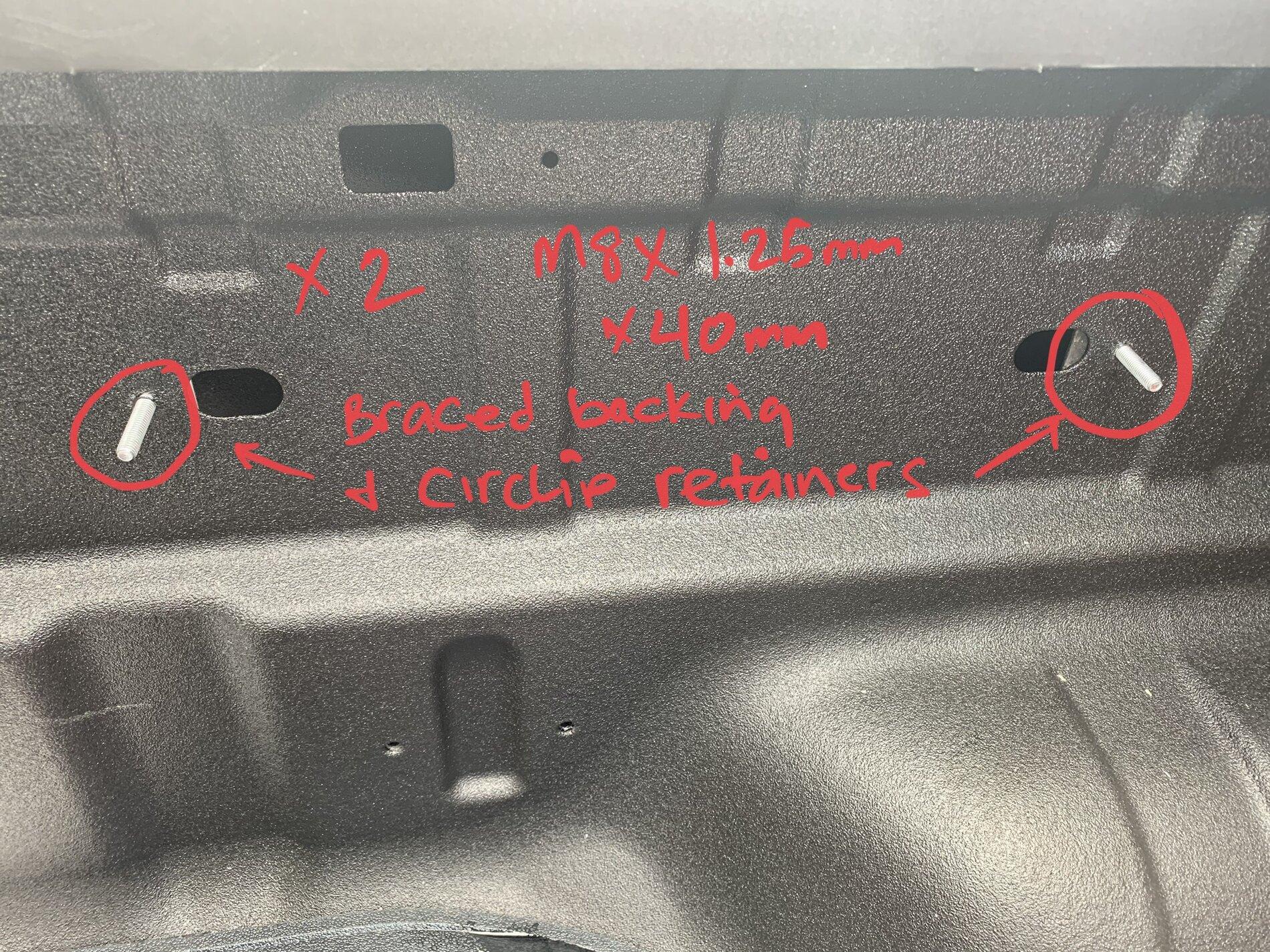

The bolts/ screws I used are zinc coated grade 8 hex M8 x 1.25 by 40 mm length. 5/16 washers and matching flange nuts.
For attaching the Black hdpe panels, the E track mounts and quickfist clamps I used zinc coated Tek screws 1.25” and 3/4“ sizes.
I used metal brace x4 ( see pics) cut into 3.5- 4 inches as a backing plates
for the bolts. The 3M strips are optional, but made it easier to attach the backing plates.(see pics)

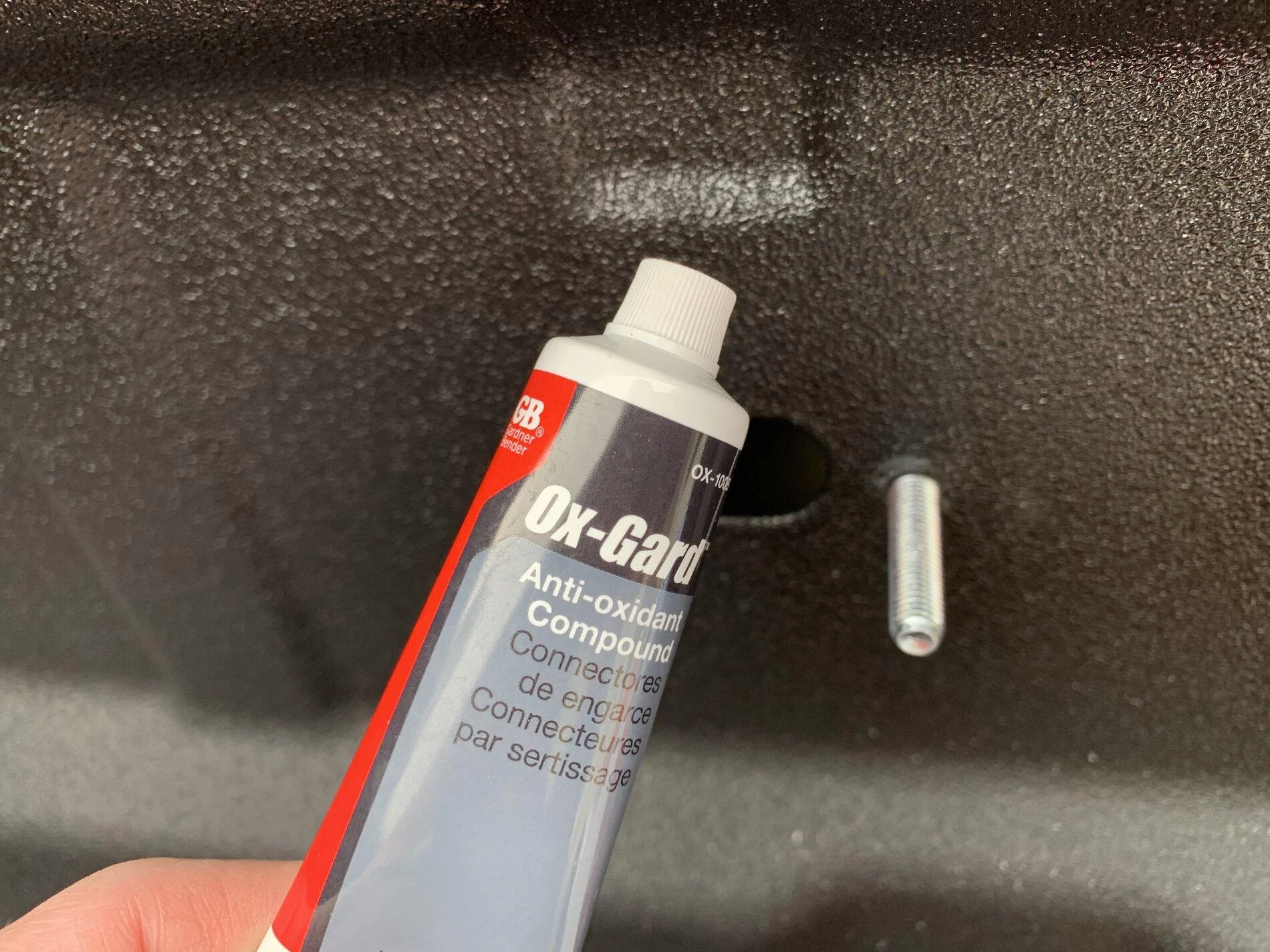

I also applied anti corrosion compound around the holes after I drilled. (not sure if it helps)

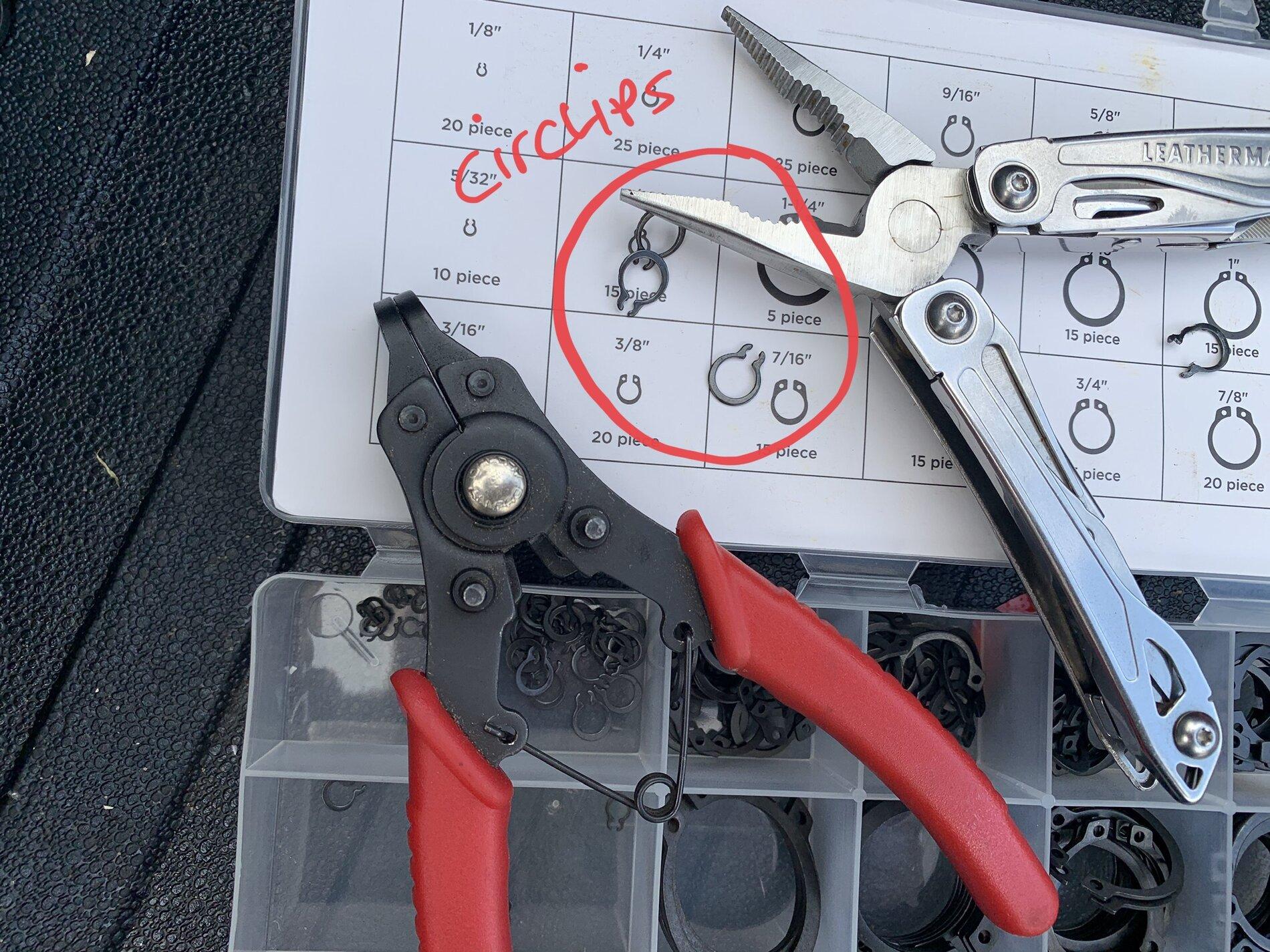

I attached Circlip retainers on each bolt, to prevent it from going back and falling inside the bed panels.

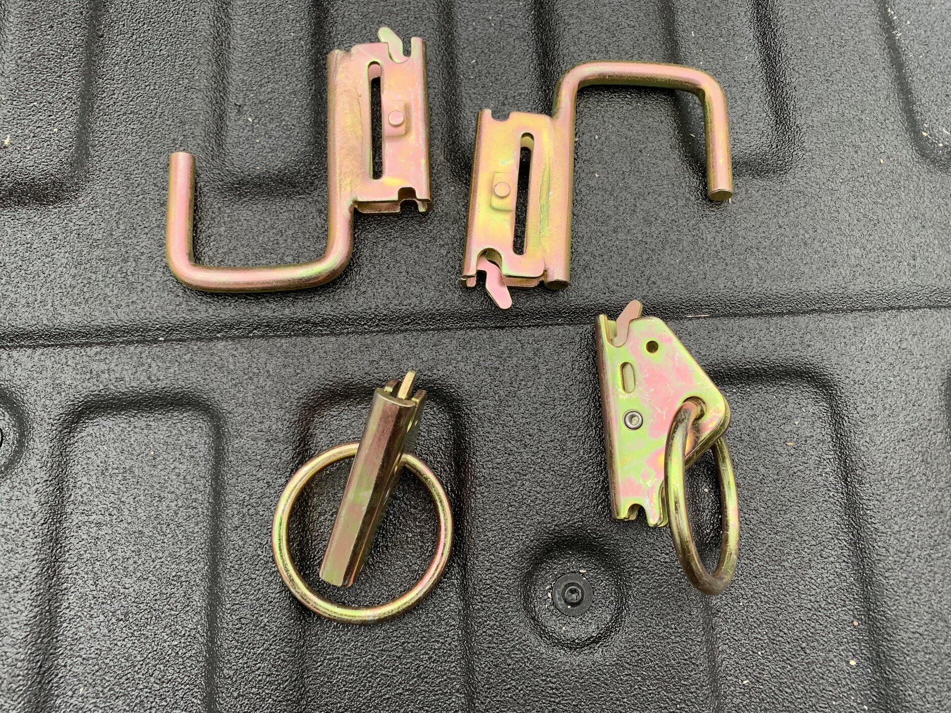

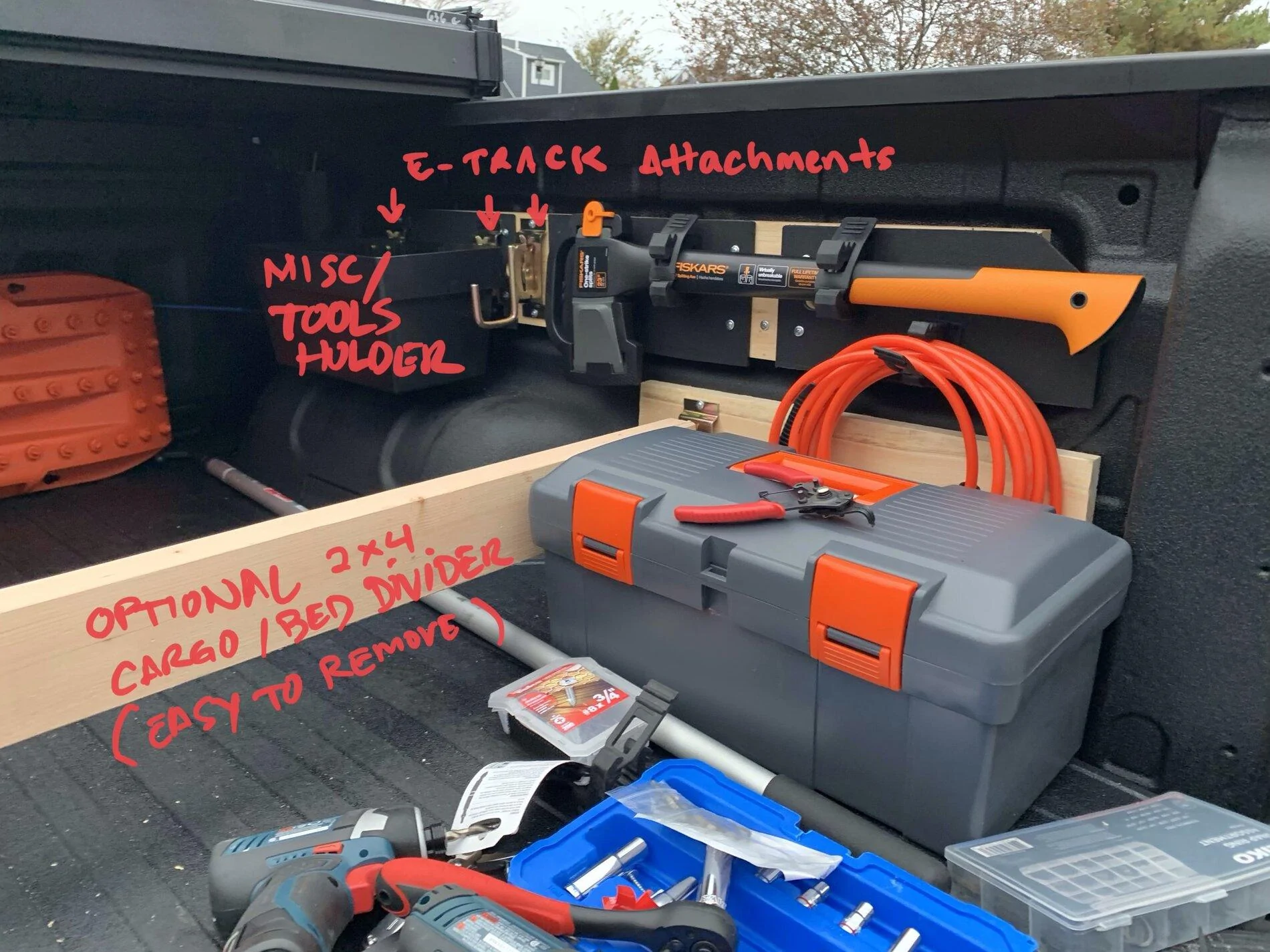

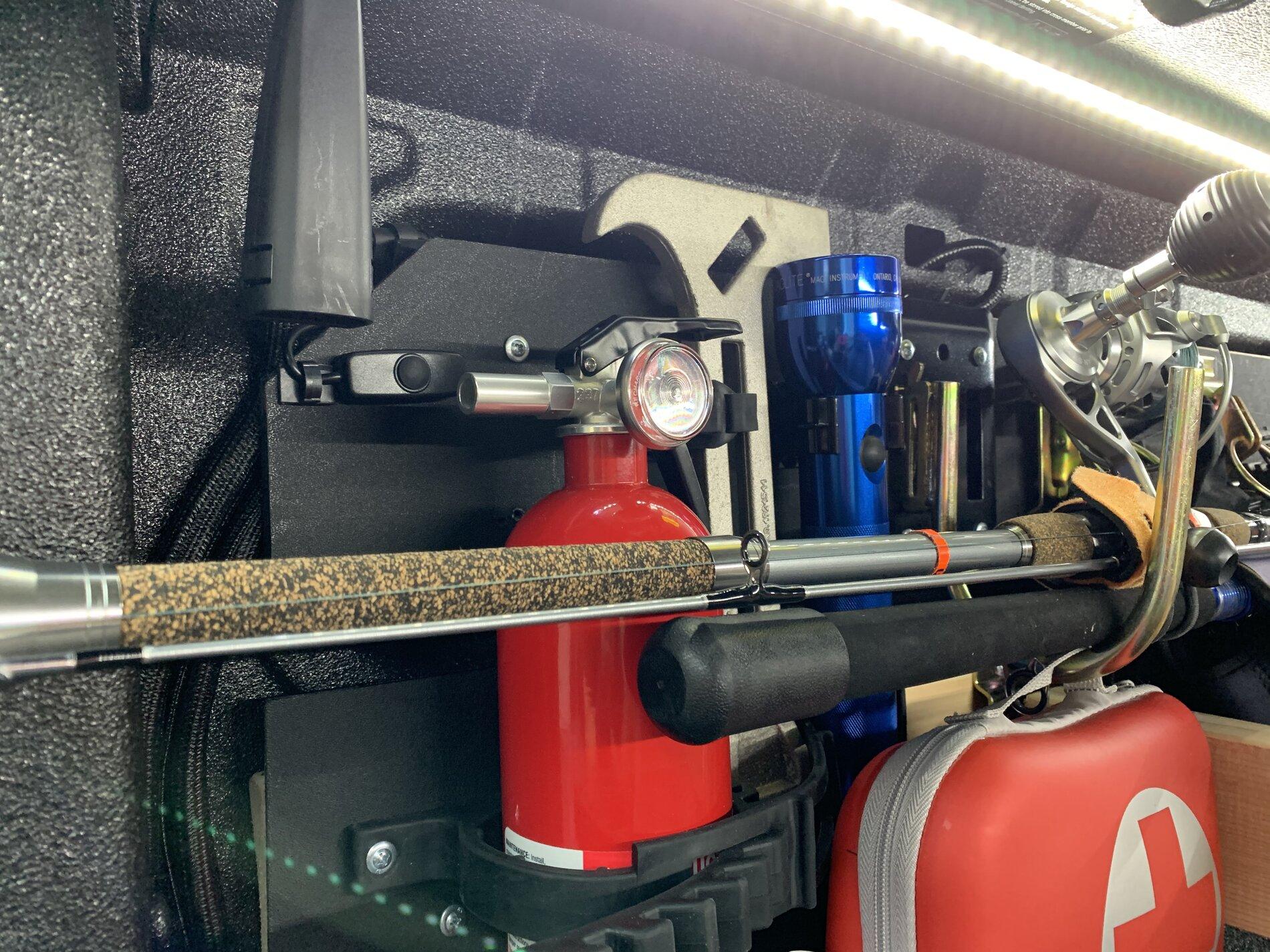

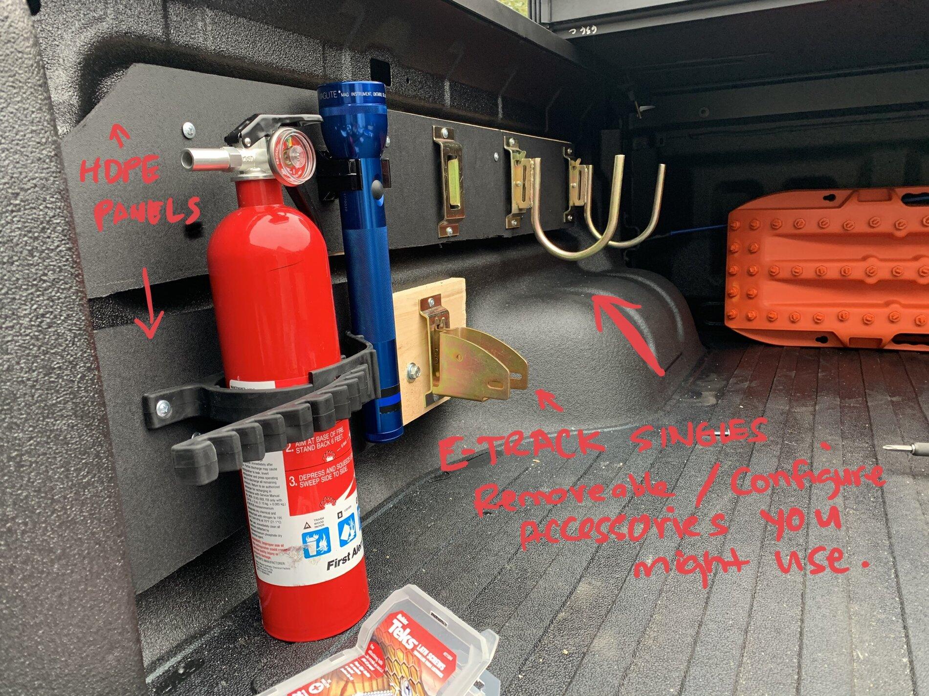

I decided to use E-track singles as It gives me more flexibilty on mounting it just where I need it. E-track also offers attachments like hooks, hangers, cargo strap mount etc... I also bought one of their bin. It fits my Kobalt ratchet set and misc tools.
The black HDPE material I used is optional. You can get them from Amazon.
I had 12x12 and 12x24 in 1/8 and 1/4 thickness and only cut into the pieces I need.
(Use them to cover up the wood if you want).
I dont plan on mounting or putting anything heavy ( >10lbs)
So please use your judgment when you decide what materials you use,
( stronger vs weaker wood, brackets, mounts, etc) and how you mount your items and accessories in your truck bed.
So here are the pics,

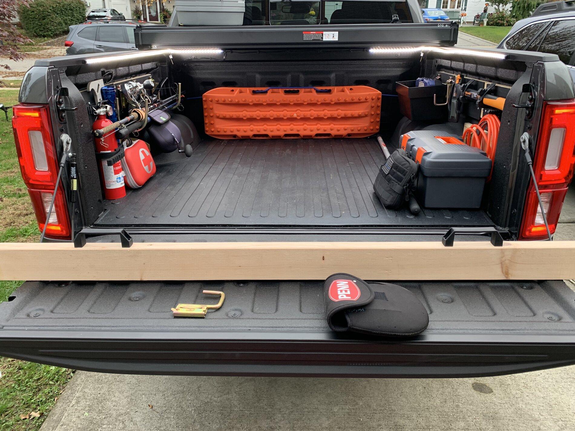

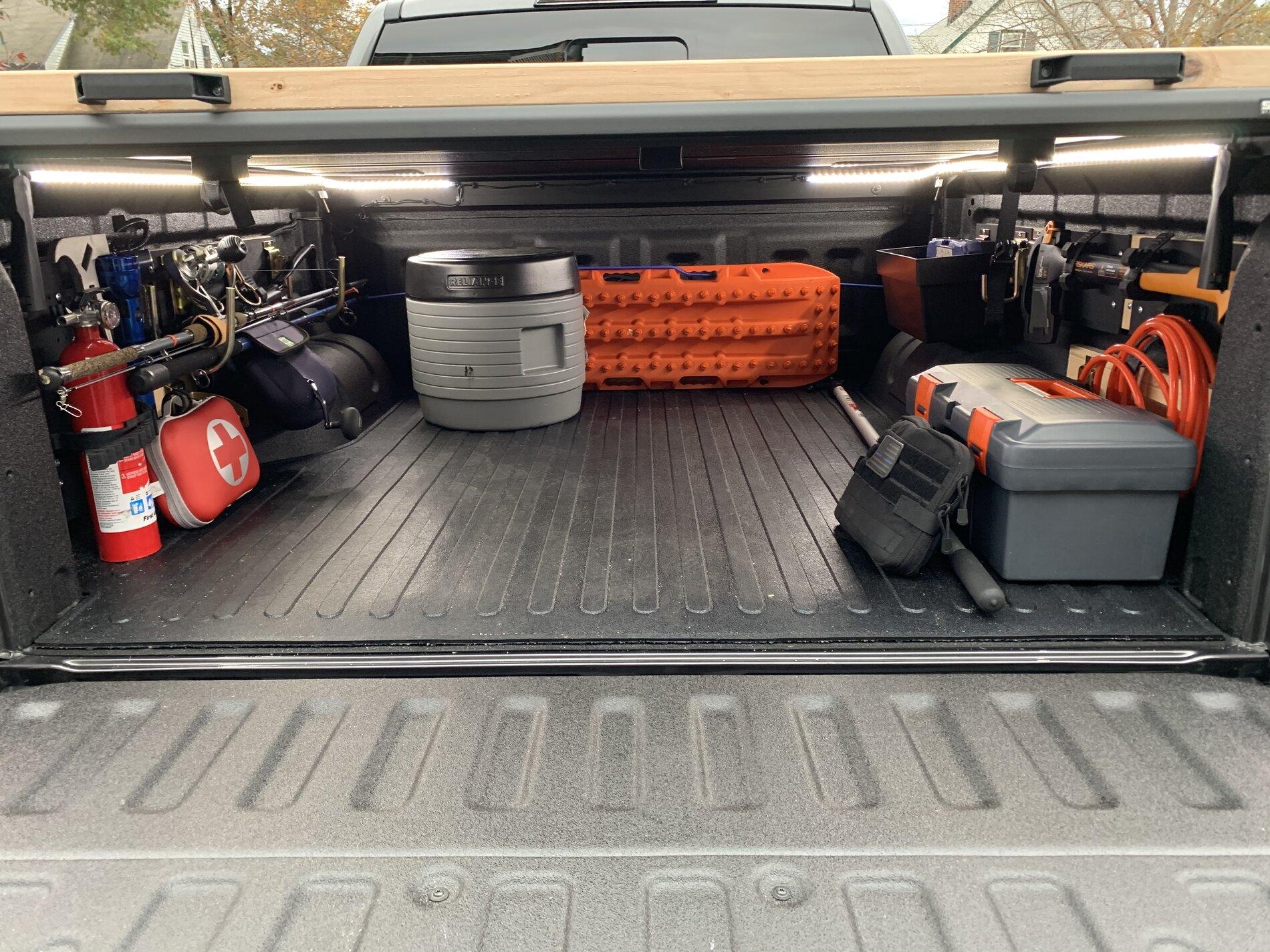

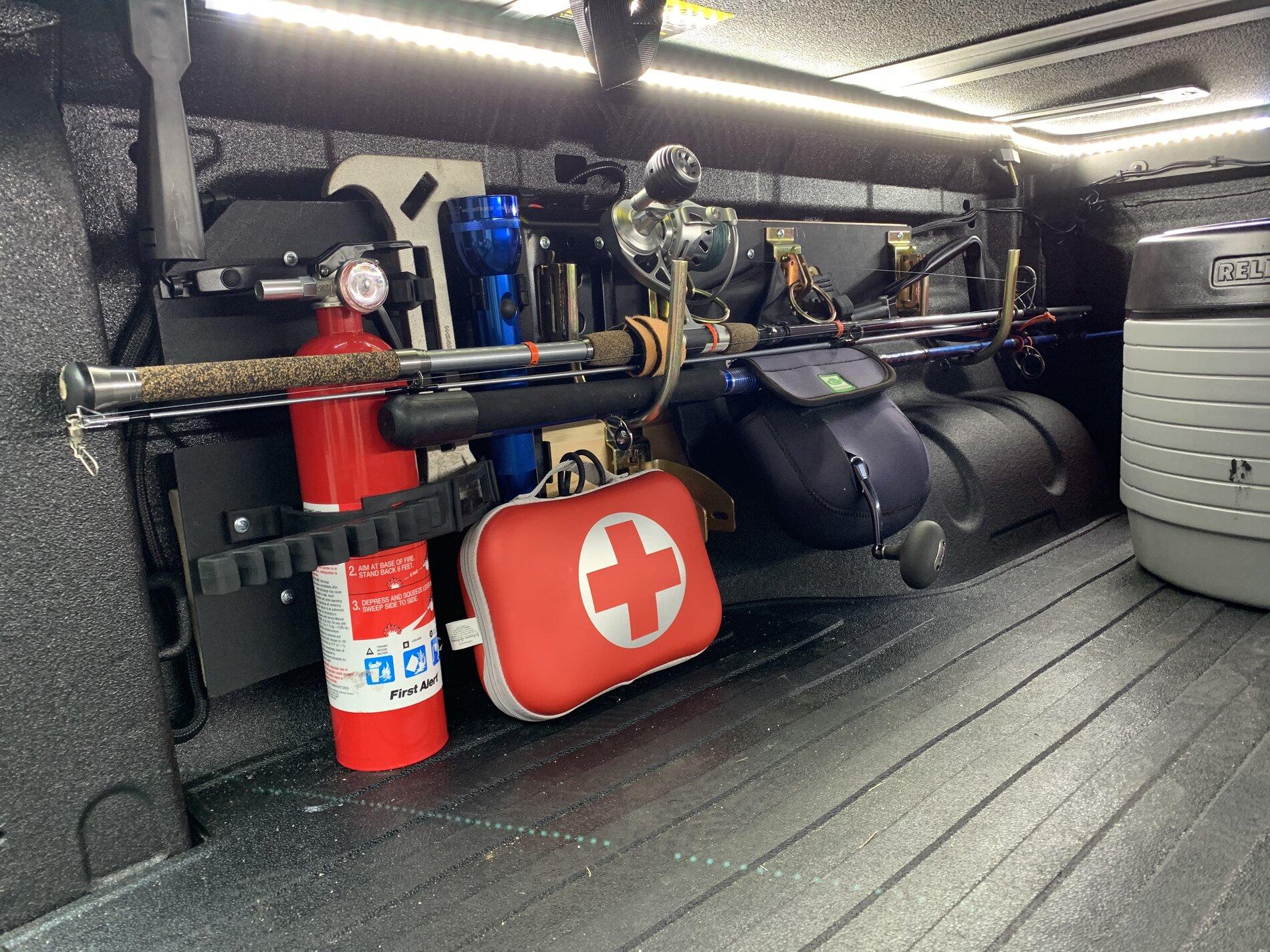

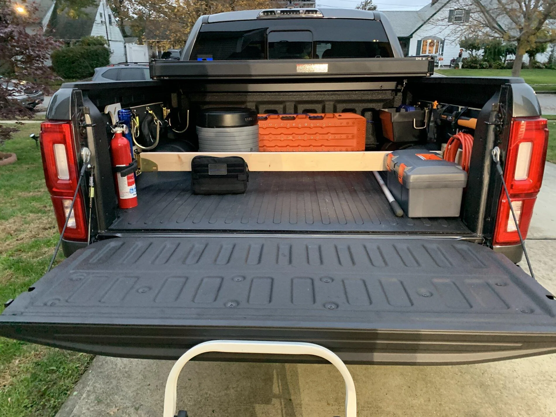

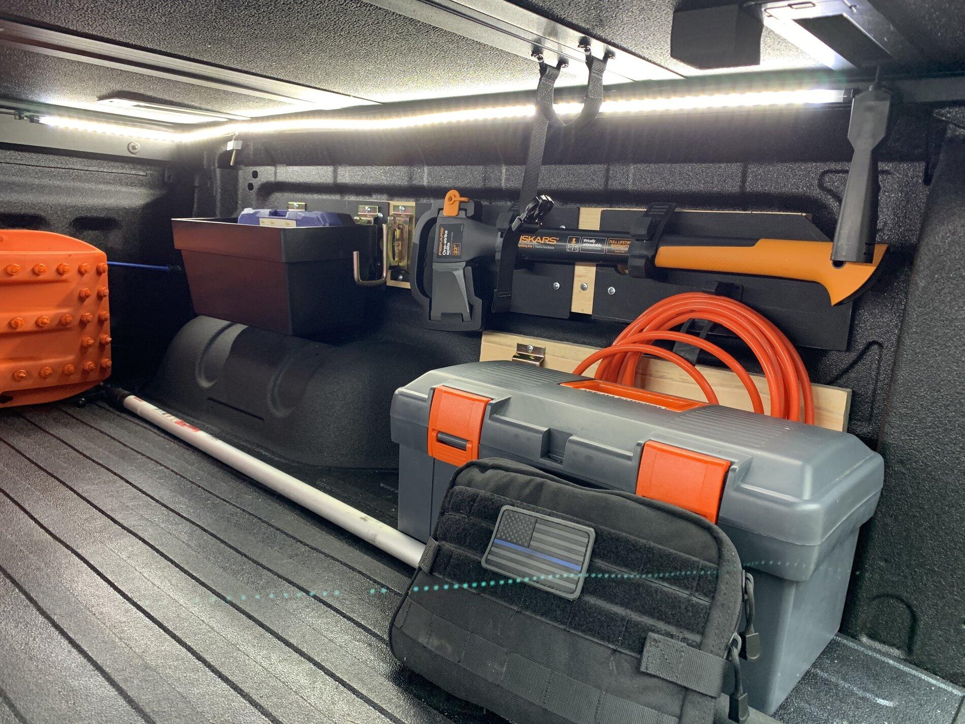

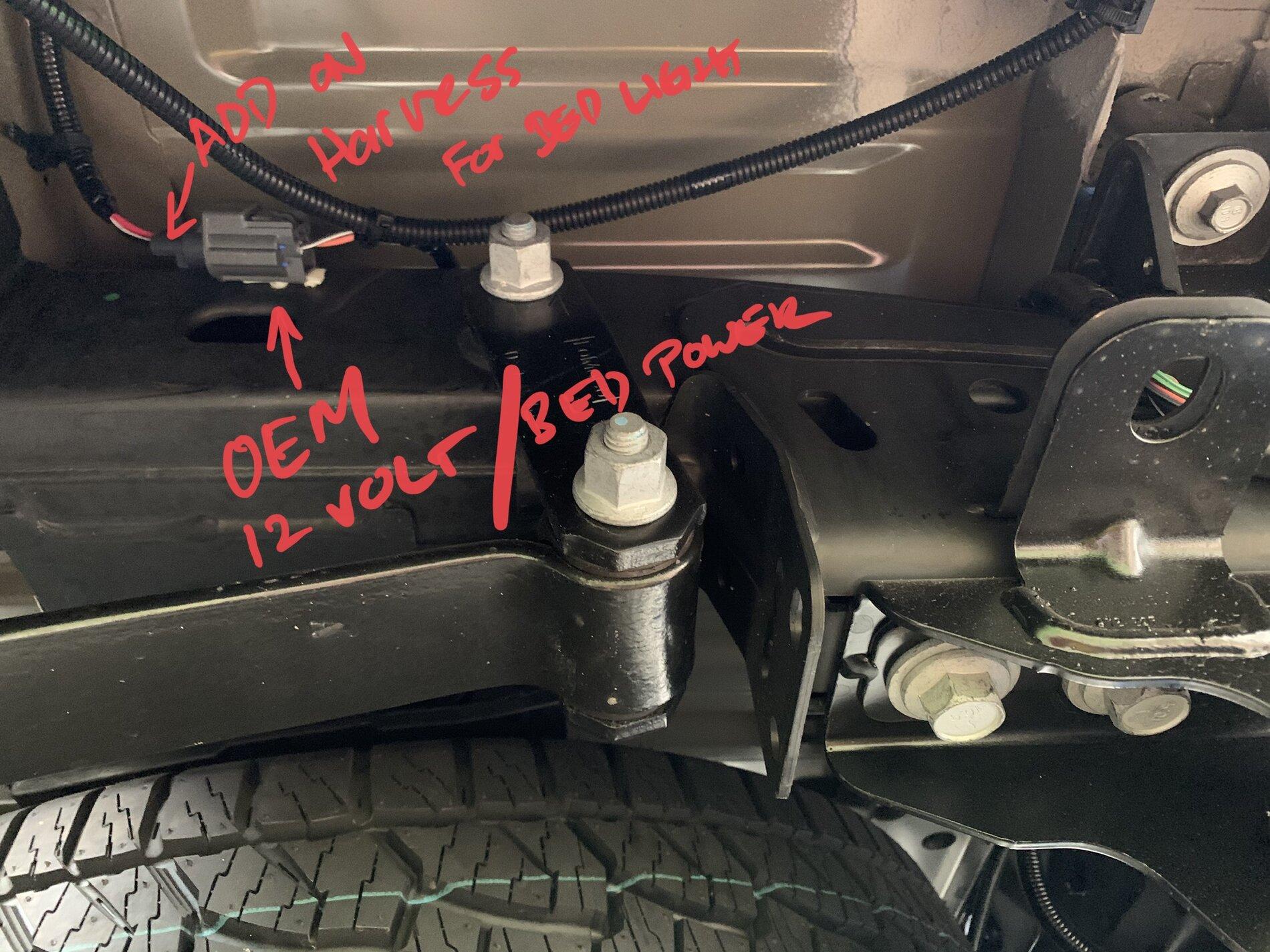

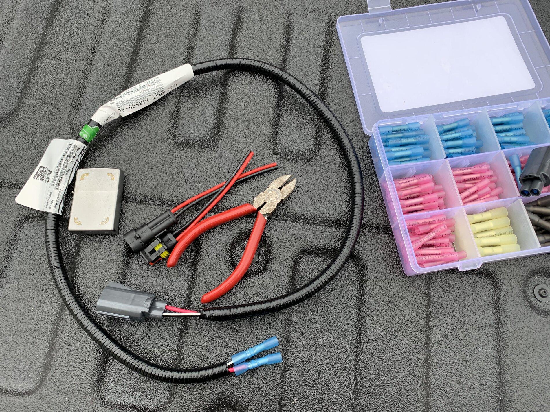

Added bed led light today.
The ones I got were a bit long, so had to make it like an “ L ” shape
to fit the sides. I also left some space in the rear for my hard cover pull tabs.
For power I just tapped into the existing oem power harness, right under the frame rail by bed on drivers side.
(This is the exsiting oem accessory plug if you order your Ranger with the utility power plug in the bed. If not, the plug is still there, but you have to get the harness to make it work. ( or splice it ) Lots of write ups already about this in the forum. :)
For the 2x4 cargo divider, I added a couple of plastic handles just to make it easier to remove/ replace.
So heres some more pics, now with the bed light.

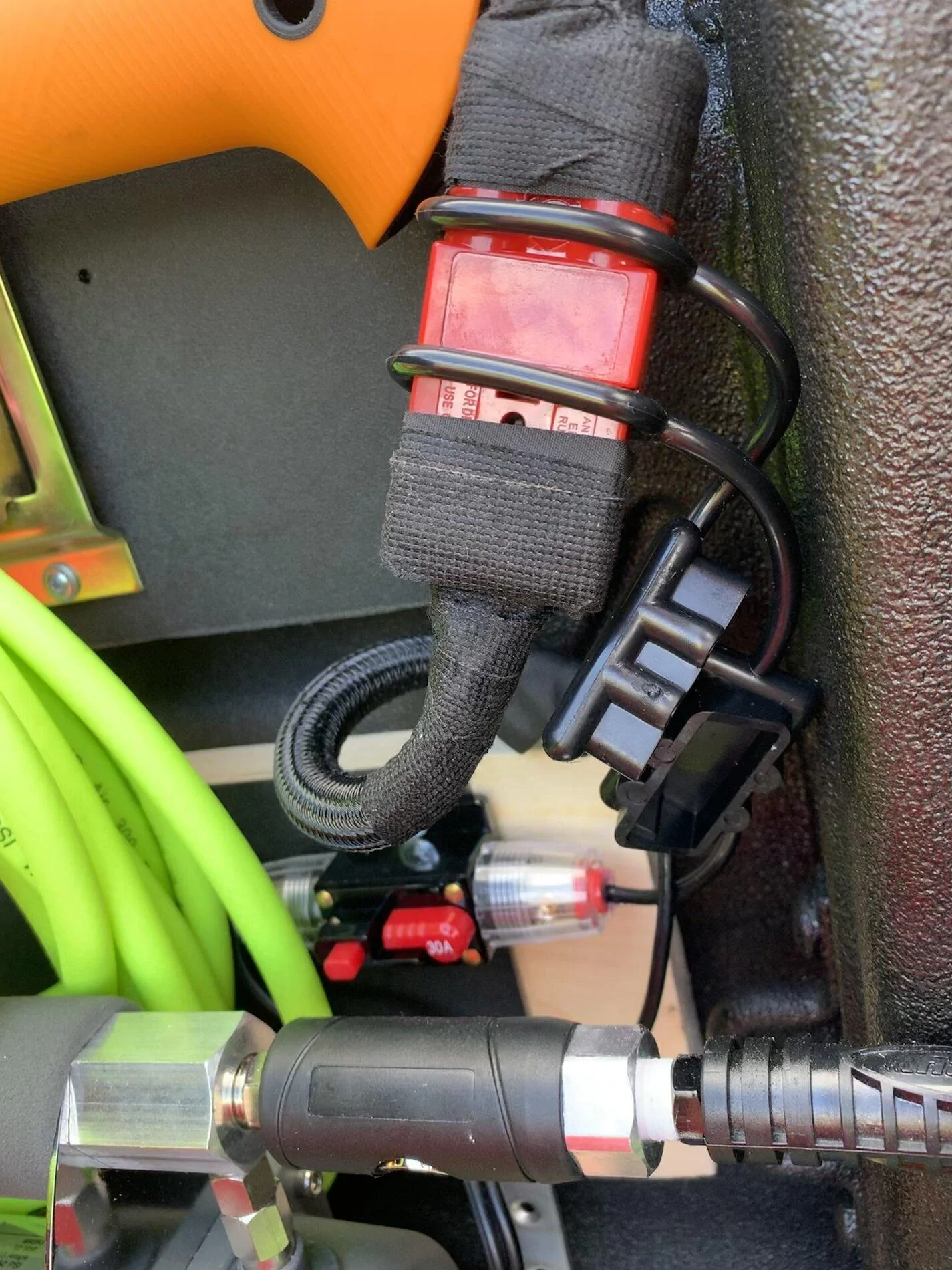

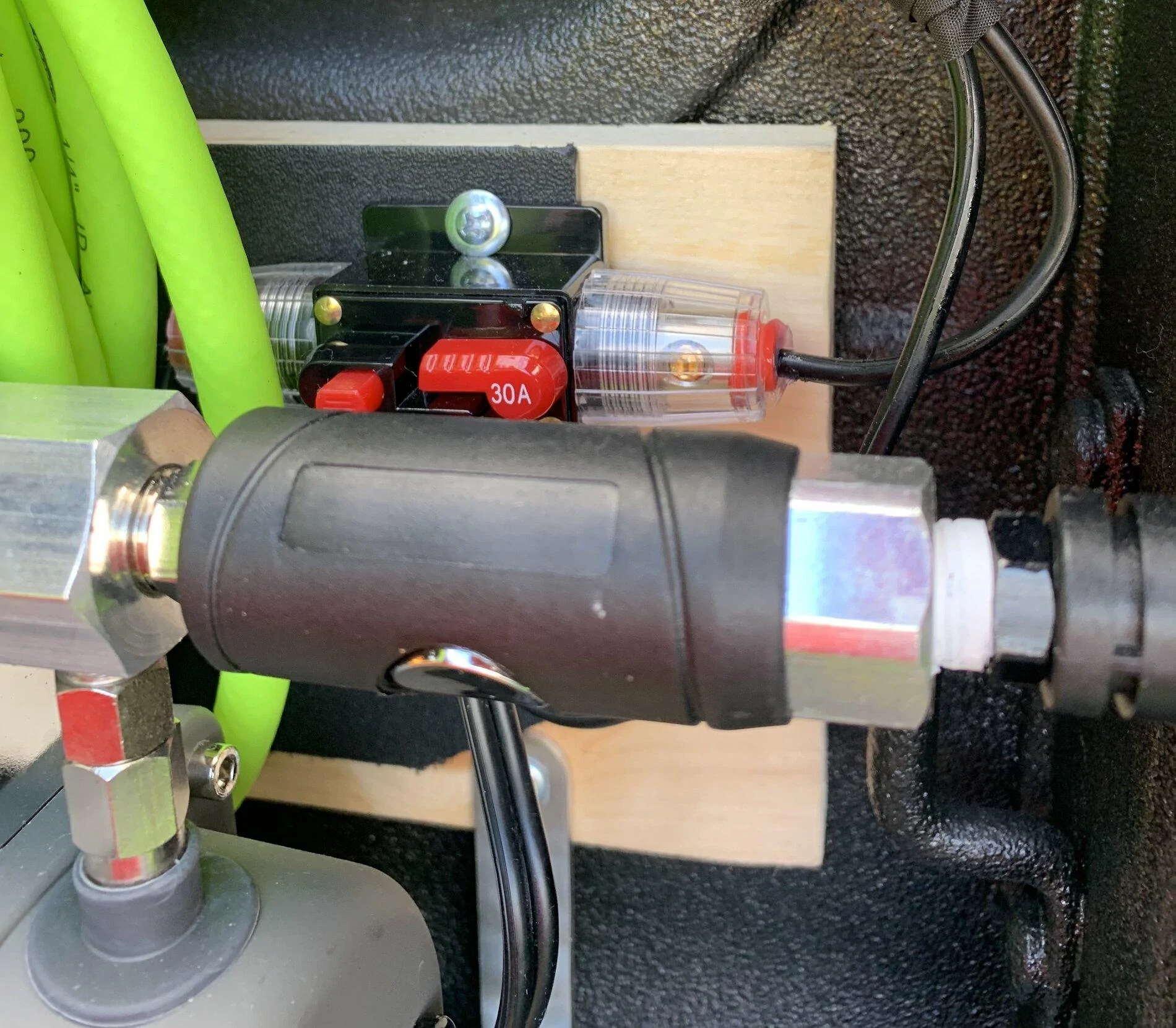

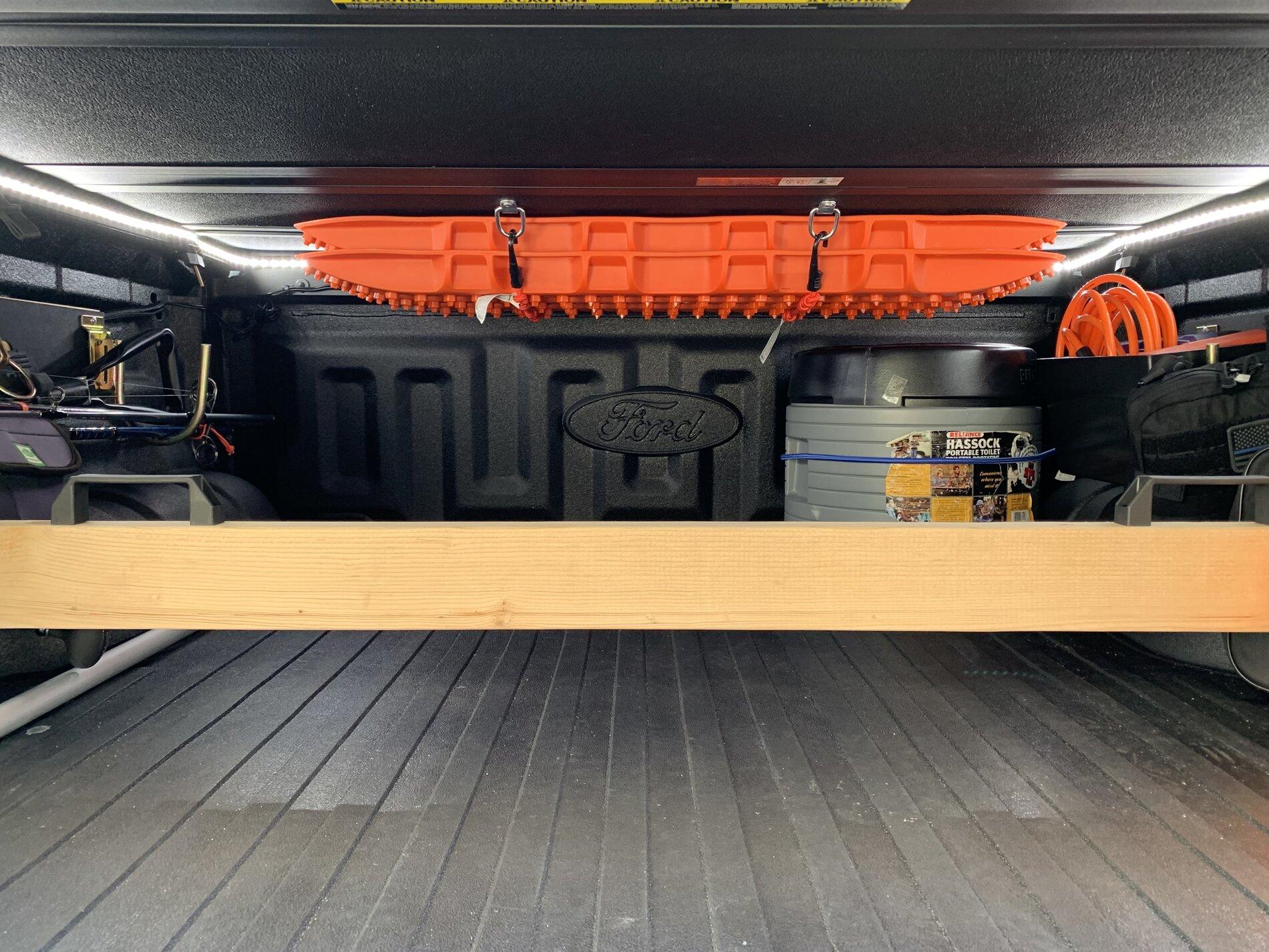

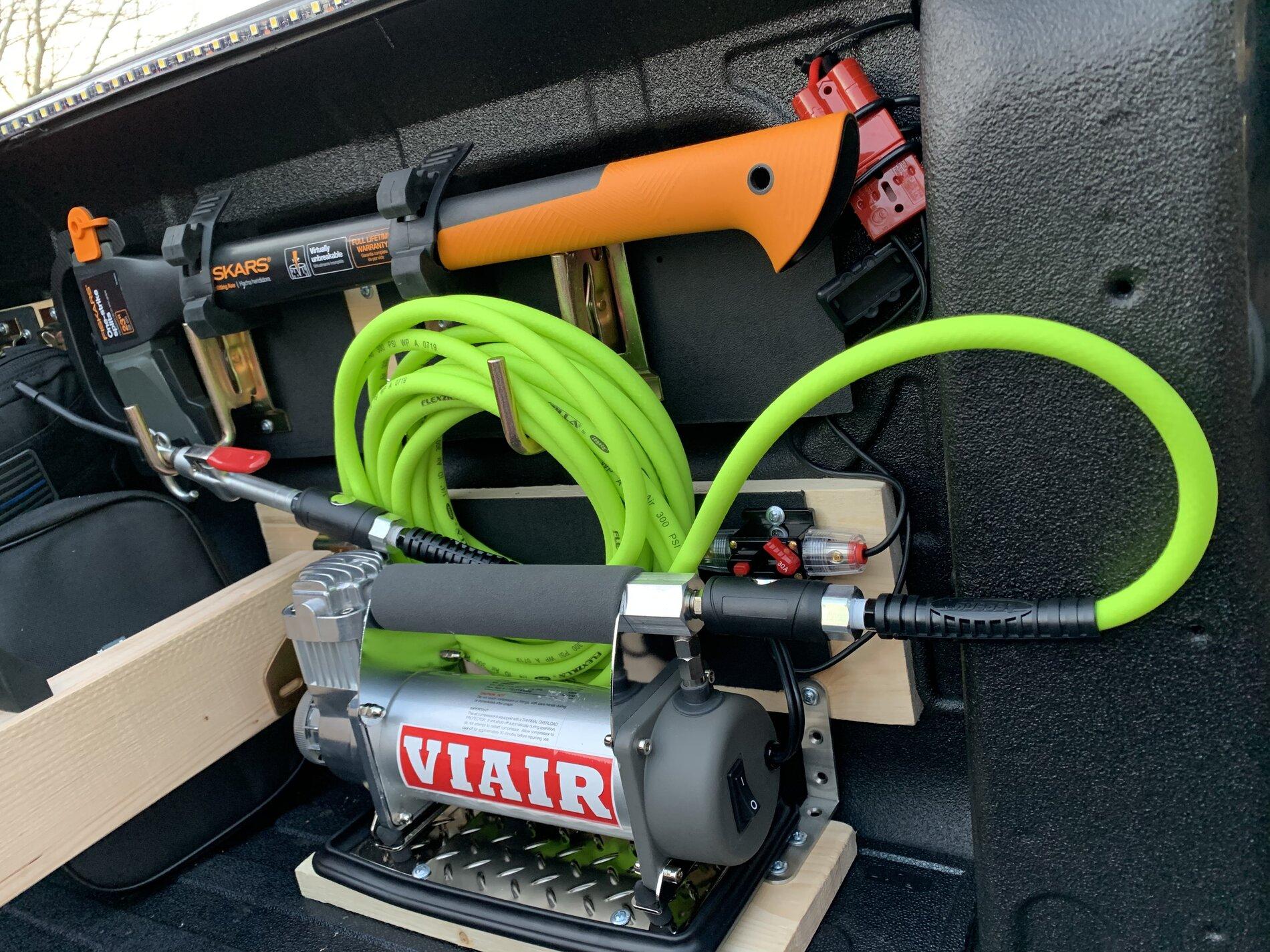

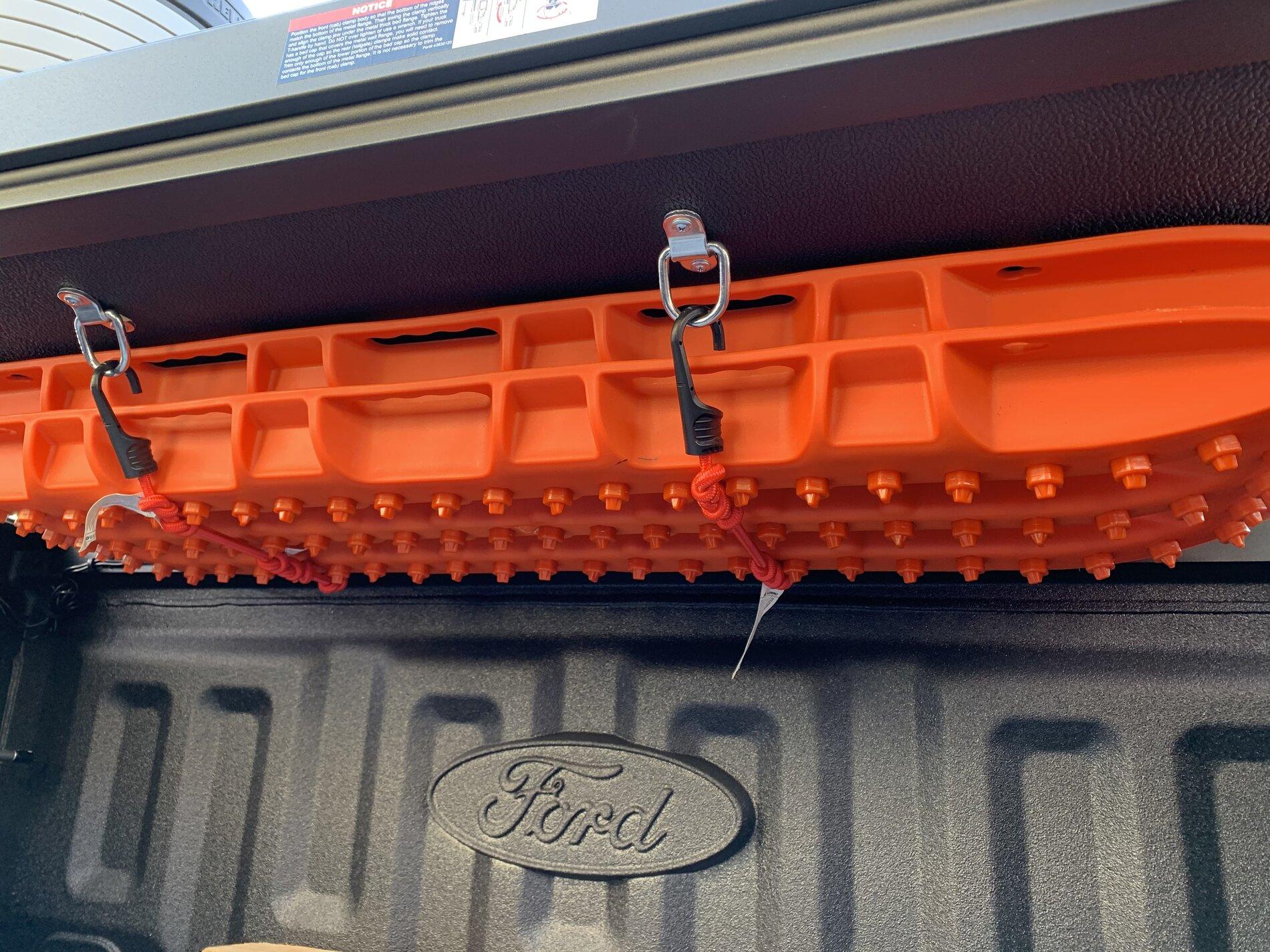

Just an Update:
The panels are still holding up well.
Added my Viair 450 as onboard air, hooked up to a quick connect and 30 amp breaker.
Also, since I have a hard cover (Extang 2.0)
I decided to install some swivel tie-downs:
https://www.amazon.com/gp/product/B075QZTYTY/ref=ppx_yo_dt_b_search_asin_title?ie=UTF8&psc=1
To hold the pair of Recovery traction boards inside, high up
and out of the way.
(attached to the first, non folding panel of the bed cover).
