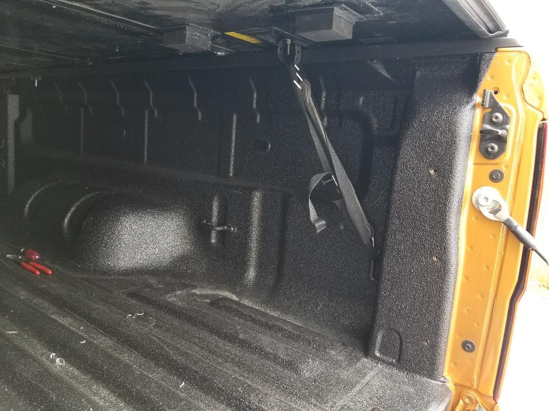

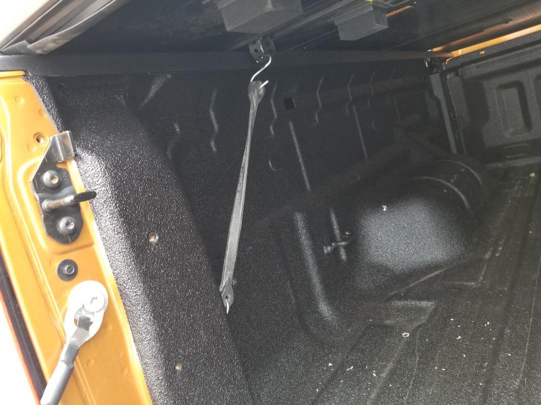

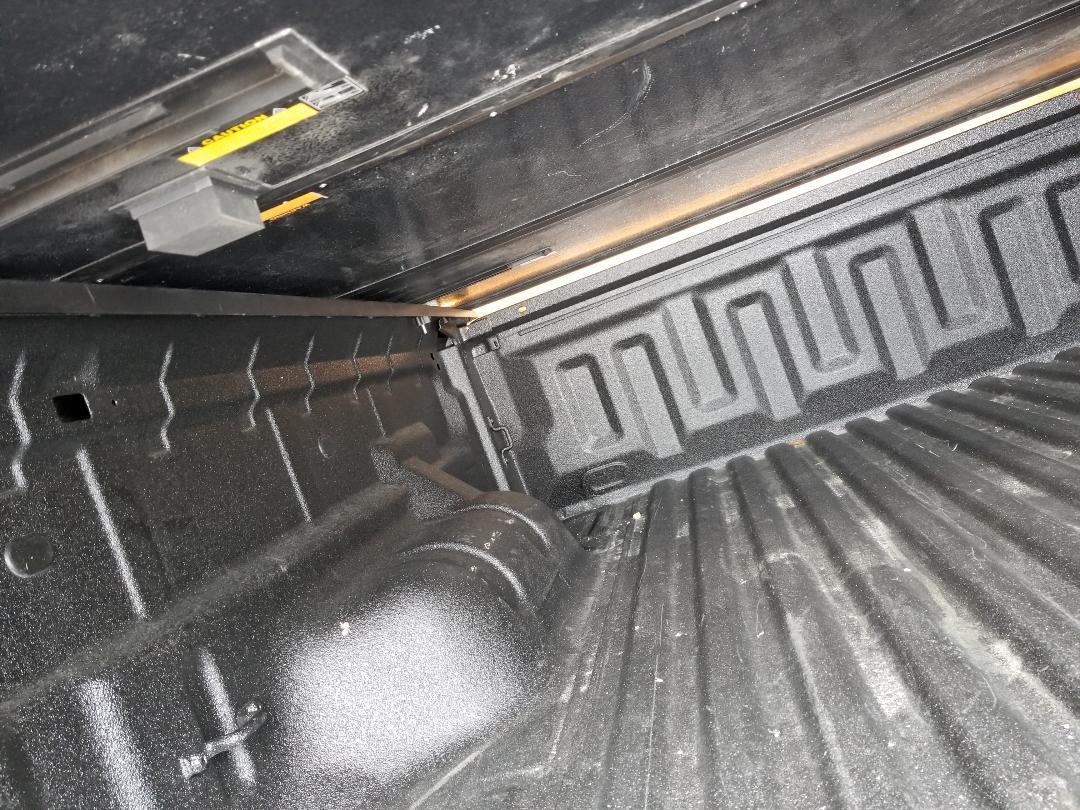

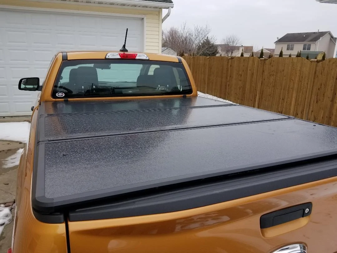

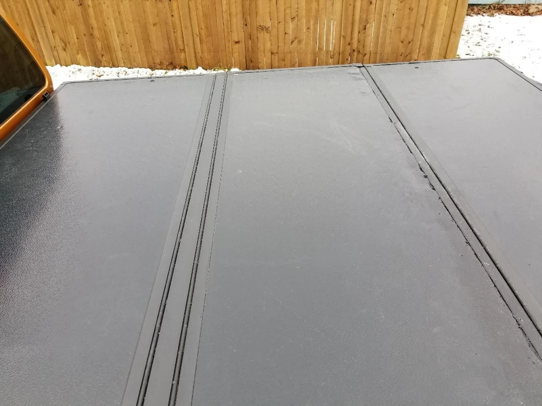

I found a discarded flip type cover from a fullsized truck with damage along one hinge face and no mounting hardware,
I plan to disassemble it and resize it to fit my Ranger, then devise a pair of clamps and a striker for the latch.
I'll post here if I find the ambition to do it!:like:
Update...
Spent 6 dollars and probably about 6 hours to convert the bed cover.
Got it done today, looks and works great.
Thank you, DIYAndy for the inspiration.
Pictures tomorrow if I find the time.
Floyd
Jan 6, 2019
2,064
3,132
illinois
Well , here's the pictures of the box cover.
It was badly damaged, especially on the first hinge from the back.
The hardware was either destroyed or missing.
It was off an SOB fullsized truck (Chevy?)
I had to cut it 8" narrower and mke my own attachment points.
I will be installing a funnoodle or waterpipe insulation to seal the front edge of the box.
The entire cover is removable with only two hand nuts on the front panel after unhooking the rear straps and folding the cover.
not too bad for six bucks!:clap::giggle:
