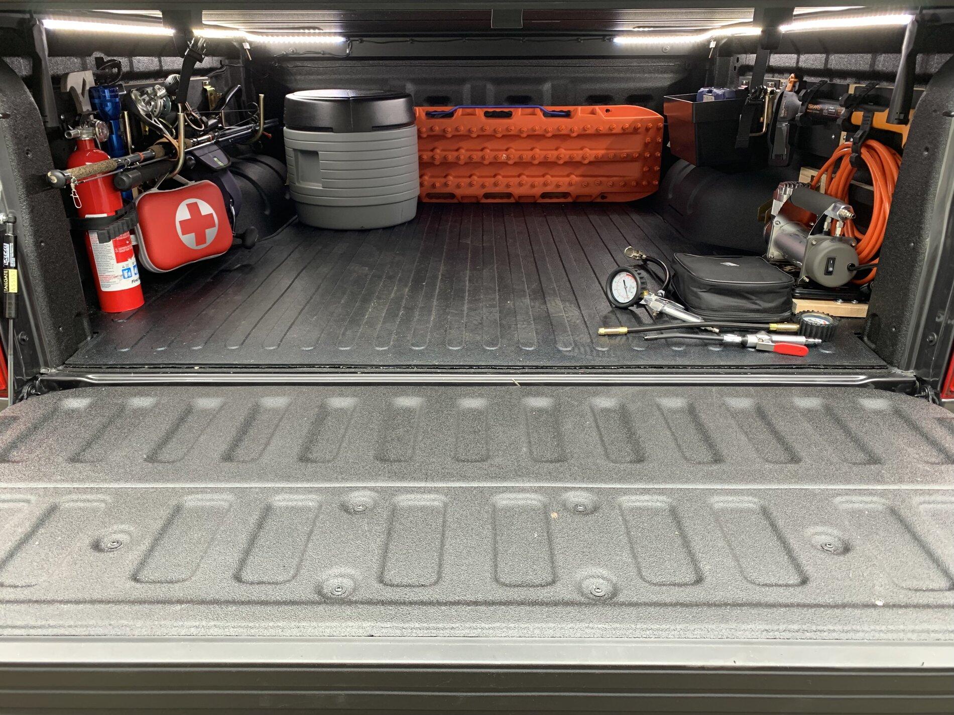

Nice! How did the whole install turn out? Are you happy with how bright the lights are etc?
Very happy with the install. The lights are bright enough - I wired them into the taillight wires, that way if I forget to turn them off, they will go off on their own.

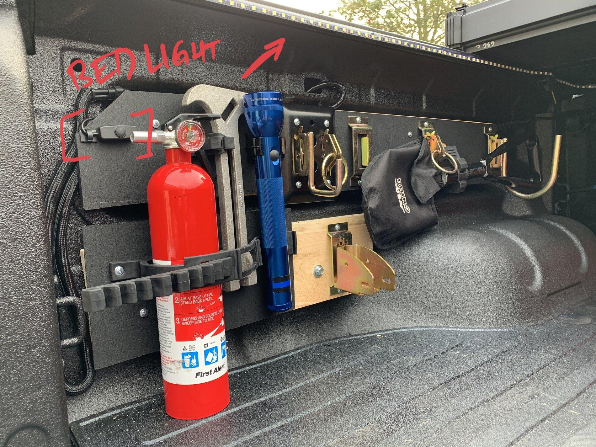

I bought the led light strips from Amazon
similar to these:
https://www.amazon.com/MICTUNING-Wa...RQ2HVZD9RPB&psc=1&refRID=YGVK2EE7XRQ2HVZD9RPB
They’re around $22, but I have seen them go for as low as $19.95 on prime.

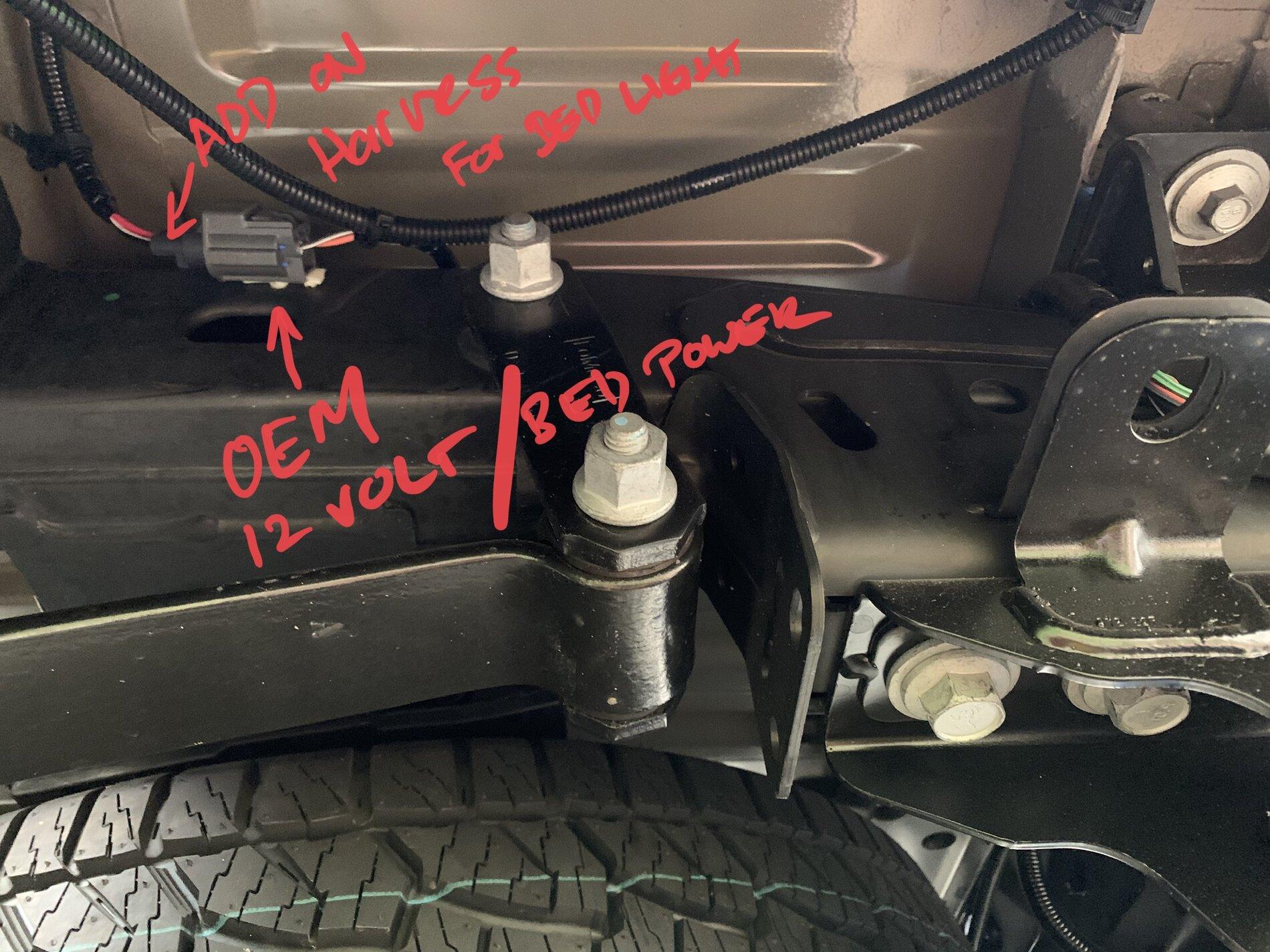

For power, I just tapped into the 12v+ under the d/s bed rail.
This Bed utility plug circuit is ON when key is in ACC (accessory).
Also stays on for awhile shortly after powering off your Ranger.
Tip: Clean the area well with alcohol prep pads first, then let it dry before installing the 3M backed, led strips.
