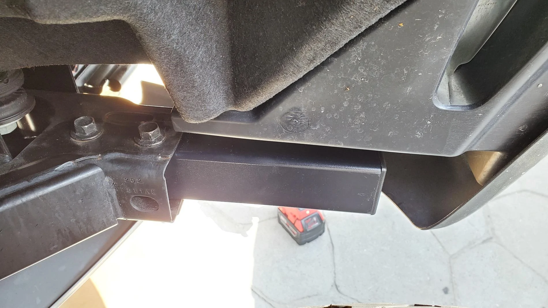

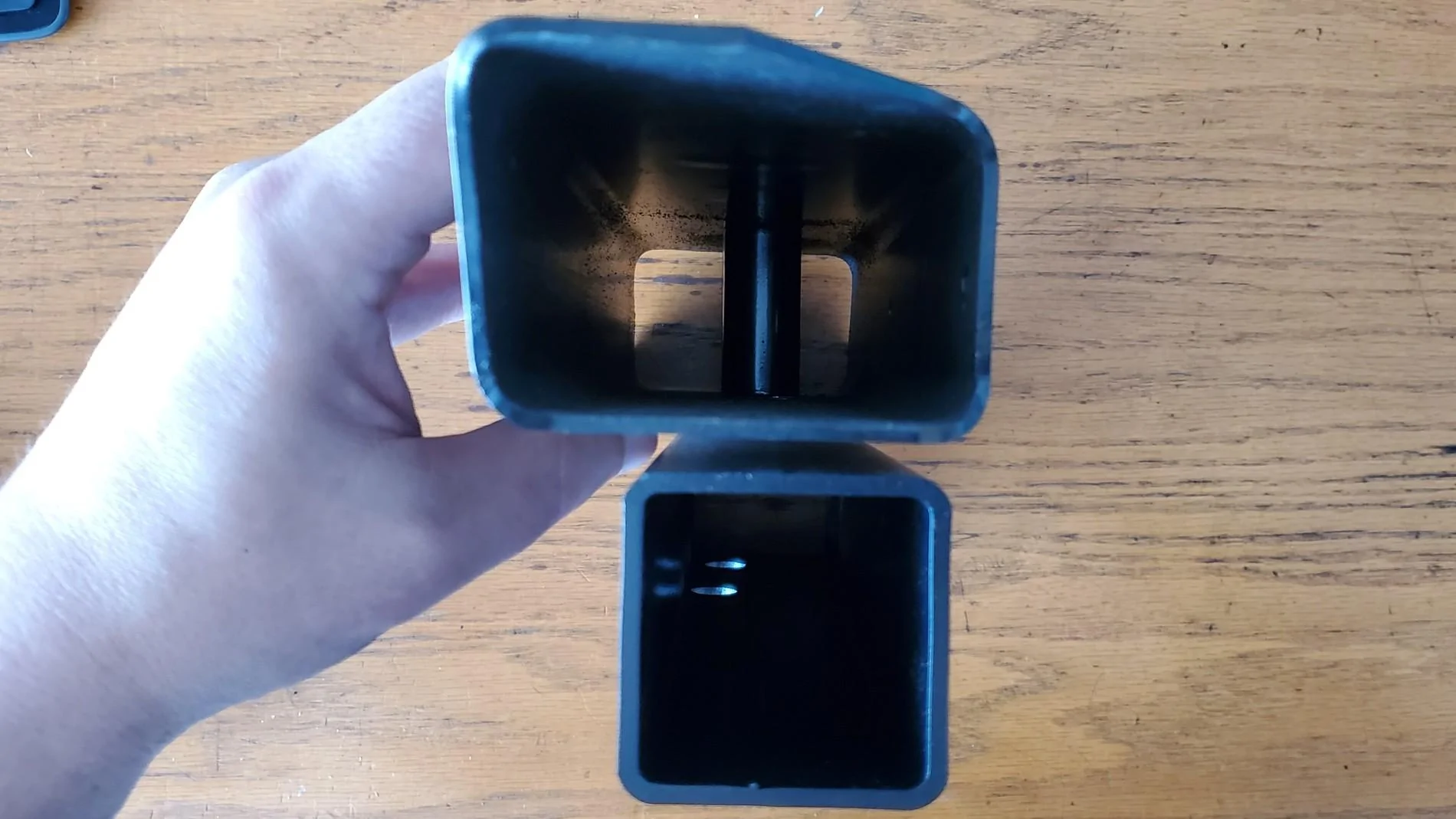

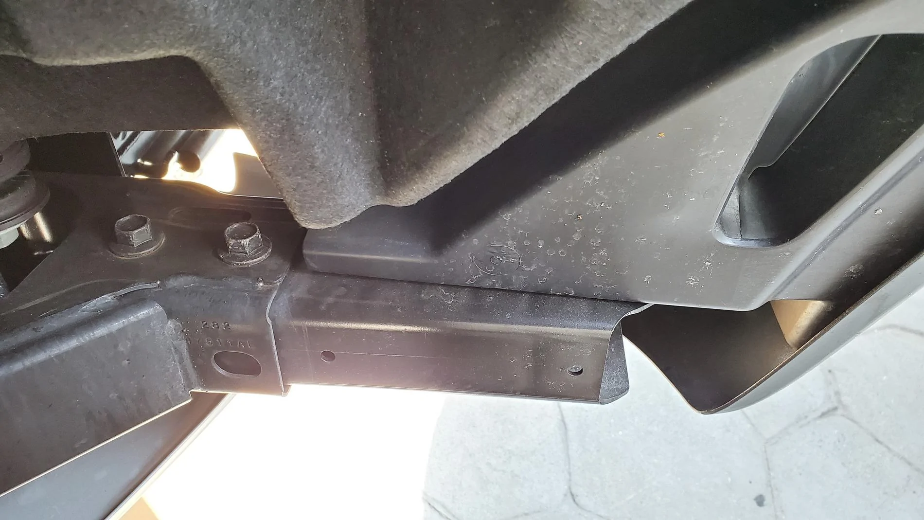

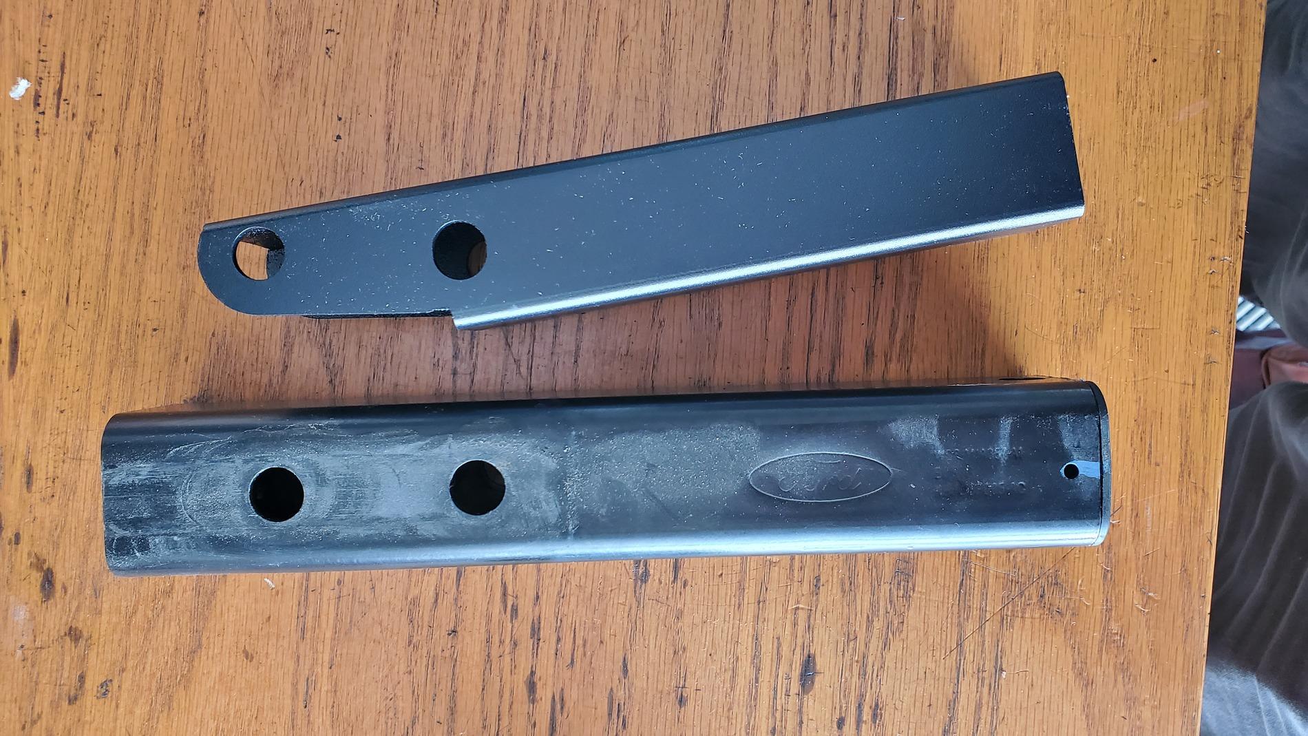

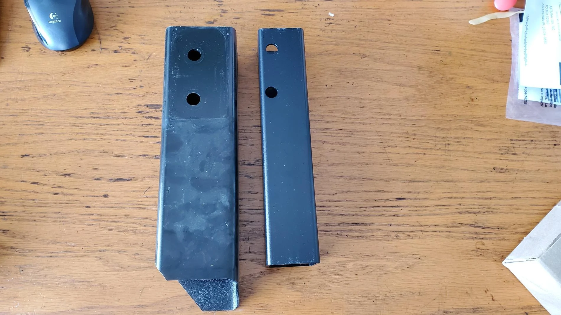

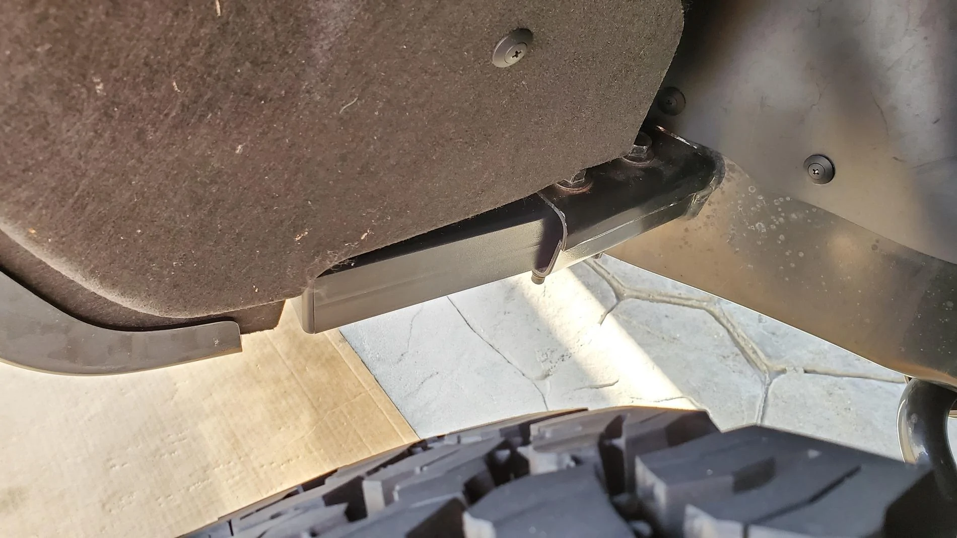

I got my BDS Intrusion Beams installed today, not too bad of a job and you really don't have to follow their instructions to a T. I didn't remove the front bumper completely, just loosened the frame bolts all the way out, then took the 3 off from the side I was working on, pulled the bumper forward enough to slide the front intrusion beams out and slid the bumper back on. For the rear, I popped the 3 rearward fender trim clips off (broke one on the driver side and then realized I can reach my hand in from the inside and push the clips out so they don't break), then removed the two push pins holding the fender liner on and was able to get the bolts for the inner plastic support from there. I also removed the two lower fender bolts which gave me just enough room to push it back and slide the rear intrusion beams out. It was a few more steps than just chopping the stock ones off but it wasn't terrible. Here's some before and afters for the front and just an after for the rear (I forgot a before pic :( ).
Front Stock Intrusion Beam
Front BDS Intrusion Beam
Stock Front vs BDS Front
Stock Front vs BDS Front Thickness
Rear BDS Intrusion Beam
Stock Rear vs BDS Rear

Were your tires running on the factory ones or did you just change them to make sure there was extra clearance?
Yep, they were rubbing on both the front and rear driver's side in reverse at full lock. Not anymore! :like:
