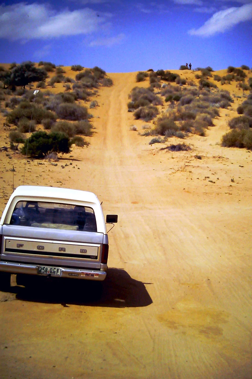

Mind you in some parts of Australia THIS is considered a "designated road" (Pic is one of the 1,100 dune crossings on the French track across the Simpson desert) And yep that was my faithful old Bronco. Even here you have to be careful as although it's sand, Mulga bushes and trees grow by the side of the track and drop branches. Because they only grow about 1" every hundred years the timber is as tough and as hard as steel. A Mulga splinter will go right through a tyre if you are unlucky.
Bulldozed by local contractors back in 1962/3 on behalf of joint venture between French Petroleum and SANTOS ( Australian oil and gas company) to conduct seismic surveys and drill test holes for oil and gas.
Now used by 4x4 enthusiasts as a fun and challenging trip. An average crossing takes about four days. It can be done in less, but you risk breaking your vehicle, and that's something you really don't want to do out there, as there is absolutely nothing in the 400 odd km wide crossing. Help can only come from Birdsville in the east or Mt Dare in the west.

That was a big truck by Aussie standards. I was in Sydney in 1989 and it was cool to see all the small Toyotas, Datsuns, Holdens, Fords and such - there were no “big” cars like at home. The Japanese cars were the same as the ones we had back in Canada except instead of model names, they had model numbers, 120i or something along those lines. After a week or so, I got used to the size of the cars and they all started to seem normal until I saw a parked Ford Bronco taking up more than its fair share of the road in Woolloomooloo. It looked absolutely massive next the rest of the vehicles on the street. And it was right hand steer.
Your mates must have been envious of that beast.

Yep Ford Australia built RHD Bronco's and F100's up until about 1990 from converted Canadian knock down kits, but then stopped. Later they built RHD Explorers from about 1999 until 2006 and then stopped again.
Ha Ha I loved that car, it was an 81 model, I bought it second hand in 86, with about 80,000 Km on it and when I sold it to a friend from the Jeep club I was in it had ~500,000 Km. It still had a perfect body and he was going to swap it onto newer one that had a perfect driveline but got rolled.
It came with a Dana 44 track lock in the front diff, and a Ford 9" slippery in the rear from the factory- it would go anywhere, and despite it's weight was a fantastic sand runner.
The gear box, transfer case and power train were still good, although in that 15 odd years I owned it, I went through I think from memory about 5 sets of tyres, two clutches (never wore them out, kept breaking the diaphragm springs because it was a daily driver in city traffic), one set of uni joints, (got water in them on the Cape York trip) one brake line (vibration crack from the Simpson trip) 1 side window (attempted theft) two sets of brake shoes, and 1 set of rings in the engine at about 350,00
My friends used to joking call it Cam's mobile lounge room.
