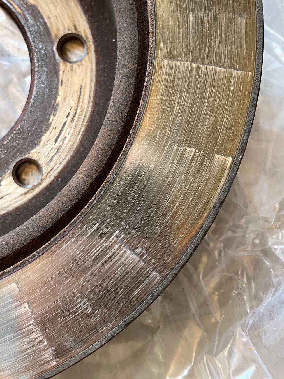

My rear rotors were terrible. Same symptoms.
Thanks. My first thought was warped rear rotors which is weird because on previous vehicles it was usually the front brakes that were issue, not the rears.
25k miles. Pads were fine. Reused them.
