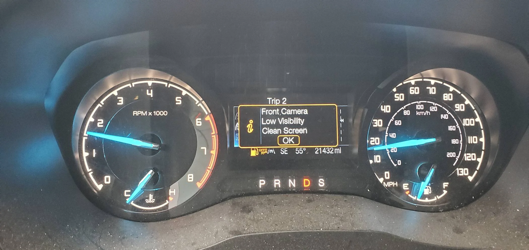

It could also be a bug, dew, rain, leaf, maple tree helicopter, cat paw print, any obstruction on the glass, this is probably 95 percent or more causing the fault, had same issue, took it into ford they cleaned my cats paw prints off the glass and poof issue solved...

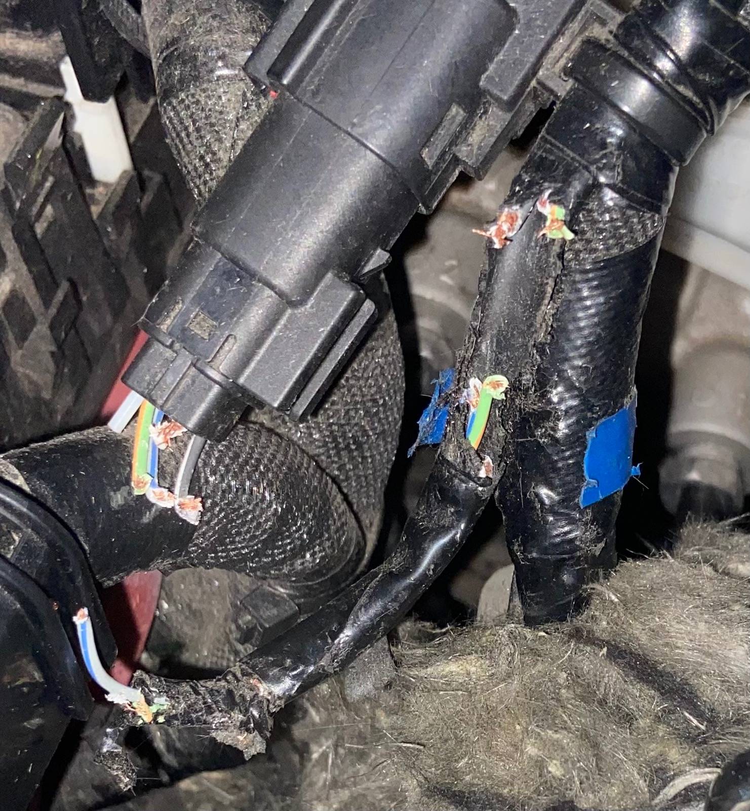

Imagine how silly I would have felt if I contacted the NHTSA to open a complaint and then found out that mice did this…
I dunno.... I think making critical parts of a vehicle out of mouse food should qualify as a safety issue.

the "camera" doesn't give us images but it is the lens in the black area of your windshield by the rear view mirror. the camera is there for the crash assist stuff, but we cant access the images.

I think of it more like a sensor, I don't think it captures what a real camera sees. And in my XL, it only does AEB stuff, no lane assist or sign reading.
Although, had I known the arm-atrophy action of the rear damper, lane assist would have been helpful!
