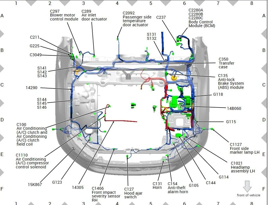

Operation:
SCCM - Steering Colum Control Module - Monitors (Switch) position (Turn Signal, Hi-Beam, Flash to Pass)
Sends MSG via HS-Can2 to the GWM (Gateway Module)
GWM sends request over HS-Can1 to the BCM
The BCM provides the (On/Off) voltage for the Turn Signal (Integrated Flasher)
So, it could be a delay from the Can-Bus, Bad switch, bad SCCM or BCM
Does it do the same if you cycle the Hazzard Switch?
This provides a separate way of activation
Does it do the same delay (when you select high-beams or flash to pass)?
If you have the same delay, then it is a possible switch issue.
One common for both sides (Left/Right) is the Ground Point for the lights themselves, I would check this for a good ground and security.
G-123
